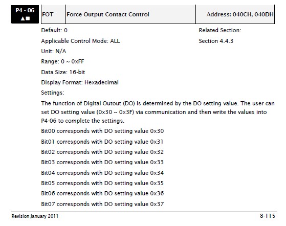

Also you have to program on each drive the following:
P2-18 -> 0x0130
P2-19 -> 0x0131
P2-20 -> 0x0132
P2-21 -> 0x0133
P2-22 -> 0x0134
P4-06 -> 0x0000
Or use the attached parameter file if you have the asda-soft.

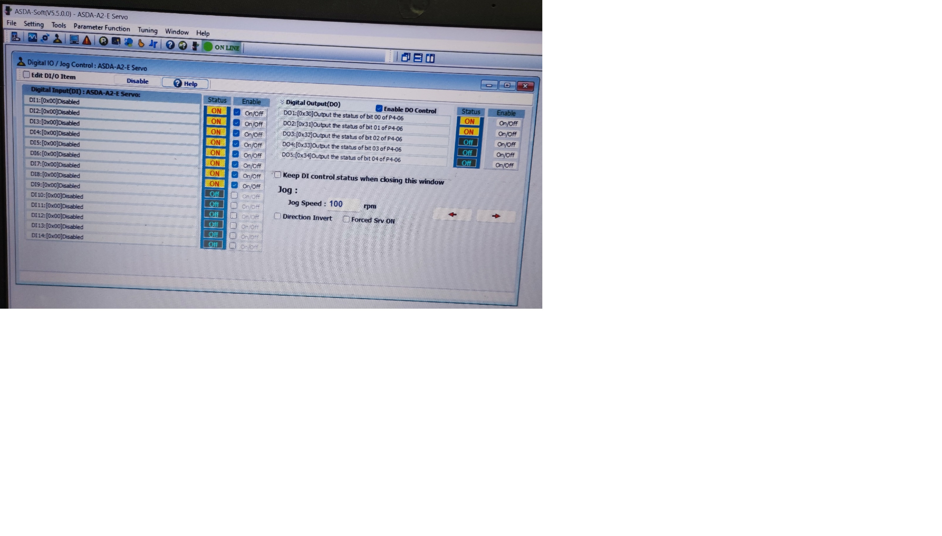

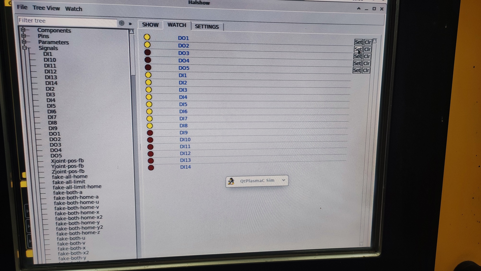

Replied by Mr. Mass on topic asd-a2-e ... lcec driver?
Thanks for the explanation, the outputs are working with these settings. I was surprised that there are hidden parameters for the outputs. I didn't see them in any manual, or in asda soft either. But the inputs are still not working. Maybe there are hidden settings for the inputs too? Or am I missing something else?

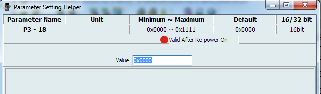

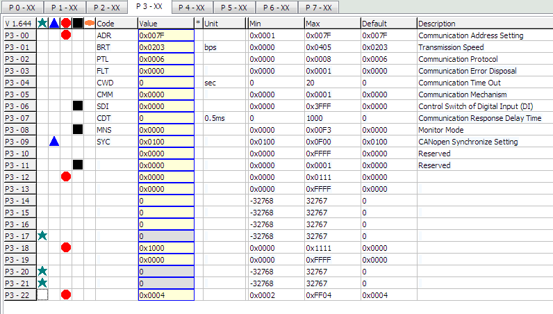

Of course, the first thing I did was upload your *.par file to the servo. But there was a problem: the firmware versions didn't match. Your file was 01.645, and my drive was 01.644. ASDA software did the conversion, but the DI didn't work.
I found a solution: parameter P3-18 must be set to 0x1000, then the inputs start working from linuxcnc. This works for me, perhaps this will also help someone with the problem of non-functioning DI.

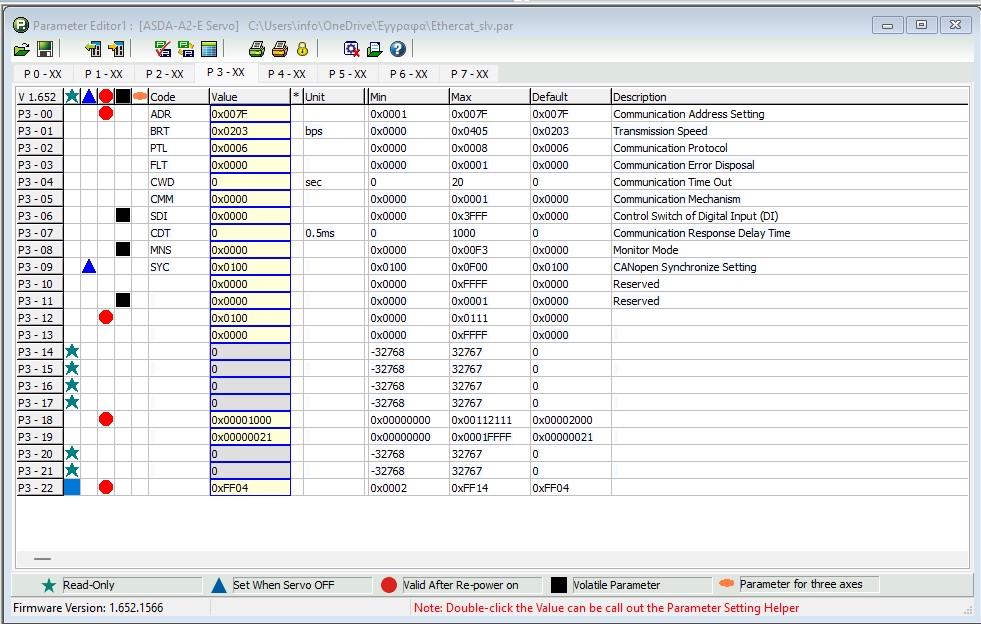

Replied by cncfreak on topic asd-a2-e ... lcec driver?
Strange because in the attached parameter file the P3-18 is also set to 0x1000h.
I'm using the latest ASDAsoft v5.5.0.0, could this be the case? Otherwise its the servos firmware as you mention.
I also use version 5.5, it seems to be a firmware issue.
