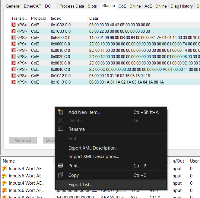

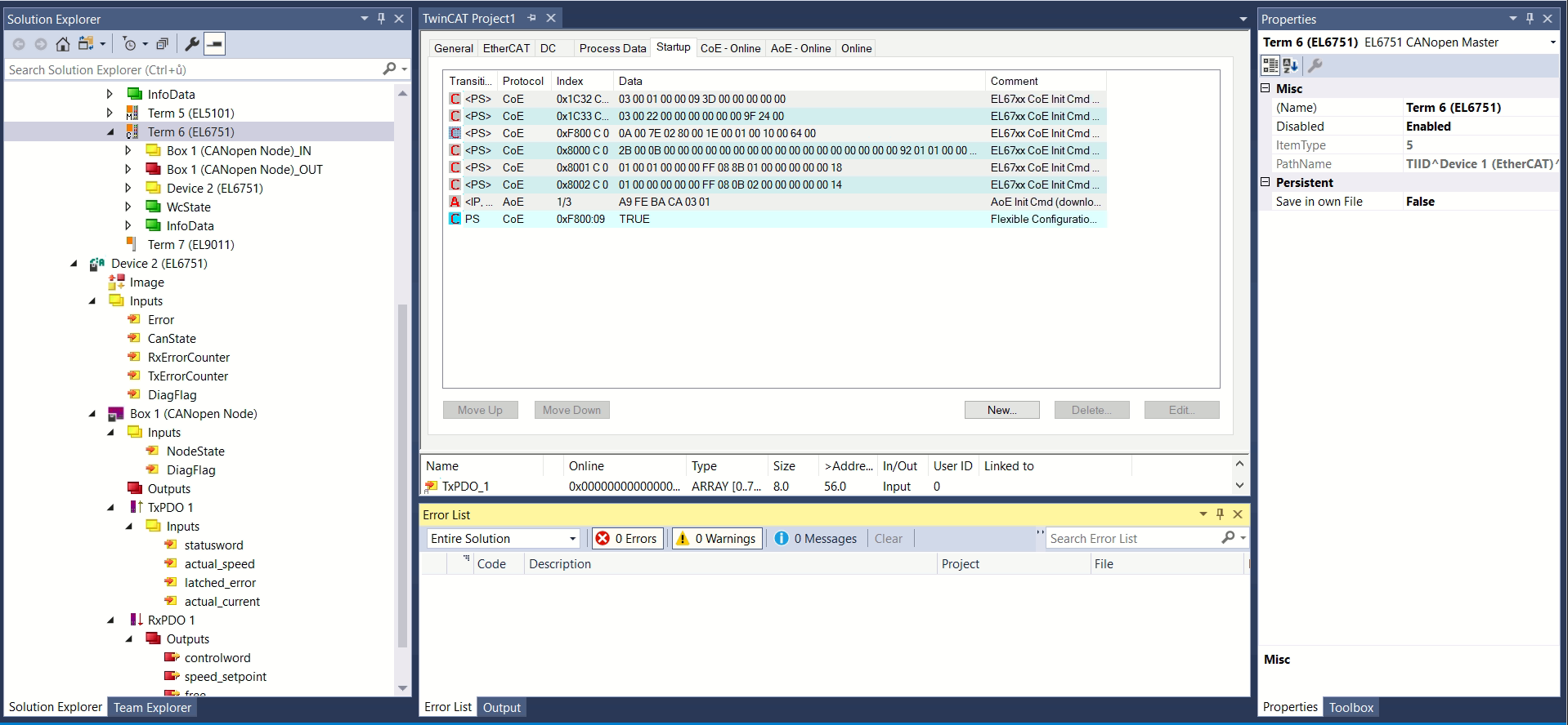

After a long break, I am trying to get the EL6751 up and running. However, I am already failing to get the terminal into the Run status without a bus error.
I have currently tried to configure the terminal with Twincat (the terminal is running in Twincat).
Saving the configuration in the terminal and starting lcnc without initcmds leads to status OP but BusOff. Mapping the first PDO (1600) EL6751 is stuck in Preop.
Starting with exported initcmds lead to the status Preop. It seems that the SDO download is not possible for reasons unknown to me.
Does anyone have an idea how I can solve this problem?

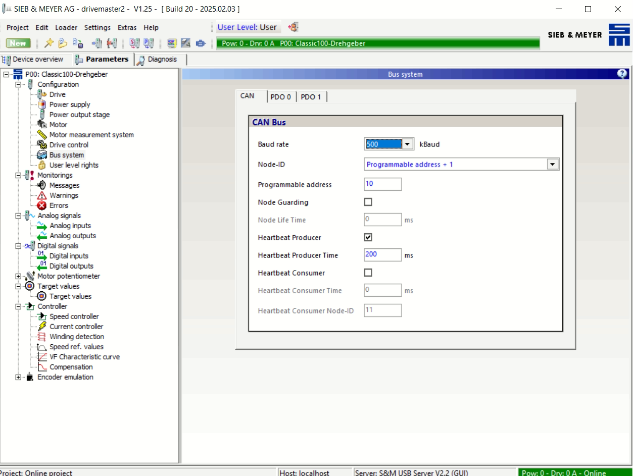

06 Jan 2025 14:41 #318230
by mic
Replied by mic on topic Ethercat, EL6751 and CANOpen

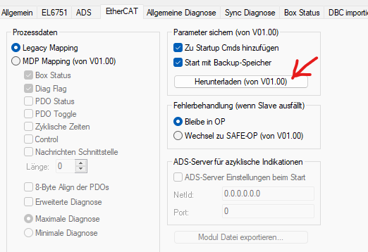

I made some progress since yesterday but currently it is not working.
I thought the button in the screenshot does this but after power up the unit has a totaly different konfiguration.
Thanks you in advance.
- countless tries editing the initcmd file to get EL6751 up and running did not succeed i ended up with dmesg output "invalid input configuration" but i have no idea how to debug/fix the wrong config (Preop).
- switching the ethernet cable on the fly from twincat to lcnc lead to OP-State (only PDOs are configured in lcnc, no initcmds or SDOs).
- with "ethercat pdos" i can see the list of PDO entrys configured in twincat.
- but some parameters like baudrate are set to 500 kbit/s instead of 1Mbit/s
- changing only the baudrate parameter with initcmds sends EL6751 to Preop.

06 Jan 2025 15:35 - 06 Jan 2025 15:45 #318235
by endian
Replied by endian on topic Ethercat, EL6751 and CANOpen

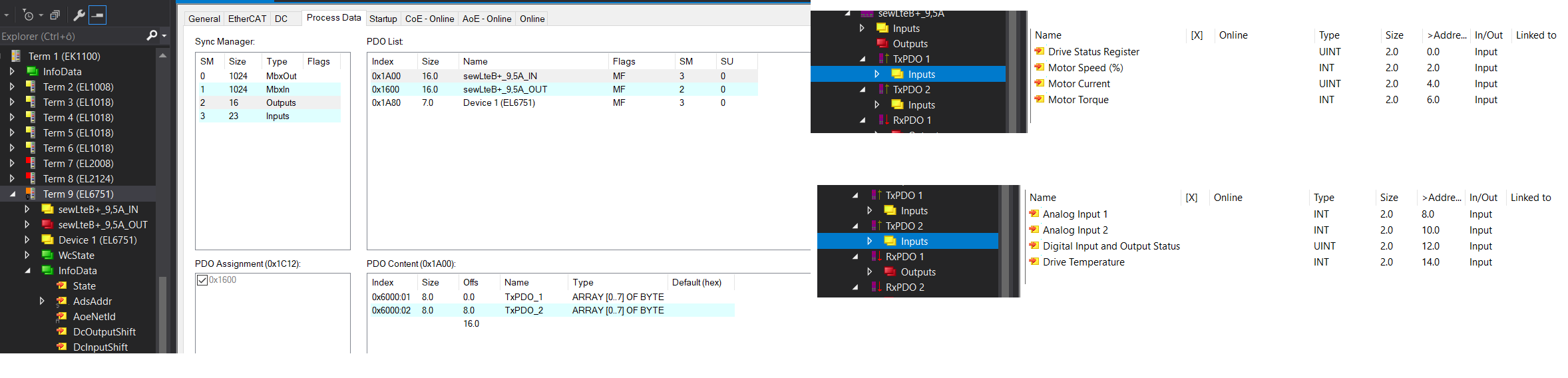

I did everything in the twincat 3 from the beginning... All stuff have to be visible and workable via local PDO setup... then I active configuration on the local PC with right scan time... for us should be a 1ms which U have to define in the PLC tasks...then rebuild them and active configuration but you have to upload PDOs configuration in the Process datas section... if is everything green means OK and you should disconnect it from the Twincat3 PC and plug it to the debian ethercat master rj45 socket.... then command
and you have to see active configuration in the EL6751 master ...
take care about the shape of the PDOs because they are different from the shape of twinCAT3 PDO configuration then you have to export startup in the Startup section .. export them to excel as .csv and then copy paste it in to the ethercat-conf.xml file with "complete" config definition just copy paste them in front of SM managers and if you have luck and no syntax issues you made everything should work from first shot... I do not experiment with different setup and legacy setup, it is there because of very old stuff which should use little bit different shape of communication datas or protocol..check files in the attachements for a hint
if nothing helps you should run commandwhich will create you a working PDOs config of your acual stuff in the el6xxx master
I will check your file tomorrow because I am currently busy with my configuration too..
regards...
ethercat pdosand you have to see active configuration in the EL6751 master ...
lcec_configgenI will check your file tomorrow because I am currently busy with my configuration too..
regards...
Last edit: 06 Jan 2025 15:45 by endian. Reason: FORGOR THE CONFIG

06 Jan 2025 17:25 #318242
by mic
That´s the best instruction i´ve seen so far!
following your steps:
- Configuring everything in twincat and make it OP
- Switching to lcnc running "ethercat pdos" and map everything
- exporting SDOs
-> everything works - thank you so much, i´ll share my config when it´s finished!

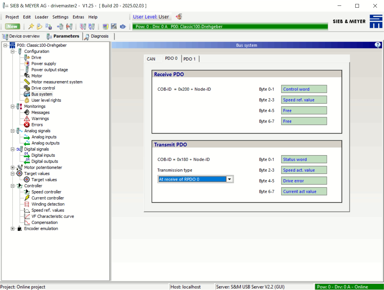

- Marko6
- Posts: 8
07 Oct 2025 17:00 #336034
by Marko6
Replied by Marko6 on topic Ethercat, EL6751 and CANOpen

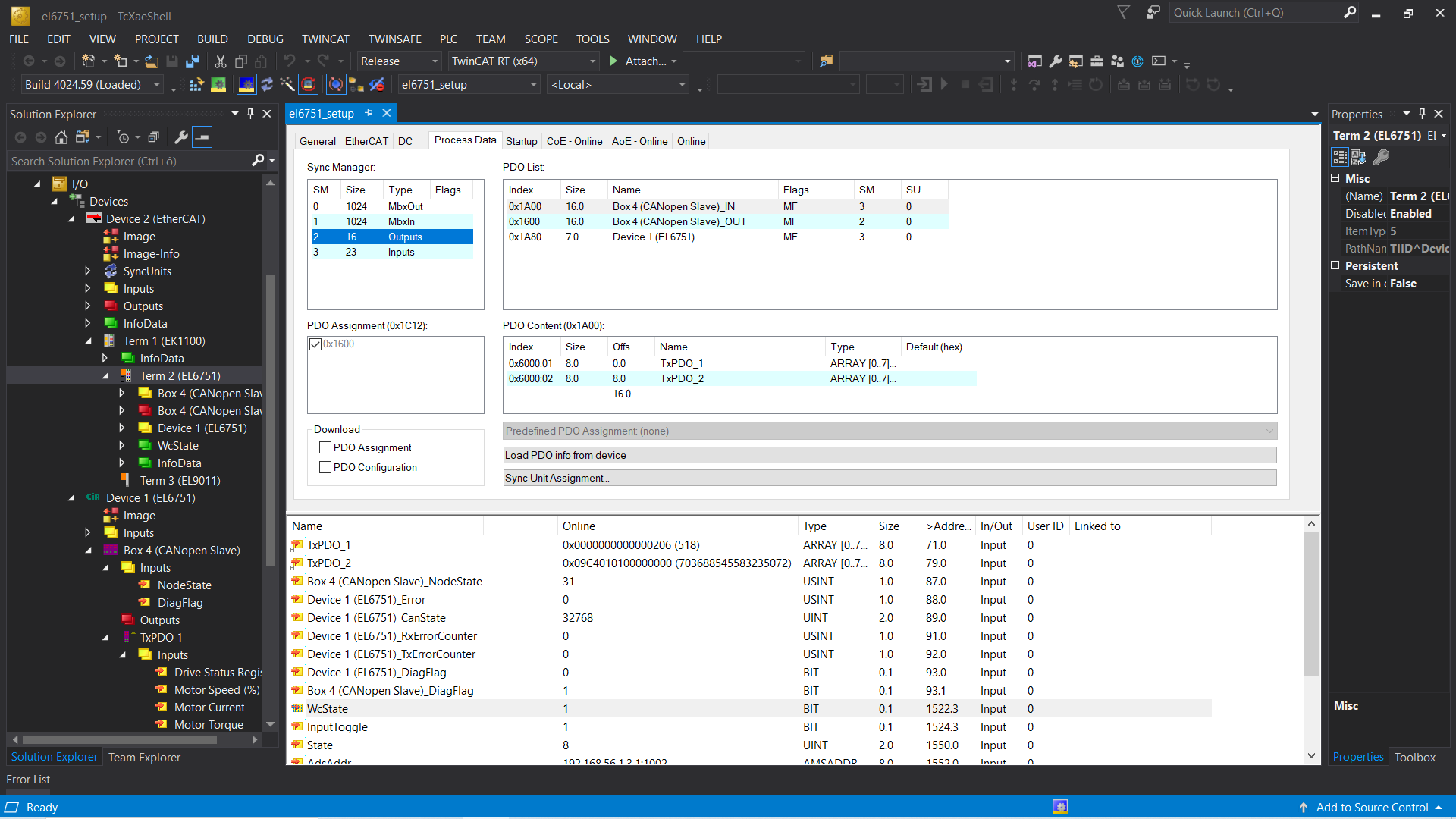

Greetings from the Czech Republic!
I'm working on a spindle (IMT 40kRPM) and the drive only has CAN, so I decided to use the EL6751, because everything else on my machine is on Ethercat. That's the problem.
There is a possibility that the CAN is running from TwinCAT and I can spin motor, etc. If I then connect the EK1100 to the LinuxCNC network, both cards start up (OP), but the CAN is red (flashing in the attached configuration, otherwise still red). Any idea what's wrong with that? Did I miss something?
Thank you. Best regards,
Pavel.
Pavel.

07 Oct 2025 20:28 - 07 Oct 2025 20:31 #336052
by endian

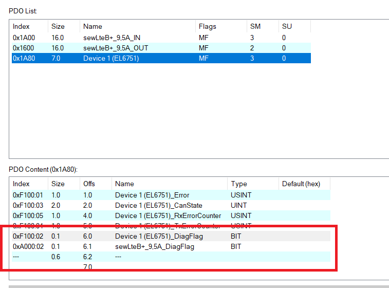

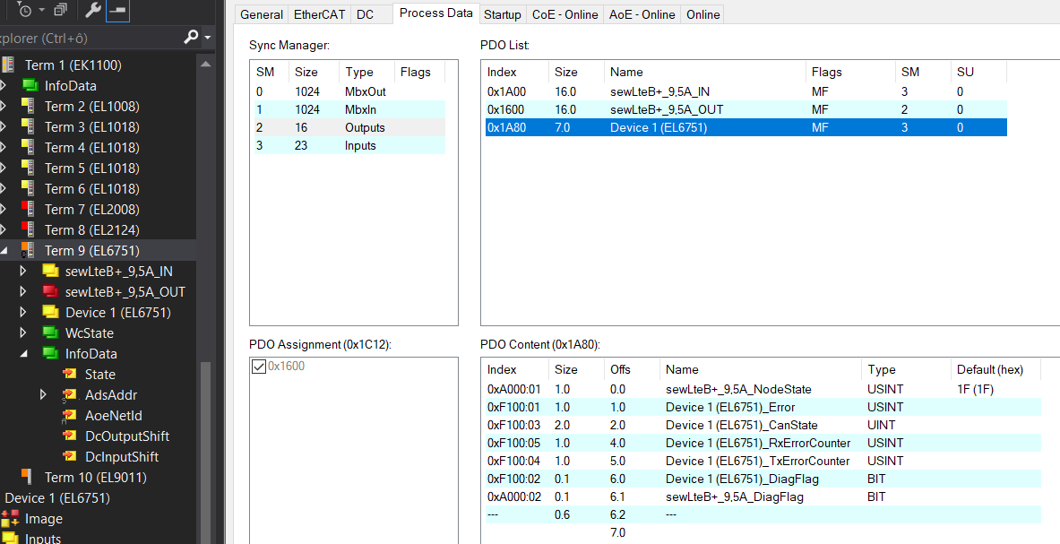

1. Turn off AoE
2. Timing ... 4ms your config != 1ms is your lcec master
3. Refclock cycles has to be something negative as "-1"
Here is working config of the sewlteb from my machine...

- Marko6
- Posts: 8
11 Oct 2025 10:24 #336275
by Marko6
Thanks. It works now.
However I have spindle.0 and spindle.1 and as soon as I added spindle.1, spindle0 stopped working (Linuxcnc - Qtdragon only sends the setpoint.0 value and no enable signal). Strange.
