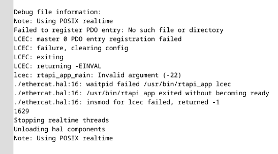

- MatthiasCNC
- Posts: 4
05 Oct 2025 16:12 - 05 Oct 2025 16:19 #335865
by MatthiasCNC
Replied by MatthiasCNC on topic CiA 402 in 1.15.0
Hello, thank you for your reply.
I think it has helped me a little.
I have rewritten my files and based them on “lcec_configgen.”
I found the problem.
There was a second hal file in which it was hidden.
cia402.hal:16: insmod for lcec failed, returned -1HAL: ERROR: pin 'lcec.0.3.out-01' not found
Now I always get this error.Debug file information:Note: Using POSIX realtime./ethercat.hal:15: execv(./lcec_conf): No such file or directory./ethercat.hal:15: waitpid failed ./lcec_conf lcec_conf./ethercat.hal:15: ./lcec_conf exited without becoming ready2729Stopping realtime threadsUnloading hal componentsNote: Using POSIX realtime
What could be the reason for this? Thank you

- Hakan
- Posts: 1322
- Thank you received: 459
05 Oct 2025 16:24 #335866
by Hakan
Replied by Hakan on topic CiA 402 in 1.15.0
Remove "./" from the line
loadusr -W ./lcec_conf ethercat-conf.xmlPlease Log in or Create an account to join the conversation.
- MatthiasCNC
- Posts: 4
05 Oct 2025 19:19 #335876
by MatthiasCNC
When I remove that, the following error occurs.
If I understand correctly, he has a problem with 6040, which would be the control word.
Unfortunately, I don't understand what the problem is with it. It is present in both files.

06 Oct 2025 08:14 #335904
by Hakan
Switched to the generic driver, ok.
You probably need to add the configPDOS="true" to the linelike
<slave idx="0" type="generic" vid="0x0000001d" pid="0x007b1a95" name="D1"><slave idx="0" type="generic" vid="0x0000001d" pid="0x007b1a95" name="D1" configPDOS="true">Please Log in or Create an account to join the conversation.
- MatthiasCNC
- Posts: 4
06 Oct 2025 17:47 - 06 Oct 2025 17:47 #335928
by MatthiasCNC
Thanks.
Yes, I switched to the generic driver. After studying the nearly 1000 pages of documentation, I didn't see any advantages
I can configure the converter very well directly.
The tip helped me. I had to remove “name=‘D1’” and add “configPdos=”true".
You have to pay attention to upper and lower case here.
Then there were a few minor things in the ini and hal files. Now my bus is running.
Now I just have to take care of the units.
<slave idx="0" type="generic" vid="0x0000001d" pid="0x007b1a95" configPdos="true">Then there were a few minor things in the ini and hal files. Now my bus is running.
