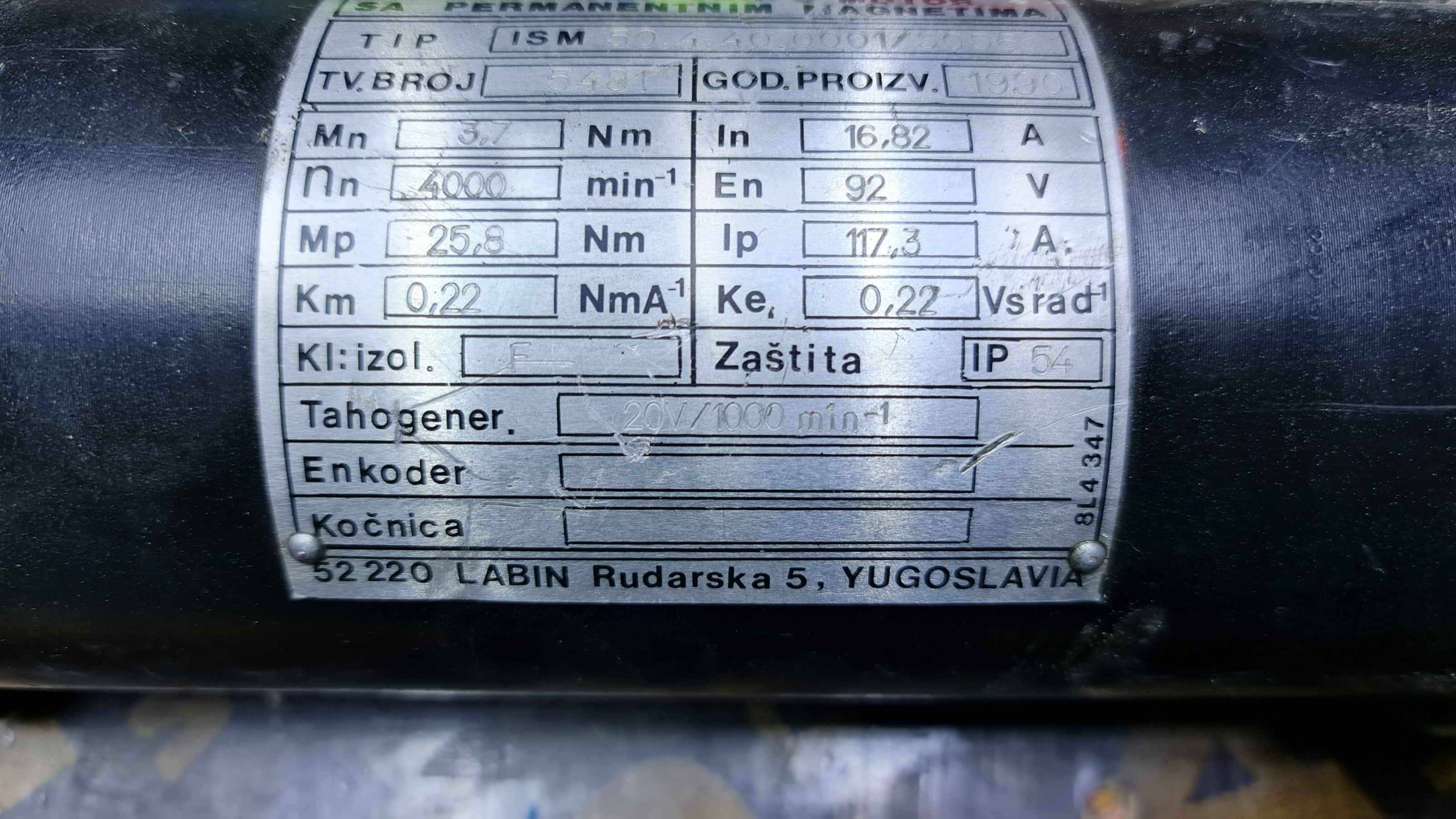

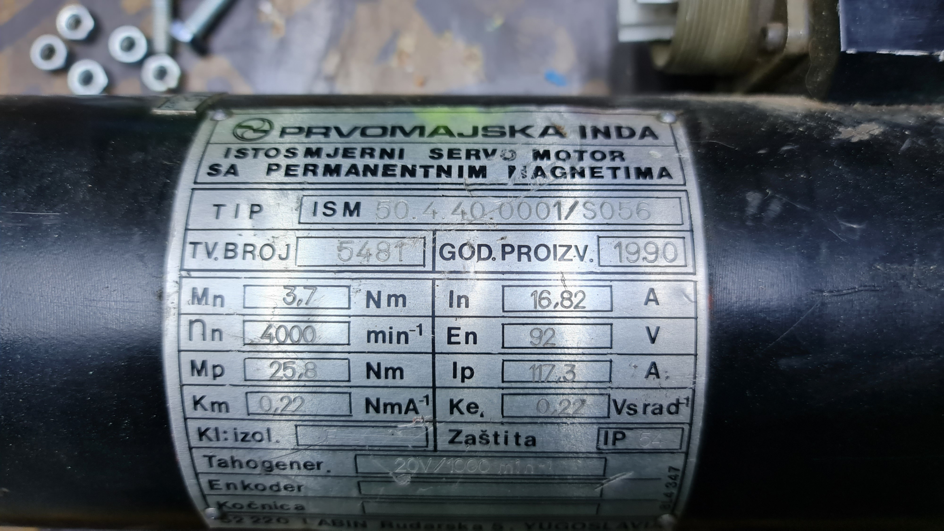

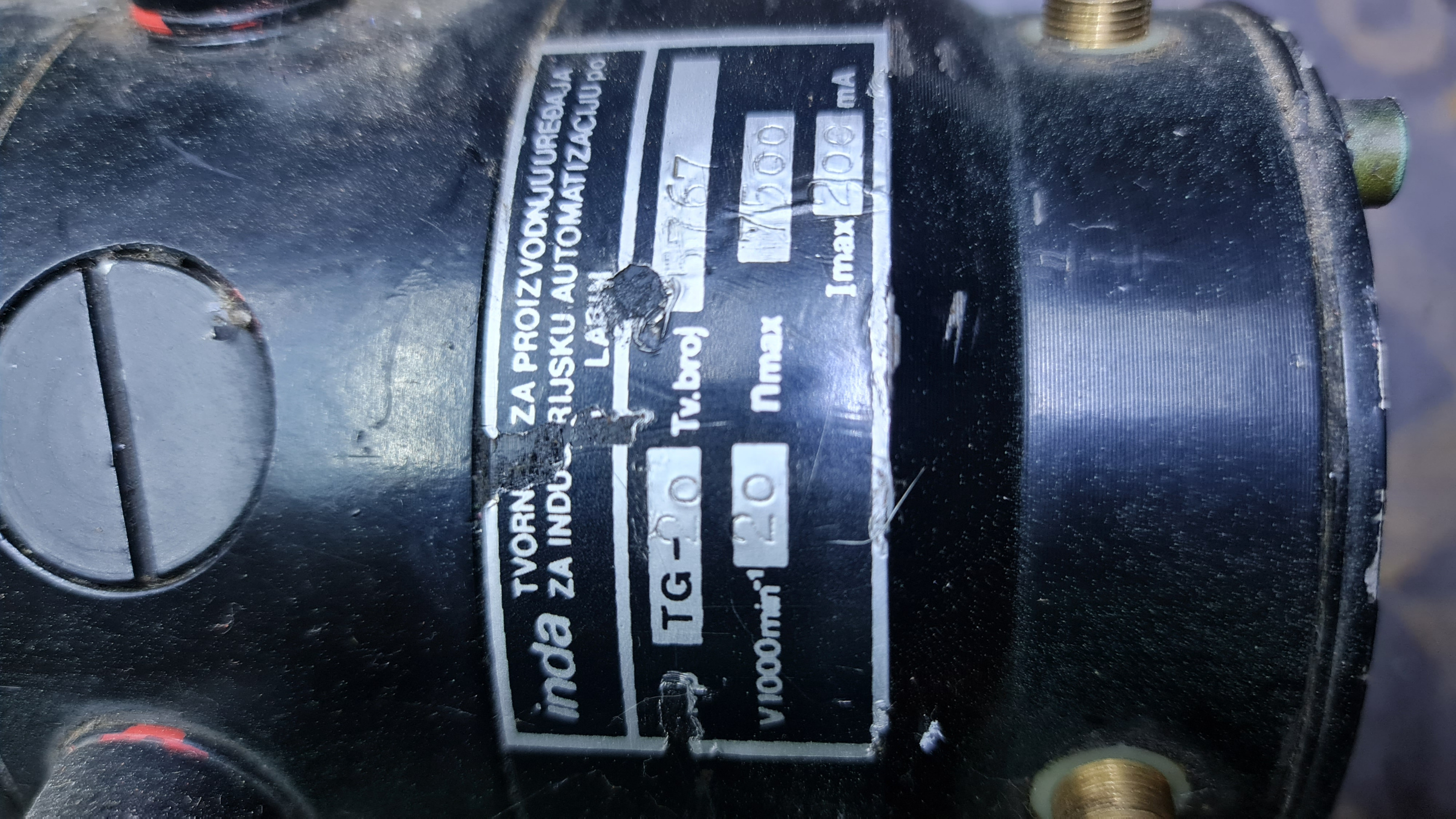

Sorry for the delay, pictures attached, DC brushed motors with tachos, no encoders, encoders were mounted on the ballscrews.
02 Aug 2024 19:46 #306791 by endian
I do not have a driver which can handle with 16A with so low bus voltage as your servos are... I saw 16A drivers in my local dealers but there are prices over €2k ... you should to find something less current thirsty
ebay is full of them... I bought 6 servos 640V/2A/2Nm for less then €200 in the past with very gently feedback hiperface
try and let me know
02 Aug 2024 19:58 #306796 by tommylight
Replied by tommylight on topic How to monitor OP mode in Panasonic A6B Ethercat
Thank you, i really appreciate you trying to help.
Thank you very much.
02 Aug 2024 20:02 #306798 by endian
Which type of encoder you want to attach at the ball screw?
Because if you have just TTL rs422(6cable signal + 2cable source) is pain to setup the servo, because you have to know a commutation angle.. best budget way is to use a resolver for every type of universal servo driver...
