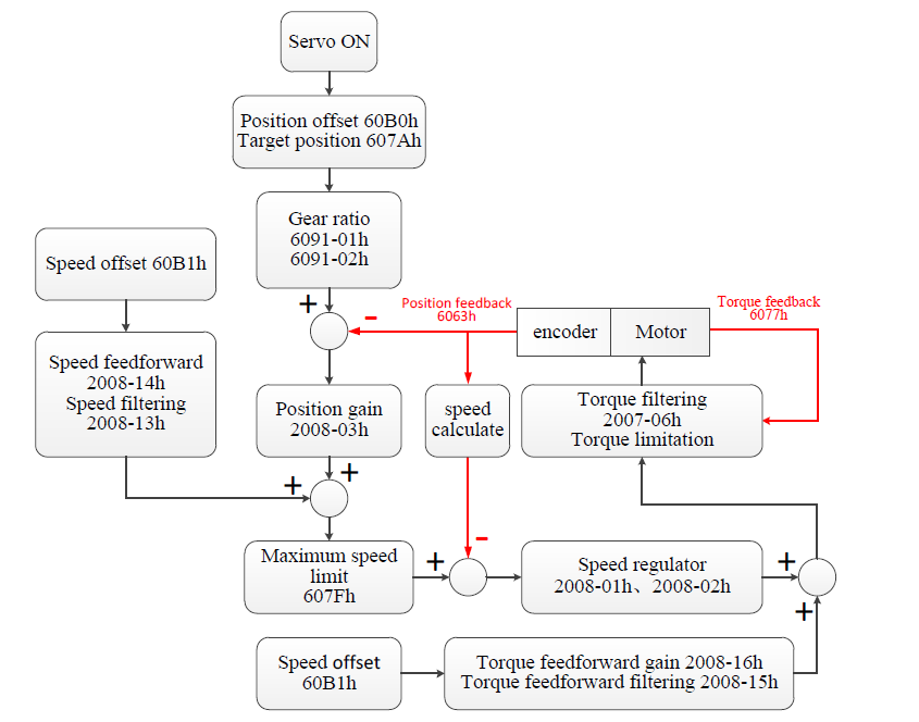

Copying the velocity FF command from the comp file to the XML file significantly reduces following error to a ramp. I haven't really tuned the drive yet. If anyone has found an auto-tune button, please let me know.
.comp
drv_target_velocity = (int32_t) (velocity_cmd * velo_scale);
.xml
<pdoEntry idx="60B1" subIdx="00" bitLen="32" halPin="target-velocity" halType="s32"/>
.comp
.xml

LC-E series drives dont have an auto tune feature. Has anyone successfully tuned these drives even when only one motor is used per axis (not a gantry)? Considering if I buy a kit as well over Inovance or Leadshine
