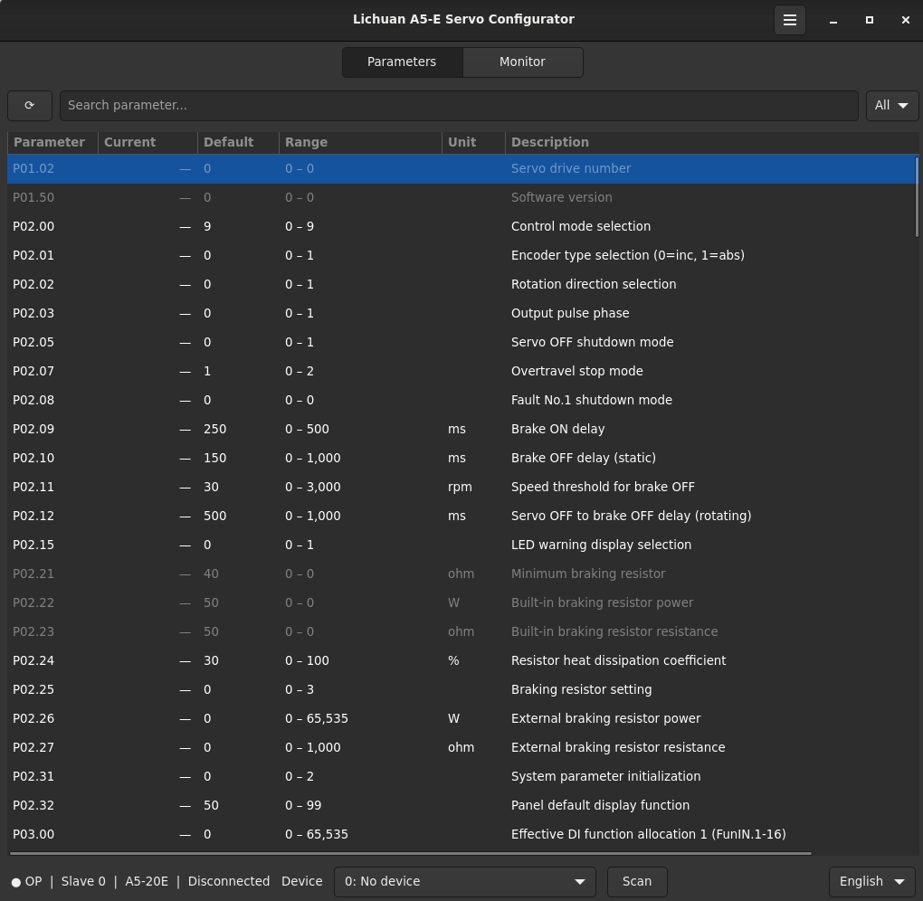

05 Jul 2026 05:50 #347527
by MaxEkb77
Replied by MaxEkb77 on topic Problems with Lichuan Ethercat servo drive
Anybody need ?
- NWE
- Posts: 263
- Thank you received: 81
06 Jul 2026 10:00 #347554
by NWE
Replied by NWE on topic Problems with Lichuan Ethercat servo drive
Thanks, that looks like a screenshot of some kind of Lichuan servo drive configuration software. Can you give more details?Anybody need ?
