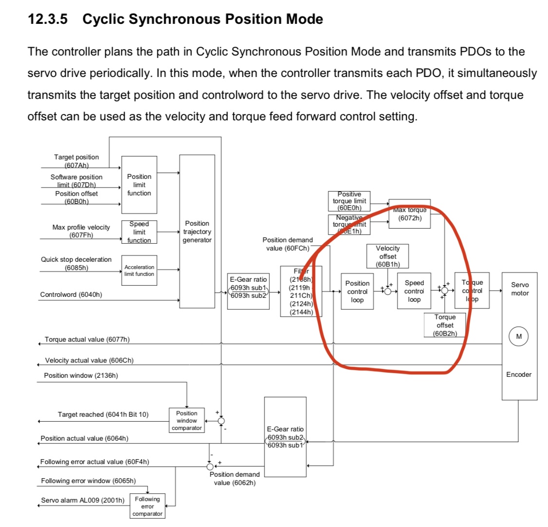

Hello,
i have EtherCAT setup with Delta B3 servos. There is option to go for Position or Velocity mode when configuring servo drives in xml file.
The position mode works straightforward, but the following error is quite big - up to 1mm depending on actual speed. Actually it is proportional - the faster you go, the bigger the following error.
The other option is Velocity mode, I guess you need to use PID component to be able to tune the velocity loop.
I only tried velocity mode on my other setup (mesa 7i95t with Delta B3L drives) and I was able to tune following error down to 0.00X mm at peaks.
So my question is, what are the pros and cons for both modes if its over EtherCAT?
Also how is following error calculated in position mode over EtherCAT?
I think lot of people go for linuxcnc due to ability to use EtherCAT, so deeper explanation for correct configuration would help to many of us.

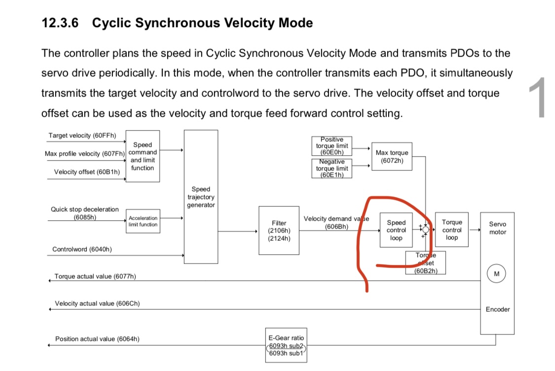

25 Jun 2024 02:19 #303726
by onceloved
Replied by onceloved on topic Position vs Velocity mode
I have configured my ethercat z-axis to velocity mode and used pid to adjust the following error. The advantage of position mode should be that it can be used without much adjustment, while velocity mode requires a lot of adjustment.

25 Jun 2024 05:08 - 25 Jun 2024 08:00 #303733
by zmrdko
Replied by zmrdko on topic Position vs Velocity mode
Last edit: 25 Jun 2024 08:00 by zmrdko. Reason: More info
- onceloved
- Posts: 134
- Thank you received: 59
25 Jun 2024 07:03 #303736
by onceloved
Are you talking about the tuning on the servo drive? I have already turned it off. I have only adjusted the stiffness setting on the servo drive, but it seems to be useless. I adjusted the stiffness using the p item in the pid

25 Jun 2024 08:01 #303742
by zmrdko
I’m talking both. How to make the whole setup accurate and reliable. Tuning a servo drive is a necessity.

25 Jun 2024 11:47 #303747
by Donb9261
Replied by Donb9261 on topic Position vs Velocity mode
Back in the day before the current chips used, the data for position mode was at times difficult to handle and had to be buffered on both ends to avoid stalls in motion because the drive had to process how to handle the coordination in the drive. In most cases Velocity mode was avoided because it forced the controller to do nano second position adjustments and if not tuned perfectly would cause runaway events leaving steps and tool marks in the drive.
In the industrial world the use of either position mode or torque mode are chosen. It reduces internal overhead allowing for faster feeds and more granular accuracy of motion. That said, torque mode requires additional tuning as well. The caveat in torque or velocity mode is that you machine MUST be very stiff mechanically. Otherwise you will forever be retuning the coordinated motion as all axis must be tuned to each other.
In position mode, the controller need only look at the FB compared to the actual and make minor adjustments in realtime on each cyclic data stream as needed. The drives of today have their own internal motion controller and active tuning while in position mode. This cuts out the middleman issue and allows for extremely accurate and fast position updates.
It is my express opinion that using V or T mode while possible, these are very impractical and overkill for hobby or light industrial as the cost of the required measuring equipment to tune the machine as tightly as position mode will pretty much do for you is very high. Ball bars and laser measurement is required and costs nearly $30k. And then there is the know how aspect. If you have tolerances of volumetric accuracy of .0005" or .01mm position mode is more than enough. Even for 5 axis work. Below that, and you must also include temperature compensation in the mix to maintain a true net accuracy below .01mm.
The best practice in position mode is encoder counts, encoder counts, encoder counts. 23bit absolute multi turn encoders area ideal. This gives the TP(Trajectory Planner) internal to the drive more than enough information to do nano second position loop adjustments and control servo error to sub micron accuracy. If you have a loose machine mechanically, this will help tighten the gap but never eliminate it. The second best practice is near zero backlash on all axis.
Hope that helps keep you from running down the rabbit hole of chasing tune.

25 Jun 2024 12:05 #303749
by zmrdko
Thanks for thorough explanation. Drive tuning is no big deal. So if I understand correctly, the position mode is way to go. Now we only have to sort out the excessive following error within linuxcnc in position mode. Can anybody explain, why?
