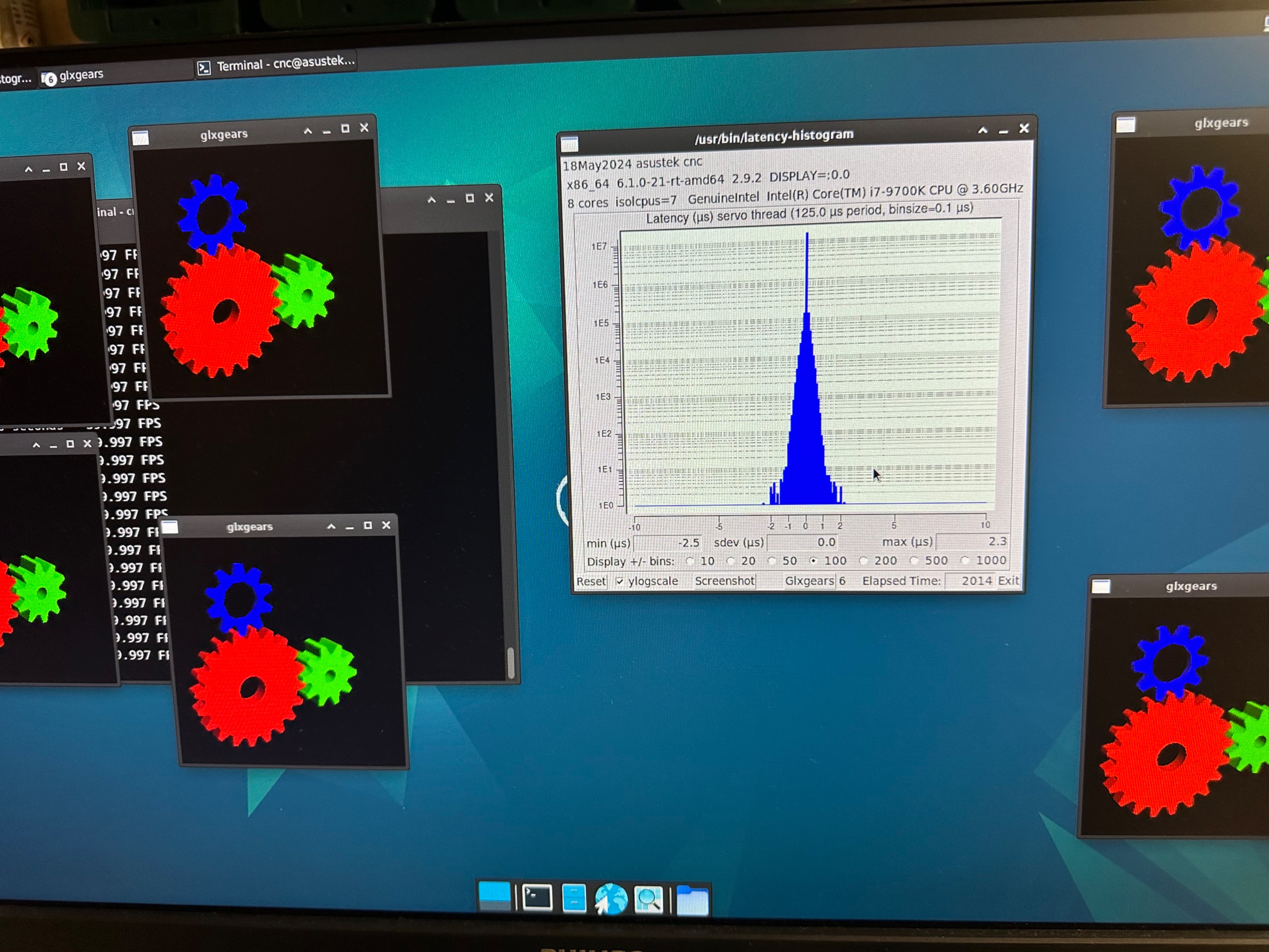

i am running i7 9700k (8c/8t - i think it’s the last cpu with one thread per core)
32GB ram and z390 motherboard and external intel ethernet card. I had bad latency with onboard ethernet adapter. I have also better experience with full size built pc, rather than office desktops (dell, lenovo). I dont know if it’s the motherboard thing, but i achieved better latency results with desktop PCs without any hassle. Might be the power efficiency crap in office pcs.

hello zmrdko,
your thread in the linuxcnc are running at oversample 8kHz .. what is your confing for them ? hardware and else.. ethercat has which time period ?

EtherCat is 1 ms. tick cycle or 1Khz for the frame cycle. EtherCat in LCNC is more a 800~900hz so there is a slight lag but the DC will always sync to the first clock in the first peripheral. From then on all DC on all devices will be offset to sync with the known clock derived from the first device.
Etherlabs EtherCat explains this in the docs.
So regardless of servo thread rate, the EtherCat frame cycle will find its own clock rate to update the drives. As I have stated in prior posts, EtherCat in LCNC is a quasi real time version. It is functional to the mid app level. If you exceed 1500IPM in simult axis control, accuracy may suffer. Or the driver will drop the comms and error due to overload in the frame buffer.

Hi, i was solving issue with raspberry pi 5 with guys at etherlab, and from my understanding 1ms or 1kHz ethercat cycle is limit for genetric driver. You can get faster cycles when using native drivers like e1000 or igb for intel based ethernet cards.
