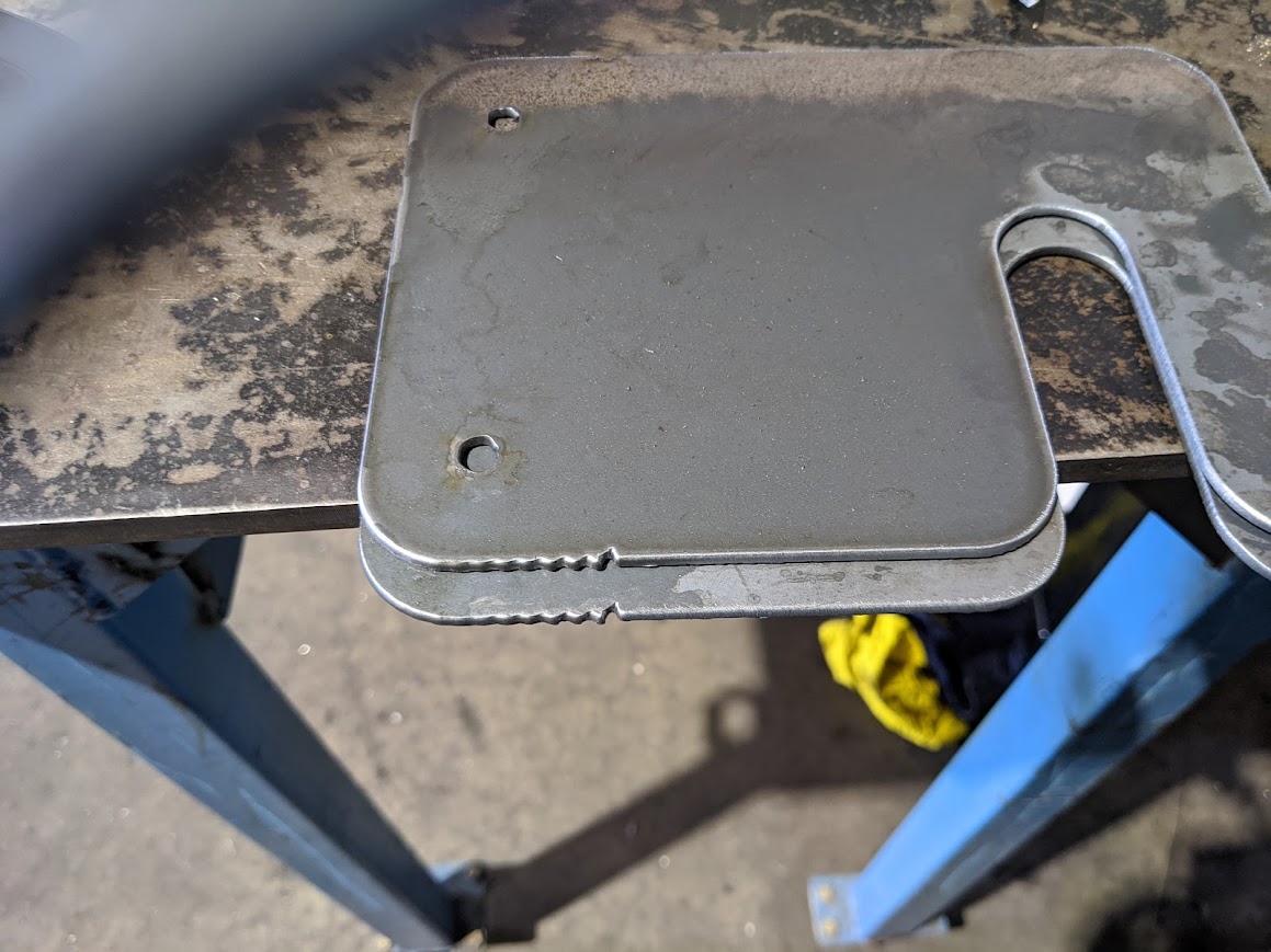

I have experimented with 60m/min and 0.8 G Accelleration (8 m/sec/sec) on a plasma table and can confirm what Don says that the inertia at this level of performance will shake your machine apart. People seem to gloss over that part of his discussion but it is very true.
Hence the need for jolt limited tool paths.
Which shows, for high performance CNC machining, one needs to fine tune every component of the system. Toolpath, software, electronics, mechanics and ambient atmospheric conditions. The effort required climbs exponentially.
06 Jul 2024 09:50 - 06 Jul 2024 09:51 #304523 by rodw
Replied by rodw on topic Position vs Velocity mode
I found an example of said inertia, where I cut a small V shaped notch when plasma cutting a hook for a curtain rod to act as a fold mark.
Here the notch was deep enough to get to cut speed of 2.2 m/min before immediately reversing. Accelleration was probably 5 m/sec/sec (0.5G)
And I thought I had a stiff gantry!
