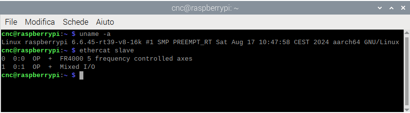

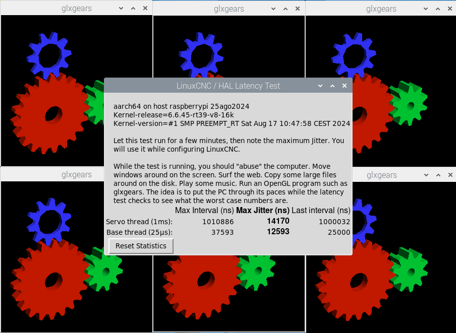

hello
to update what I wrote here
I resumed the installation of LCNC + etherCAT on native Raspberry Pi 5 OS.
I turned the raspy back on and there were some updates to install, after doing this I ran this in the terminal
everything works on native OS with audio and video graphics ok!!!
sudo dpkg-reconfigure ethercat-dkmseverything works on native OS with audio and video graphics ok!!!
