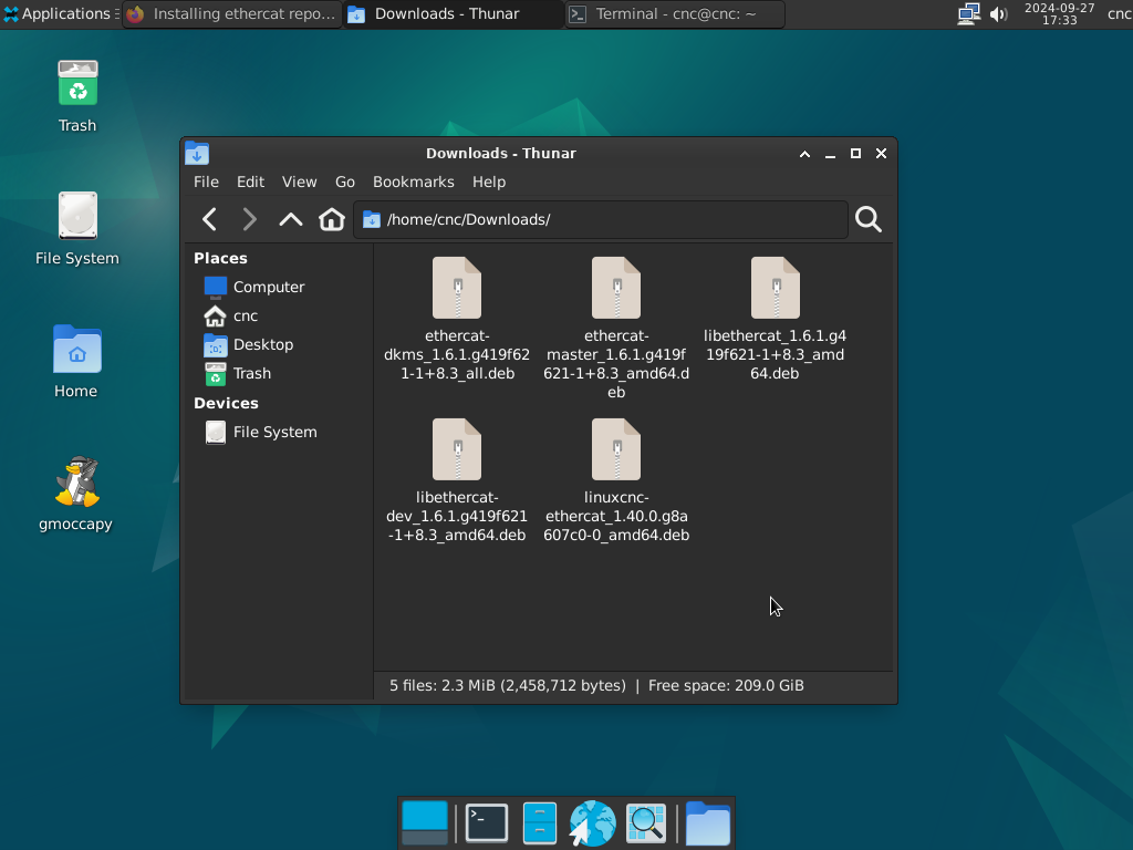

- Posts: 22012
- Thank you received: 7492
26 Sep 2024 01:48 - 26 Sep 2024 01:49 #310802
Replied by tommylight on topic Installing ethercat repositories
Versions of deb files have changed so none of the existing methods work, try manually downloading and installing from here:
download.opensuse.org/repositories/science:/EtherLab/Debian_12/
and here
download.opensuse.org/repositories/scien...erLab/Debian_12/all/
See the error report and download only files mentioned near the end
and here

- Posts: 22012
26 Sep 2024 10:31 #310822
Files in the above folders ending with .deb, but they will have different numbering in the names.
E: http://download.opensuse.org/repositories/science:/EtherLab/Debian_12/all/ethercat-dkms_1.6.0.g8330bca-1%2b3.1_all.deb の取得に失敗しました 404 Not Found [IP: 195.135.223.226 80]
E: http://download.opensuse.org/repositories/science:/EtherLab/Debian_12/amd64/ethercat-master_1.6.0.g8330bca-1%2b3.1_amd64.deb の取得に失敗しました 404 Not Found [IP: 195.135.223.226 80]
E: http://download.opensuse.org/repositories/science:/EtherLab/Debian_12/amd64/libethercat_1.6.0.g8330bca-1%2b3.1_amd64.deb の取得に失敗しました 404 Not Found [IP: 195.135.223.226 80]
E: http://download.opensuse.org/repositories/science:/EtherLab/Debian_12/amd64/linuxcnc-ethercat_1.39.0.g4299f7a-0_amd64.deb Please Log in or Create an account to join the conversation.

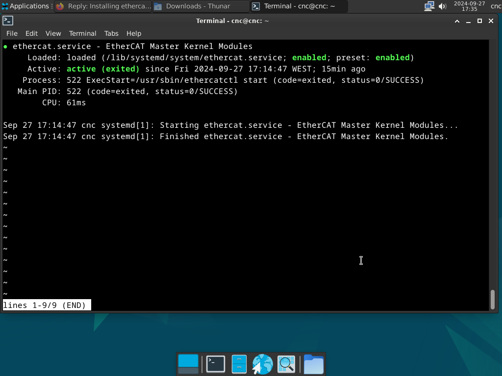

- Rios
- Posts: 17
27 Sep 2024 16:45 - 27 Sep 2024 16:50 #310906
by Rios
Replied by Rios on topic Installing ethercat repositories
After following the advice from tommylight and downloading and installing the files in that order did in fact work , the names aren't the same but i will post the files that worked for me .
After downloading i wasn't able to install by the GUI Package Installer , so i used the cmd :
the same for the rest of the files , after that is just to continuing to follow the tutorial from this link and it will be done.
Thanks to tommylight and rodw for the continuos help.
cd Downloads/
sudo dpkg -i ethercat-dkms_1.6.1.g419f621-1+8.3_all.debthe same for the rest of the files , after that is just to continuing to follow the tutorial from this link and it will be done.
