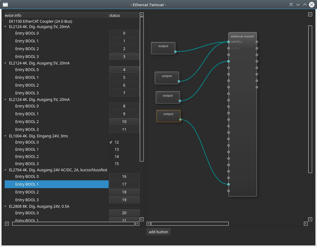

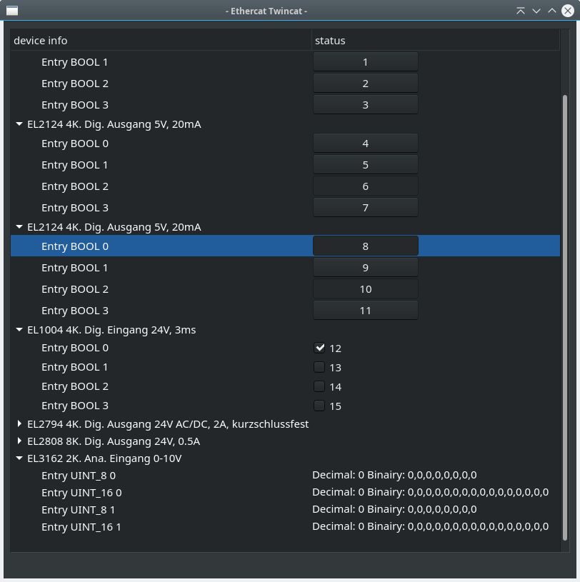

19 Nov 2024 08:34 #314847
by Grotius
Replied by Grotius on topic Ethercat auto configurator.
To create a program like twincat for linux i made a little example,
how we can do this.
Here is a little project that show's the ethercat configuration.
It dynamicly add's button's, labels and checkboxes.
It includes reading and writing a few value types. But can be expanded
to read & write more ethercat data types.
This works nice.
I think we can also modify the linuxcnc-ethercat source to automate the .conf process.

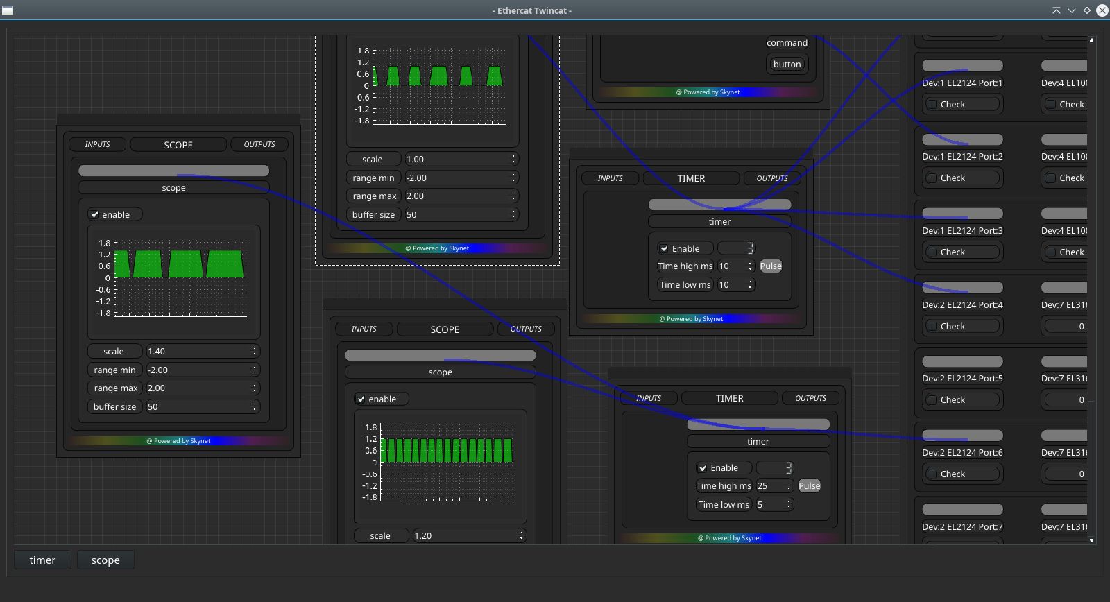

24 Nov 2024 16:38 #315192
by Grotius
Hi guys,
Related to the previous post, where i was struggeling with a node library for too long time.
I had to make a choice what to do.
1. Just don't use the qtnodeeditor lib.
2. Don't use node structure's.
3. Try to create your own lib.
Choosed nr.3.
It took a few day's to figur out how the qt grapics widget works. And how to display qt widget in it.
Then made a solution for creating a simple setup for input, output ports and their widgets.
In the end, the result surprised me.
This is a test video, that loads a few input and output ports, and widgets attached to the port.
Then you can connect the output ports with the input ports. Data flow will stream then from output to input.
This whole idea can be used to format several big and complicated projects, like :
1. rtapi multi threading on several cpu's.
2. super imposed interpreters, running on multiple threads.
3. cnc machine interpreter to machine axis layout. Like connecting ABC, UWV axis.
4. Ethercat bus simulator on real hardware.
5. Plc
6 Classic ladder
User can just create .ui based widgets. This is easy to design. Each .ui widget then may have multiple input or output ports.
The logic is then done by the .ui class, wich conttains also the .h and .cpp files.
Let me know what you think, this is just an example :
Greetings.

24 Nov 2024 17:24 #315202
by Grotius
Hi Tommy,
Thanks.
No blender is used so far !
What you see are original qt widgets.
I foresee a lot of happy people, thanks to you.
Maybe. Hahah.
A lot off people are also happy with you, including me.
But most won't see the source code as we are hosted on codeberg.
This is a non profit organisation from Berlin Germany.

The ethercat auto configurator app is now able to perform logical operations. Like a plc.
Made a example timer widget. That sends pulses to the ethercat output ports.
The pulse has a high- and low time.
There is a easy way to create your own logical widgets. Creating a new widget cost's about 15 minutes of your presious time.
There is a QCustomWidget example widget that shows you how to do it.
We can use all kind of widget's here.
Project source
