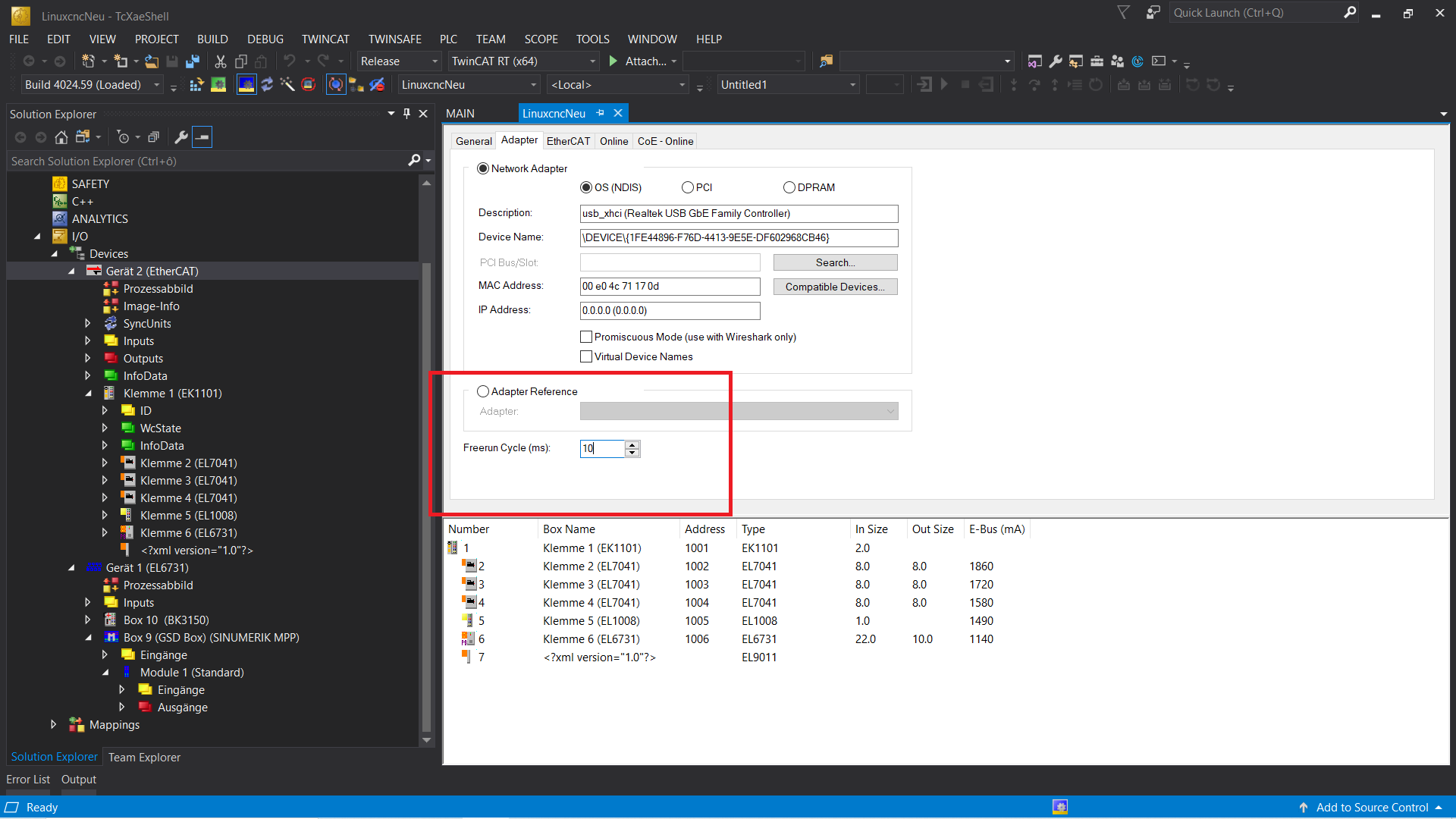

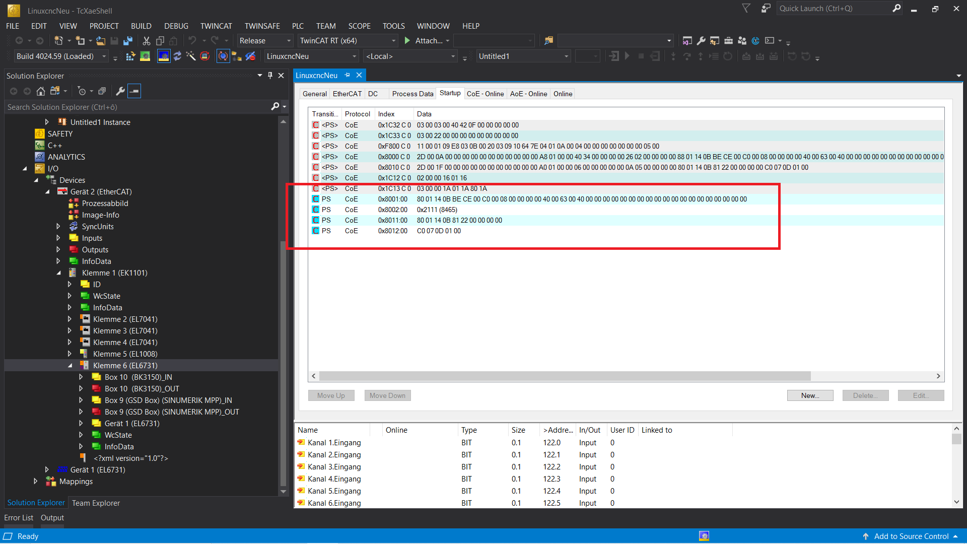

I have a problem with the Beckhoff Profibus card EL6731.
It always switches to the INIT state after a few seconds. And this happens again and again. Before that, however, it is always in OP status and data is also exchanged with the slaves. It looks like a timeout to me, but after about 2 days of searching I still haven't found the solution. Maybe someone here can help me and give me the right tip.
I have already replaced the card to exclude a defective card
In the dmesg.txt file in line 1896 you can see that the status changes to INIT. The file contains the complete output after Linuxcnc was started.
I have attached my configuration. If anything else is missing, I can upload it.
I have also attached the TwinCAT project as an archive. I changed the extension “tszip” to “zip” so that I could upload it.

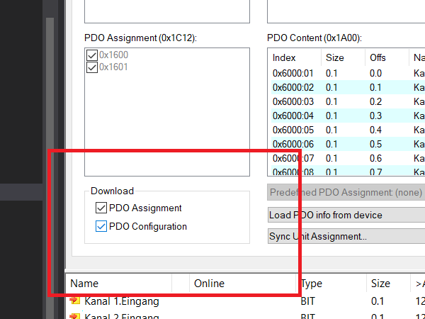

have you tried the PDO config download during the configuration in the TC3?
Your config is missing of the DC configuration adn SDO datas cofig too... if your config do not have a DC ... It will be synchronned by the sync manager which behaviour are pure asynchorious ...

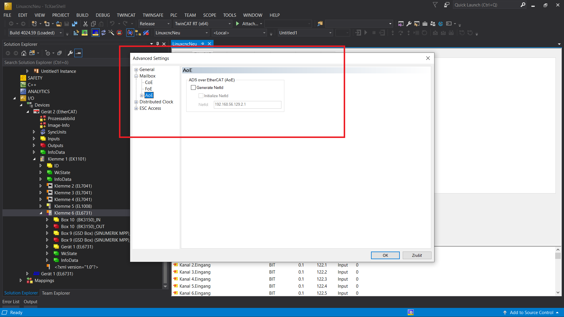

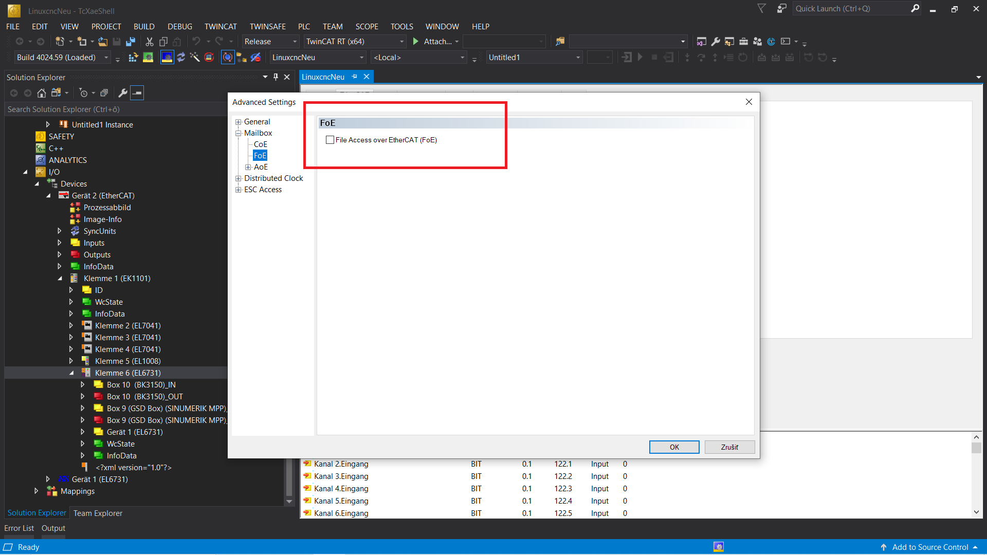

If you do not need the FoE and AoE ... it is the best practice to turn them off all ...
save extra time with next features ... maybe it will help you to digging out of this rabbit hole
let me know
regards
let me know
regards
- fabi0696
- Posts: 4
17 Mar 2025 11:08 #324103
by fabi0696
Replied by fabi0696 on topic EL6731 changes cyclically to INIT status
Hello,
thanks for the help... But nothing is working at the moment. :-D
The best thing to do withworked... except that the card always restarted. But with the configuration the process data exchange worked anyway.
Maybe I don't quite understand this.

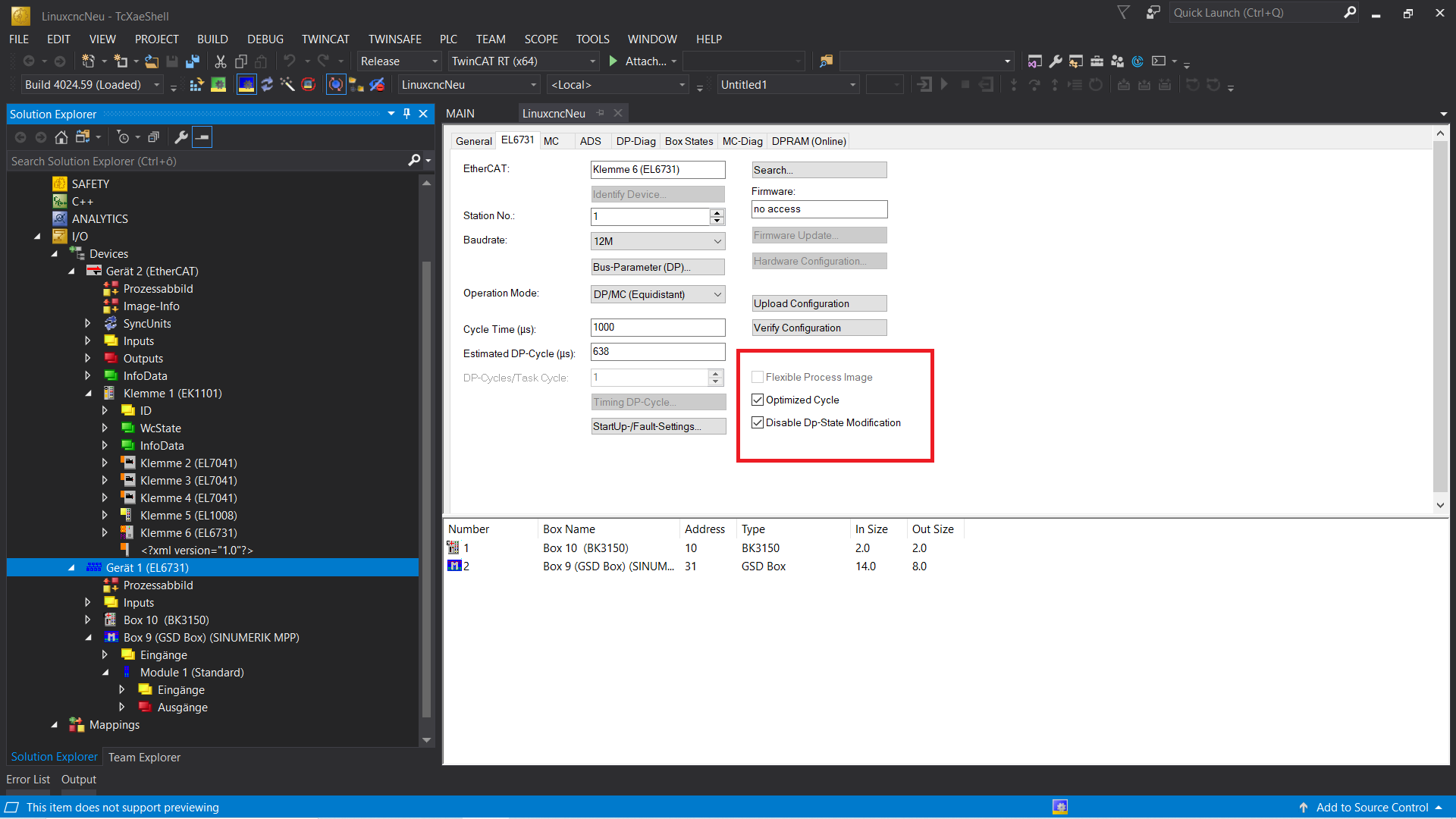

The operating mode of the EL6731 “DP (Equidistant / no GC)” is correct, isn't it?
That also changes to
I have now deactivated the FoE and AoE. I really don't need that now.
The slaves seem to remain offline and no data exchange.
How can I understand this?

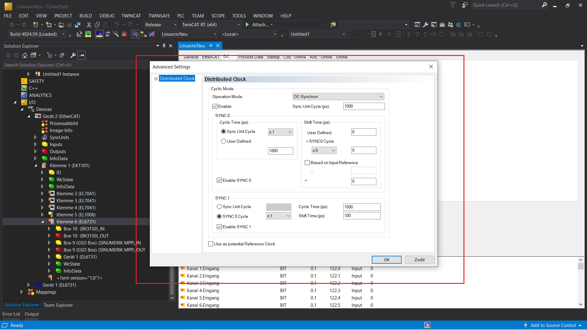

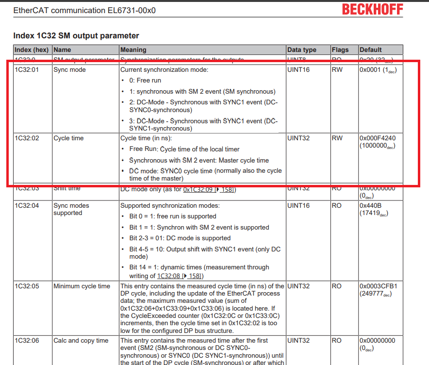

Hello,
if your config with profibus needs a sync movements... It is necessary to use a Equidistant mode... if not it should be in the free run -
DC sync in your case 1C32 parameter is -- 40 42 0f 00 == 1ms but it is too short and I can guarantee timing incidents ..
Free run in your case 1C32 parameter is - - 40 42 0f 00 == 1ms but real synchronization it based on scan time of profibus
then you configuration is missing the SDOs -
it will be right behind the "complete" mapping guys but in front off sync managers ...
What have I forgotten?
If you will choose the DC operation mode - somewhere in the slave config it has to be a DC configuration of the slave - something like
“03 00 03 00 40 42 0F 00 00 00 00 00 00”Free run in your case 1C32 parameter is -
“03 00 01 00 40 42 0F 00 00 00 00 00 00”then you configuration is missing the SDOs -
