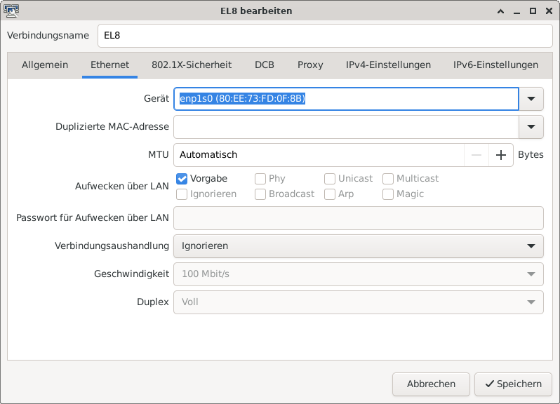

I need to reopen this topic. The installation went smoothly as described above. After reinstalling the system, I can no longer access the EK1100 (it worked before). I've spent hours searching for the error, but to no avail. What I noticed is that the EtherCAT master always has the status "Link DOWN."

The EK 1100 is powered and the network is connected. Is there something wrong with the network configuration?

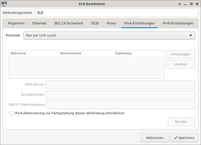

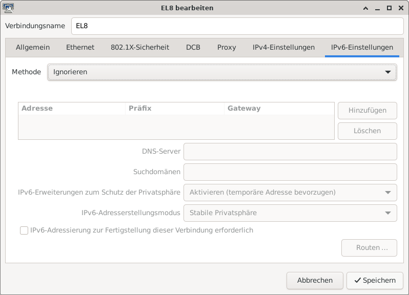

Looks like your network adapter is not upped correctly. The master can't access ethernet.
Check "ip a", it should say UP for the adapter but I guess it won't.
Follow one of the standard debian guides to bring it up, will involve the /etc/network/interfaces file.
Can be a permission problem, check "ls -l /dev/EtherCAT0" should say crwxrwxrwx
Try with "sudo service ethercat restart"
Also check "sudo dmesg" the last say 50 lines for anything that can help.

The following results:
- ip a returns the result that the adapter is running without errors:
enp1s0: <BROADCAST,MULTICAST,UP,LOWER_UP> mtu 1500 qdisc mq state UP
- the permissions are also correct:
crwxrwxrwx 1 root root 238, 0 3. Mai 16:22 /dev/EtherCAT0
nevertheless the link is DOWN and I cannot start a test configuration
