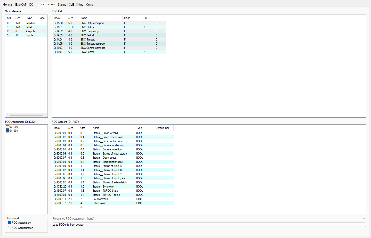

Hello all
i'm trying to implement a Beckhoff EP5101-0011 incremental encoder input into LinuxCNC with its 32bit counter. I need to read glass scale inputs with around 520 mm in length and a resolution of 1 µm. For that i need atleast 19 bit, and its standard PDO assignment with the "compact" 16bit encoder-value doesn't cut it.
I can easily change the PDO assignment in the EtherCAT-Configurator application and the EP5101 activates the 32bit counter, after reconnecting the LinuxCNC machine it is also able to use the bigger counter, but after power cycling the device, it defaults back to the 16bit counter. So i tried to set the correct PDO assignments via SDO uploads, but that did also not work, it doesn't want to change in the "big counter mode" via LinuxCNC.
It also complained about the other SDO uploads (settings), but that's a problem for later.
What exactly do i have to change, to initialize the encoder input to its 32bit PDO setting?
Thank you in advance for your help

I don't know anything about this device, but it doesn't hurt do a "ethercat rescan" after you made changes to the device.

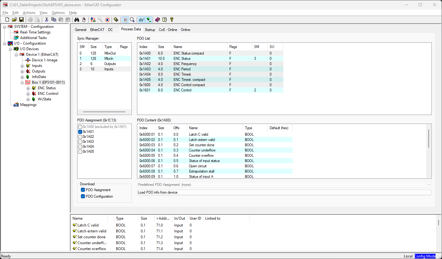

in the lower left corner you has the 2 check boxes ... check both and do the restart solution and activate solution ...
everything should be written in the local memory ... but maybe you will probably need the initCmds file
do not forget to activate DC .. because it is not active from default .. just SM synchro
if you are lazy, just use the console to generate right configuration ... double click on the .exe ... then "c -i" enter .. then drag and drop your full master config export...

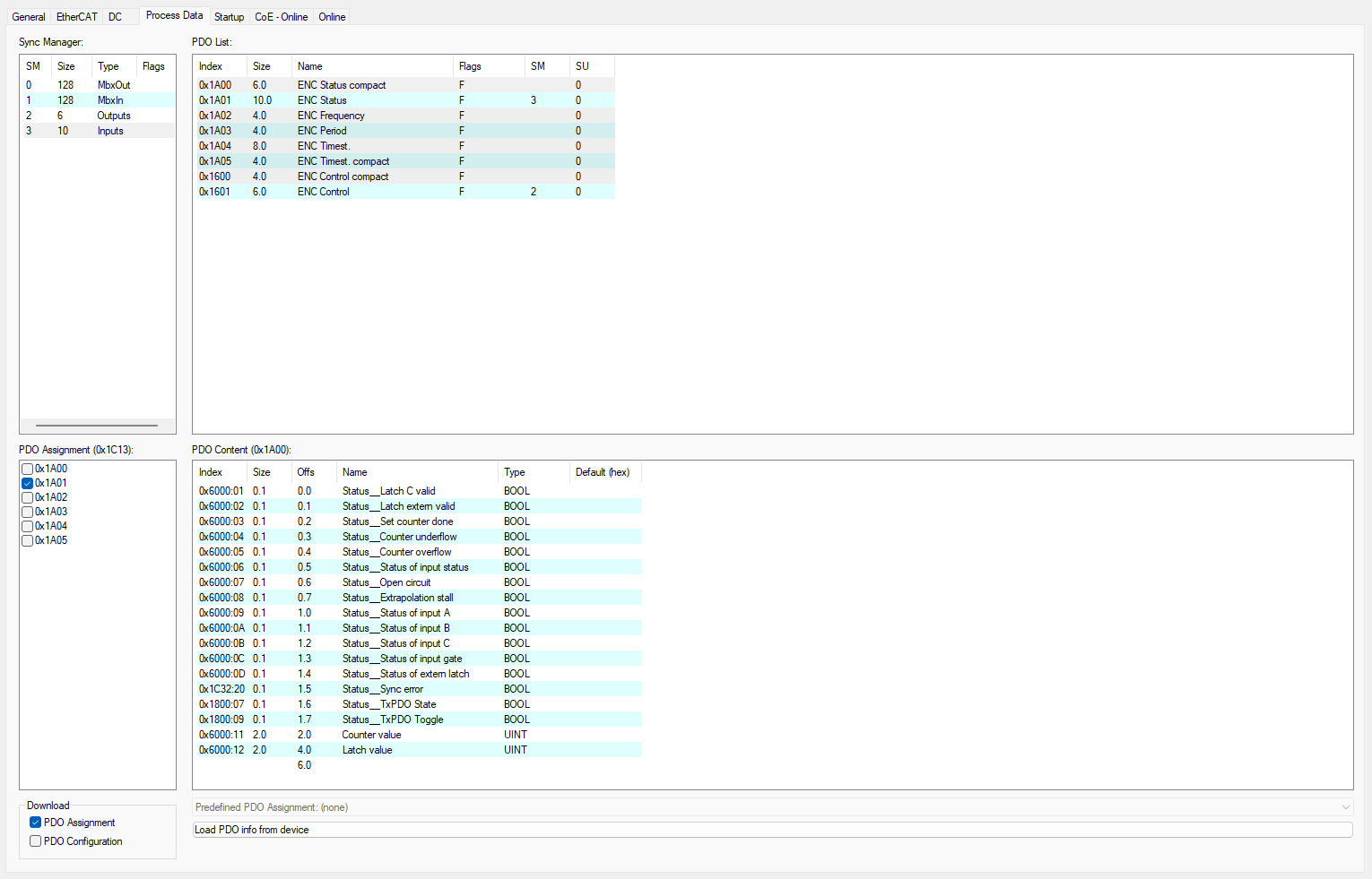

1. I tried to set the corresponding PDO assignments via EtherCAT-Configurator once again. It changed the PDO assignment but after a power-cycle the settings were gone.

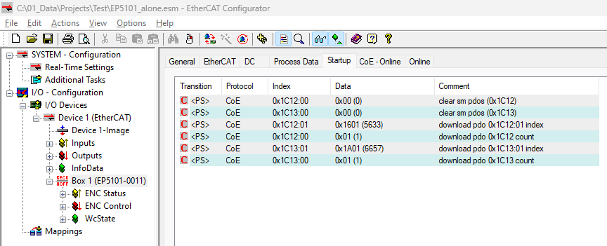

2. I tried to set the PDO assignment via a InitCMD-XML file. The InitCMDs do not change anything unfortunately. A "ethercat rescan" didn't help either, it just caused more errors in dmesg (output attached)
3. Your linked your software "convertorSdos.exe", i wasn't able to use it properly, it errored out with a "Unhandled exception. System.NullReferenceException: Object reference not set to an instance of an object. at Program.Main()" and crashed entirely. I started it with the "Beckhoff_EP5101-0011_config.xml" in the same folder, typed in "c -i" and gave it the absolute path to the before mentioned XML file - what did i do wrong?

Maybe there is an eeprom setup and you will have to overwrite something in the eeprom .. because I can not see any SDOs in the startup list out of SM configuration... From the dmesg you are still tring write SM managers what not exist for them...
My setup before the translator was ... Active configuration, unplug the TC3 master plug lcec master.. ethercat pdos ... And just rewrite active config then I have exporting the SDO config and everything works everytime..
You are using the TC2 instead TC3 .. there should be problem of crashing because I did the translation over TC3 withe 20other slaves CoE or SoE and it works well... Use just TC3, it is better and it is free... Did drag and drop file to the console? Because you have to insert full path ... I am in the heavy storm right now and I can not check your stuff ...

I tried the config from the 23rd and had syntax issues with the InitCMD section. As far as i can tell, you removed it in the version you updated on the 25th. Without the InitCMDs, the encoder inputs indeed change over to their 32bit counter PDO, unfortunately they get stuck in a PREOP error state.
While starting the machine, it also threw error about the "<pdoEntry idx="0" bitLen="4" halPin="Control--194" halType="s32">" part, i just removed that part, because it's not used (gap), according to Beckhoffs docs.
Do you know a solution to the "Slave does not support changing the PDO mapping!" problem, when the slave supports it for sure?
And thank you for your help so far
