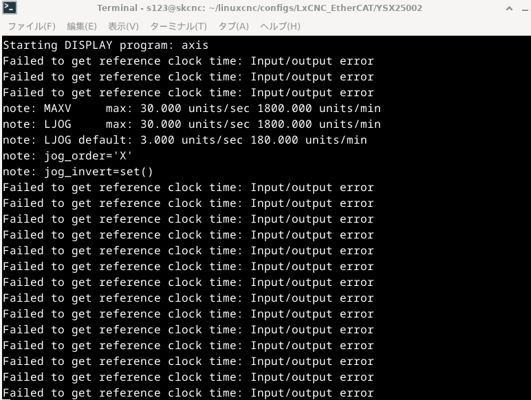

27 Dec 2025 02:44 - 27 Dec 2025 02:56 #340564 by tar_san
Thank you so much.
Result:
A12 Servo driver alarm has vanished.
I could "ServoOn", "Jog move". without any error in Servo Driver LED.
Buf I got this  message "Failed to get reference clock time: Input / Output error"  many times. (screenshot)
