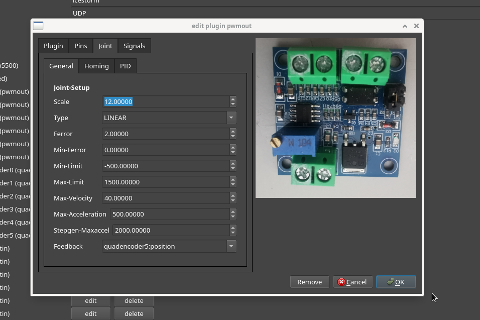

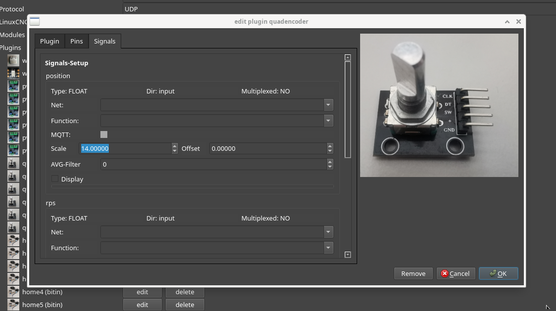

16 Jun 2025 05:32
Category: Computers and Hardware
I'm afraid there is still a bug when generating the ini/hal.
scale in need to be set in the encoder config (signals -> scale):
and out in the joint pwm/dir config (joint -> General -> Scale):
