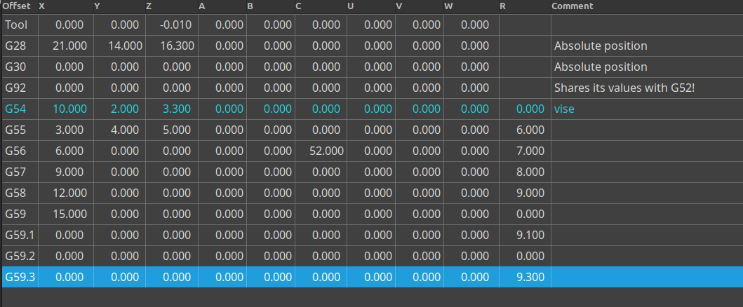

Problem might be that the material symbol and icon library doesn't contain a turtle and/or a rabbit:
fonts.google.com/icons
Anyway regarding the Offset page I came up with this:
Replied by Aciera on topic Gmoccapy 3.5.0 - opinions needed
Cycle!Traffic lights? Walk!!!
Last edit: 27 May 2025 15:09 by Aciera.

Rotation around which axis?
I think for a five axis machine you would need Rx Ry Rz.
- Posts: 4819
- Thank you received: 2177
27 May 2025 19:25 #329263
R denotes the XY rotation angle around the Z axis.
www.linuxcnc.org/docs/html/gcode/overvie...gcode:ini-hal-params
Looks like there has been a discussion about it but it seems to have stalled:
github.com/LinuxCNC/linuxcnc/issues/3064
I've decided to include G28 and G30 position:
Files are here for anybody interested (based on current master)
Note
rows 1-3 (Tool, G28, G30) are not editable. (The comments of those CAN be changed in the .pref file though)
'offsetpage_widget.py' seems to have been written to be used by other Gui(s) as well. I have only tested this on Gmoccapy (there are substantial sections of the code that are not used in Gmoccapy)
Note

Replied by zz912 on topic Gmoccapy 3.5.0 - opinions needed
Why don't you make this a Pull Request?
i would but I have no idea which other guis use this widget so I cannot test.
There are several options:
1) do nothing (worst option for me)
2) test some basic GUIs and accept that it might break other GUIs
3) make your own offsetpage widget for Gmoccapy
I prefer 2) Over time, the GUI will have to be tidied up
