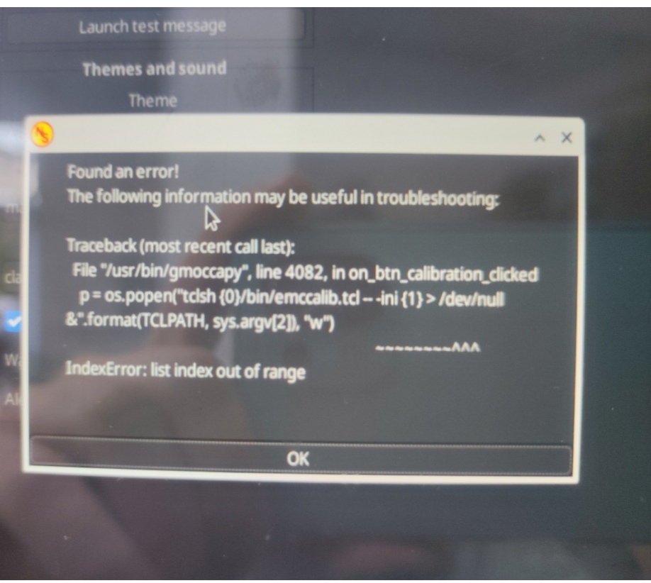

Replied by Aciera on topic Gmoccapy 3.5.0 - opinions needed
The issue with the error is being dealt with:
github.com/LinuxCNC/linuxcnc/issues/3510

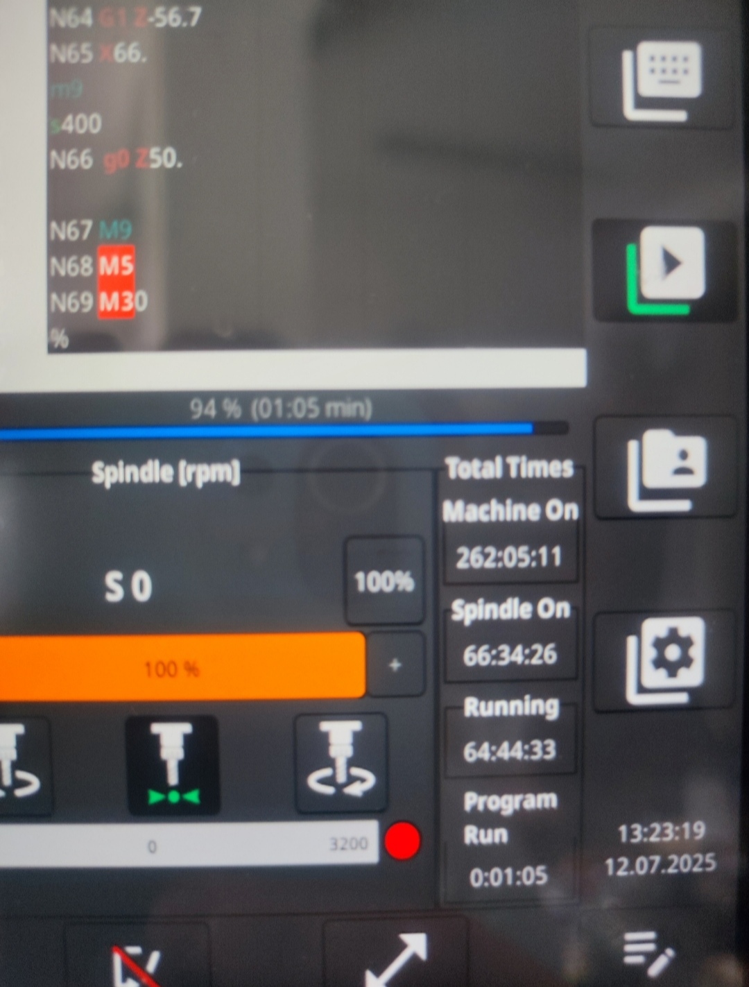

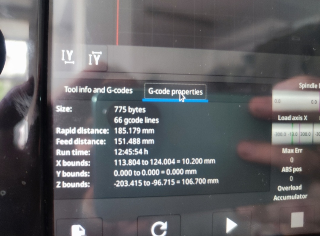

15 Jul 2025 15:14 #331856
by besriworld
Replied by besriworld on topic Gmoccapy 3.5.0 - opinions needed
Small update. When there is no g96 /G95 command in the program, the program calculates the approximate time correctly. Maybe feed per rev is not calculated correctly. Thanks for the great work! I understand that this problem is not in the field of gmoccapy
