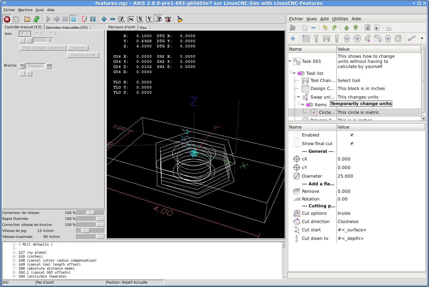

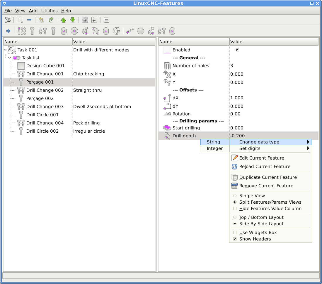

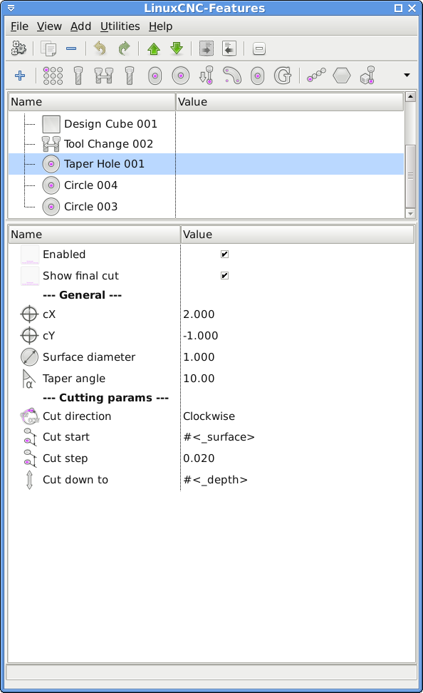

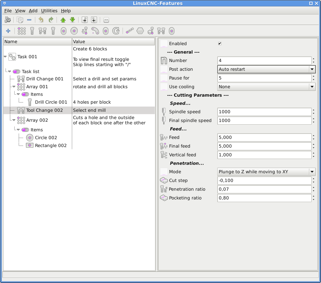

You can now download and test a new advanced version of Linuxcnc-features at
fernv.github.io/linuxcnc-features
Just follow the instruction to use stand alone.
Please report here if you have problems using it.
Some screen shots (stand alone)
Embedded
Best regards
Fern
