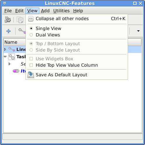

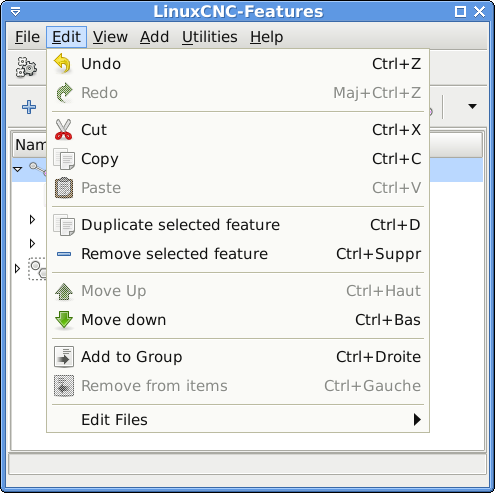

A few screen shot of things to come. Please comment
Menu is reorganized and include many accelerators/shortcuts
Better grouping makes it easier to use. Single view is default now
Best regards
Fern

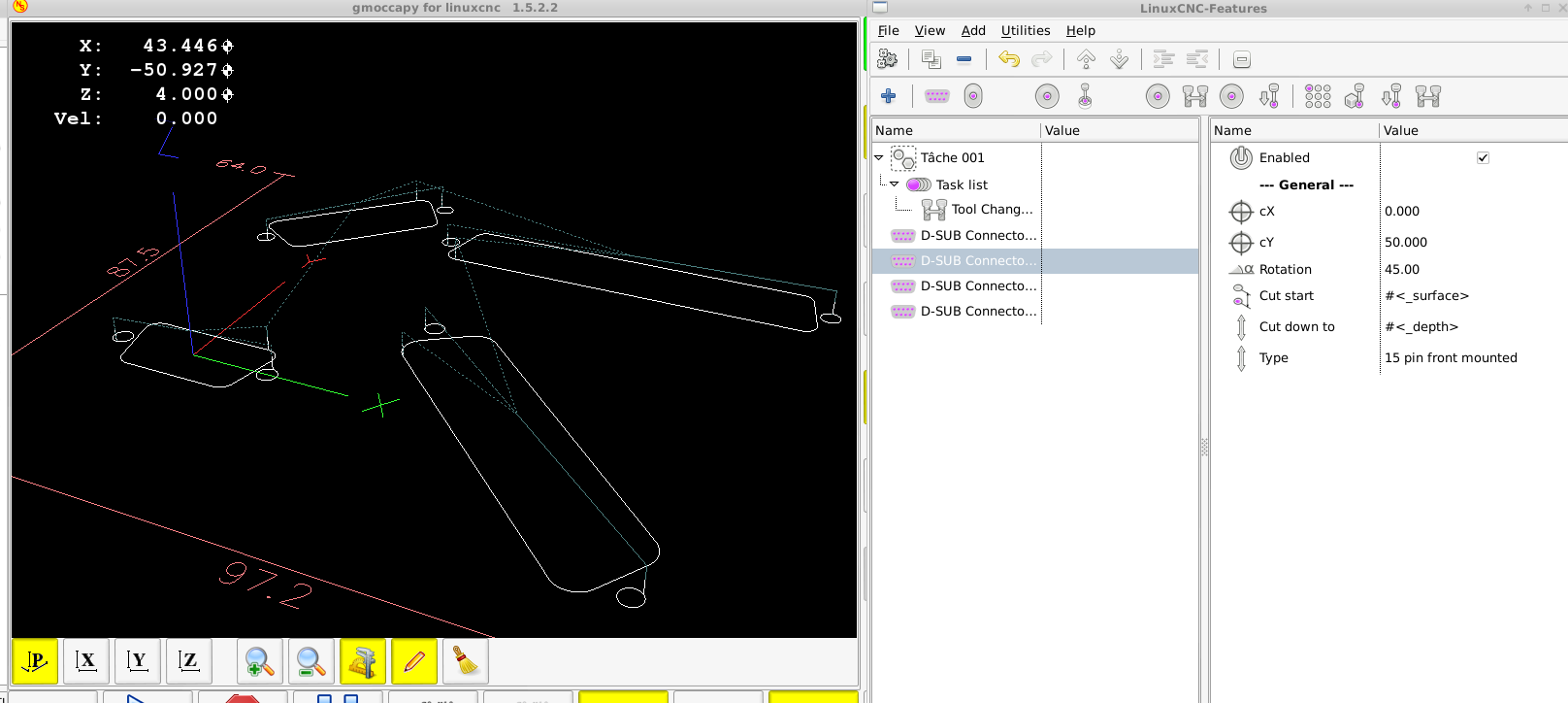

regarding slots, i am not sure but i belive that the problem was that, as you say, the length is between centers, and i was wrongly expecting value between arcs...
I am working on a subrutine for features for cutting out shapes for common d-sub connectors in enclosures. Not what every machinist would need, but there are quite a lot of electro guys with CNCs, I am sure someone will find it useful. I will post it here tomorow, if everything goes OK.
I would also like to propose a small change in GUI: Can you make the Add feature window to not be additional window, but would show the menu in the "value" part of the main window? After you would choose feature to add it would disapear and normaly show values as before. I am using touchscreen and it is not convenient to have additional windows on top of main.
And with touchscreen, taping on a feature or folder doesnt open it, it only selects and i have to press enter to open/add it. Can you do an option for adding a feature with single/double click? User with mouse will propably want double click.
A small popup numerical keyboard wich would show when selecting a value is propably too much to ask, a?
I am learning python, but curently i am not good enought to make that kind of changes in your program...
and you can hide the shortcuts for features, as i personaly never use them, and make upper icons bigger, again because of touchscreen being inacurrate...
Last edit: 06 Sep 2015 01:07 by fixer. Reason: add request

06 Sep 2015 16:09 #62161
by fixer
Replied by fixer on topic LinuxCNC Features - a kind of NGCGUI
As promised, subroutines for D-SUB cutouts. Dimensions for connectors are hardcoded in metric, use tool no larger than 3mm. For imperial units, just recalculate hardcoded dimensions in lines after 17 in ngc, or change into metric before subroutine call with custom G-code.
You can include them in final, but i see no point in this because very few people will find it useful. We could make repository or a new topic for collecting diferent subroutines, what do other users think?
