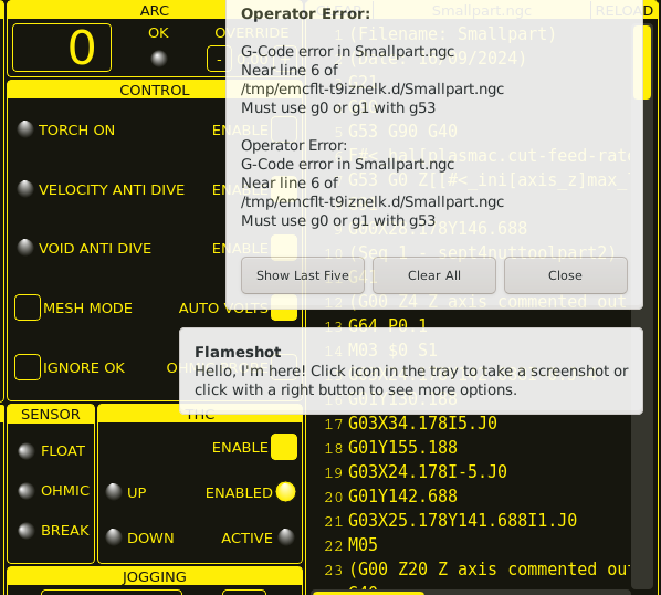

Curious to know if the script for the post processor in qtplasmac worked for anyone?
Currently I am using a different post processor and it runs through a filter on qtplasmac which works ok. But some files it has issues with and I can't use the option to start at a certain line.
So I thought I would try and run this cff to see if it was a better option, using 2015 hypertherm nestmaster.
I used the cff for pronest on this thread. Screenshot and gcode attached.

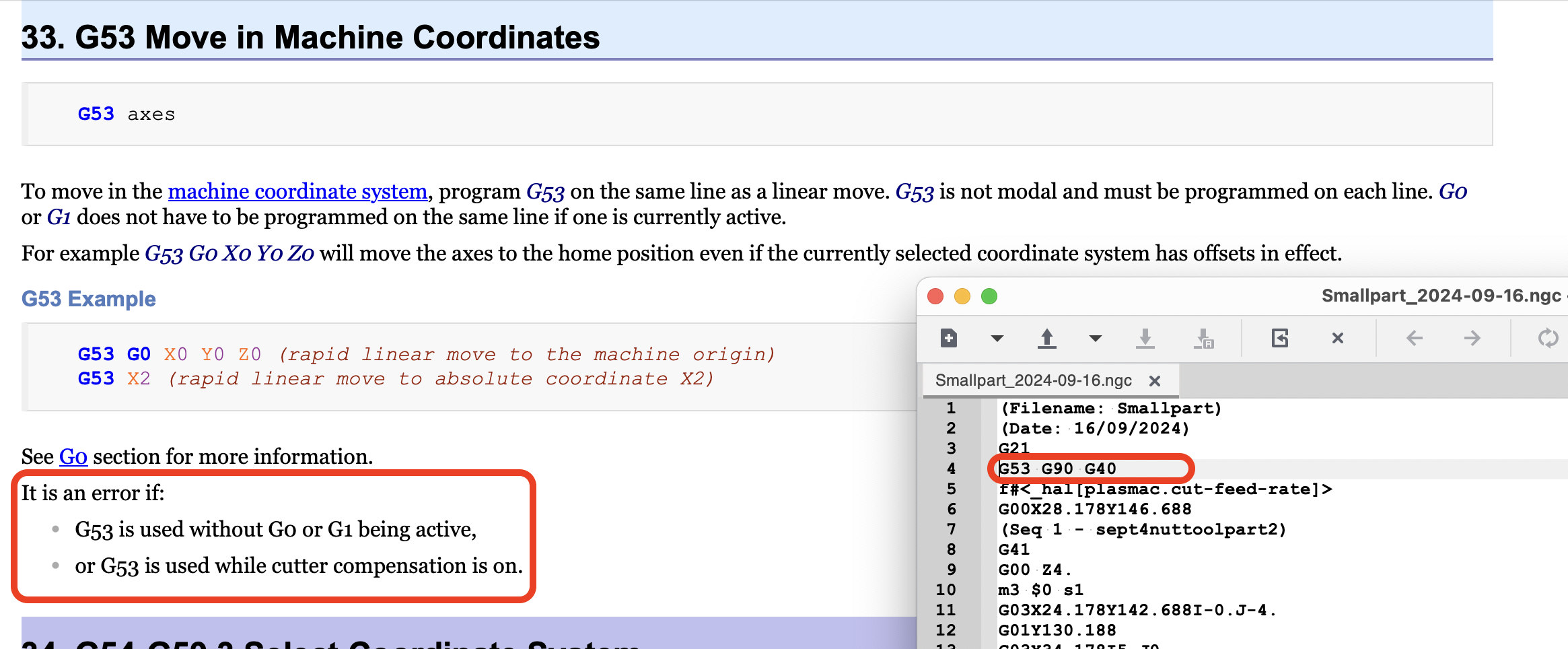

17 Sep 2024 01:36 #310286
by phillc54
Replied by phillc54 on topic Plasmac Post Processors
The error is from line #4 in the original gcode:
linuxcnc.org/docs/devel/html/gcode/g-code.html#gcode:g53

Thanks, got rid of that error but now there is another one.

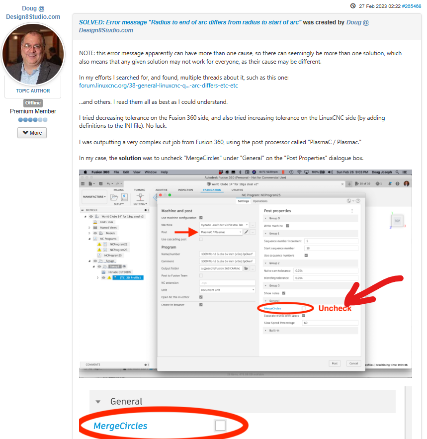

Operator error:
G-code error
Radius to end of arc differs from radius to start:
rel_err=97.5794%
I have attached the error.
I have found a lot about this on linuxcnc forums and the solution given is to change the tolerance in linuxcnc:2.4. [RS274NGC] Section n
It says to add it in the ini file. I can't find where this is meant to go. I tried adding it but it didn't work. I couldn't find this center arc radius tolerance in any of my config files. I tried increasing the accuracy on the cam side but it didn't change anything.
Operator error:
G-code error
rel_err=97.5794%
CENTER_ARC_RADIUS_TOLERANCE_MM =It says to add it in the ini file. I can't find where this is meant to go. I tried adding it but it didn't work. I couldn't find this center arc radius tolerance in any of my config files. I tried increasing the accuracy on the cam side but it didn't change anything.

18 Sep 2024 05:24 #310354
by phillc54
A 97% error seems quite large.
Does the PP output the I & J values as absolute or incremental distances? The LinuxCNC default is incremental.
linuxcnc.org/docs/devel/html/gcode/g-cod...ml#gcode:g90.1-g91.1

I am having the same problem with "Radius to end of arc differs from radius to start" with a +90% error rate, using the fusion 360 post. I am able to post out some parts that will run and some that dont. All of theese have previosly been run with no issues on a Mach3 plasma with the same cut settings. Files 1001 and 1005 runs fine. But not 1002 and 1006? Any idea on how to fix this?
- Bjornstabo
- Posts: 3
11 Mar 2025 17:24 #323693
by Bjornstabo
Replied by Bjornstabo on topic Plasmac Post Processors
SOLVED: Doug solved my problem, now it works great!

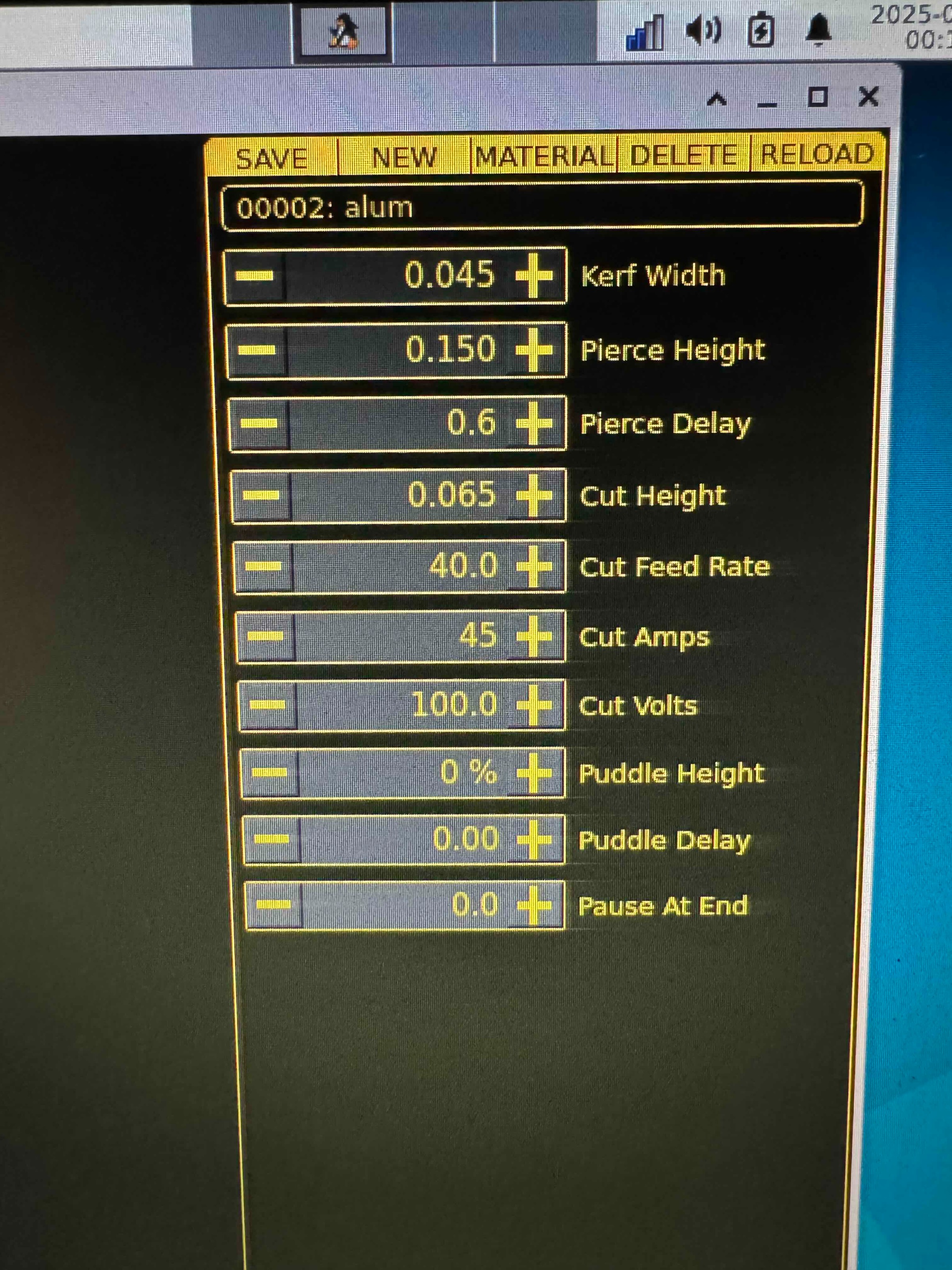

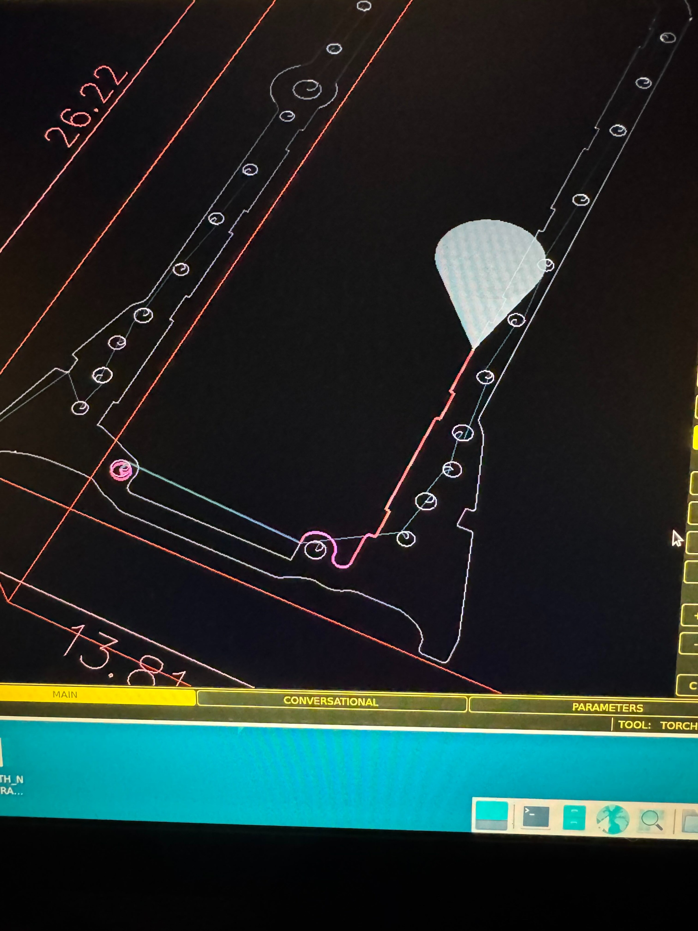

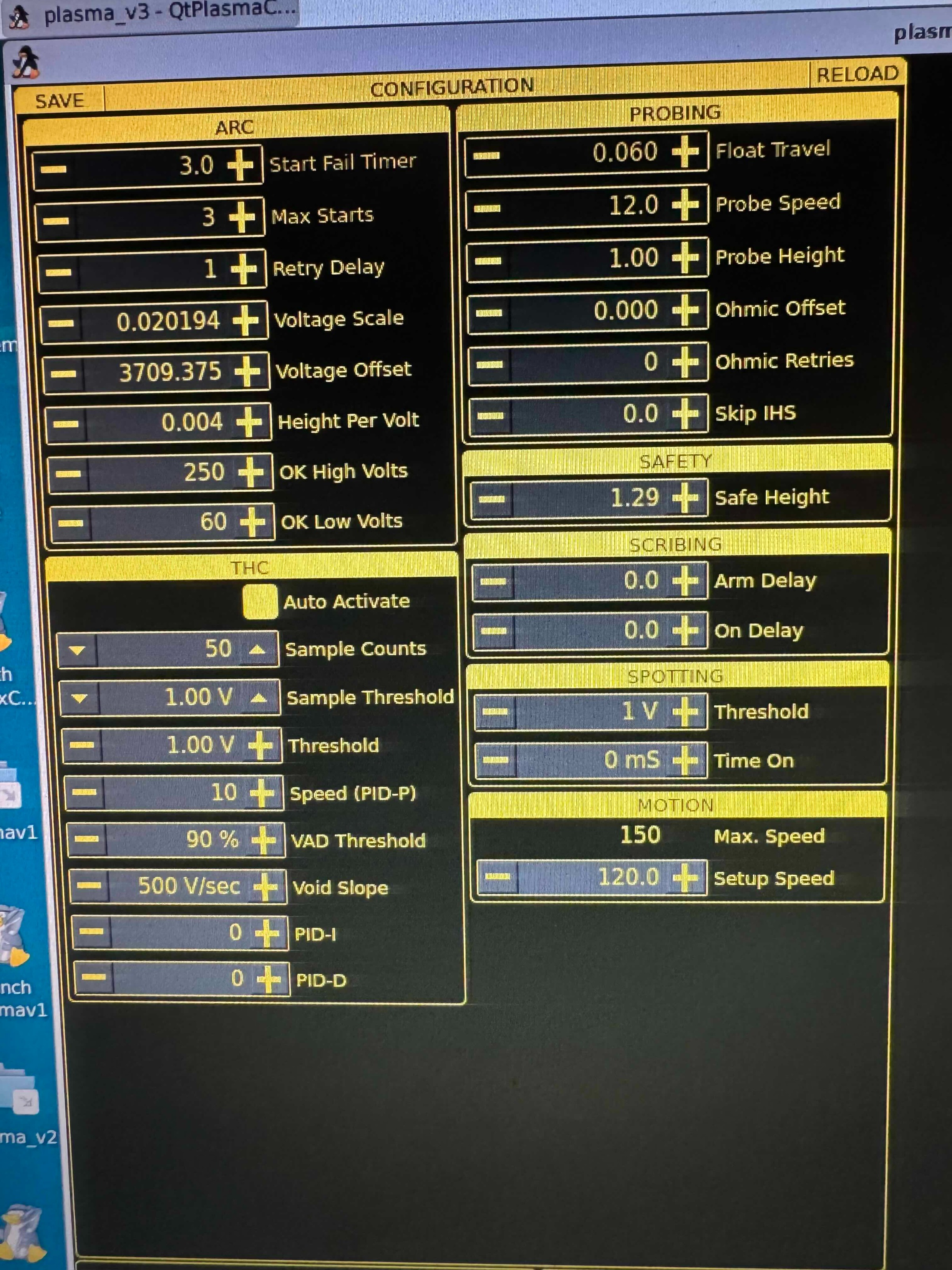

Hello All, I'm using this post processor (PlasmaCv2.1) in Fusion 360. My issue is that my first round hole in the gcode cuts no problem, machine come downs and probes, makes a perfect cut and then the Z axis rises 1-2inches and continues along the path in the gcode but doesn't come back down to start the plasma arc, it just runs the whole program without coming back down to initiate arc and cut the material. I don't get an "arc okay" error which is odd .I went back into Fusion360 and set my retract height and clearance height to 0 to see if that would help and maybe the THC via THCAD through a MESA 7i76 board would work but it just gave me an error. "Safe Traverse Height has been reduced to 0.23in"
Images attached of my cut parameters ,material properties , gcode from Fusion 360 and some misc info.
The machine cuts simple parts using the conversational in QTplasmaC no problem, and my THC works so I've isolated it to the Fusion 360 Gcode and unsure how to fix my issue. Possible bug maybe?
I feel like I'm doing something really dumb and overlooking something really simple, in an effort to not waste another couple days going in circles, could anyone point me in the right direction, i greatly appreciate it!
