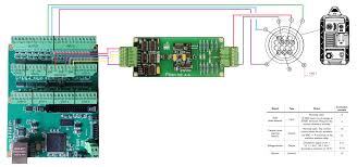

So I just tried the new file, still getting wild fluctuating voltage readings from 120-160 When the machine is sitting idle. I’ve tried going over every connection and it even does it with the thcad unplugged from the 7i96 board. With the thcad unhooked it does vary more scrolling from 20v to 8-900

Update**
When cutting with settings of 115v on the thc the voltage read from 240-270 constantly varying like it does at idle.

Compress the configuration folder and attach it here, screenshots of run and config panel, pictures of how the THCAD is wired and to what it is connected, etc.

Sorry for the delay i have been away from the shop, attached is my configuration file as well as a copy of an image i found on another forum that i used to wire my thcad10. Machine still shows wild voltages on the thc even if i completely disconnect the thcad.
