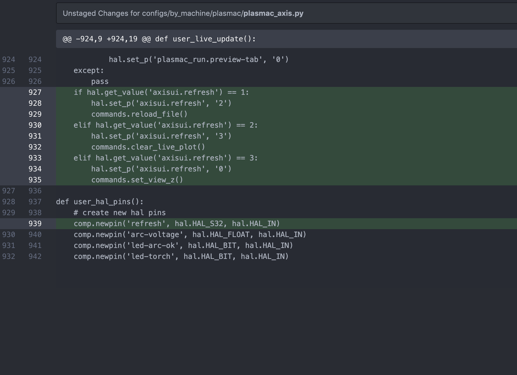

so I am guessing axis_remote --reload is not the proper way to send this command inside of the plasmax_axis? commands.reload doesnt appear to work either lol
Replied by snowgoer540 on topic Custom user Button Touchoff in Axis
All the code for this needs to be in plasmac_axis.py, you should be able to find in there where HAL pins are created and also the function that runs every cycle.Give me one quick nudge here please... where is the proper place to establish the "axisui.refresh" HAL pin? Hal connections file?

I must be doing something wrong.
I'm trying to take this in baby steps so I don't have too much go wrong at once.
doesn't seem to do anything. Edit: my ini file is setting that pin to 1, I confirmed that.
I did figure out that the rest of the needed commands are:
Then I just need to figure out how to increment...something...so that it does each every cycle.
Close, commands.reload_file() does the trick. You can look in axis.py for all those commands.
if hal.get_value('axisui.refresh') == '1':
commands.reload_file()doesn't seem to do anything. Edit: my ini file is setting that pin to 1, I confirmed that.
commands.clear_live_plot()
commands.set_view_z()Then I just need to figure out how to increment...something...so that it does each every cycle.
Last edit: 07 Sep 2020 07:24 by snowgoer540.

After the == remove the both the ' from the 1, that denotes text and it is an integer.
Yep, they are the correct commands
hal.set_p will set a HAL pin

I cant get it to do any one of these things... I think the snakes must be feeling particularly lazy today. I thought I had to use S32 pin to be able to use values other than 0 and 1. But when I do that, it doesnt change the value to 1. This must be like watching a toddler learn to crawl
if hal.get_value('axisui.refresh') == 1:
hal.set_p('axisui.refresh', '2')
if hal.get_value('axisui.refresh') == 2:
hal.set_p('axisui.refresh', '3')
if hal.get_value('axisui.refresh') == 3:
hal.set_p('axisui.refresh', '0')
Last edit: 07 Sep 2020 08:30 by snowgoer540.

Change the second two from if to elif so it doesn't run them one after the other in the same cycle.
Do the hal.set_p lines before the commands lines.
You do need to start LinuxCNC each time you change this file.
That's all I can help with tonight, see ya tomorrow.

Got it working! I've been sitting here for a few hours, but I learned a lot, and good news is I can move on with the day now
For instance, I learned that you cant use tabs, after beating my head against the wall for nearly an hour... tab does not equal 4 spaces lol
I would imagine Phill will push this (if he hasnt already), but to do this, you need to add the following code after line 816 (not 100% sure this is the best place to add it):
Then you need to add a pin in the add a pin area (before comp.ready()):
Lastly, your button code in your ini file becomes:
well, I can crawl a little further now than before...
elif hal.get_value('axisui.refresh') == 2:
elif hal.get_value('axisui.refresh') == 3:
hal.set_p('axisui.refresh', '0')Then you need to add a pin in the add a pin area (before comp.ready()):
comp.newpin('refresh', hal.HAL_S32, hal.HAL_IO)Lastly, your button code in your ini file becomes:
G10 L20 P0 X0 Y0 \ %halcmd setp axisui.refresh 1well, I can crawl a little further now than before...

Can you set up whatever IDE/editor you are using to use spaces instead of tabs?
Edit: HAL_IN for the pin would be ok.
Replied by phillc54 on topic Custom user Button Touchoff in Axis
Great work, now all you need to do is add it into the user guide, create a new branch and submit a PR.Got it working! I've been sitting here for a few hours, but I learned a lot, and good news is I can move on with the day now
