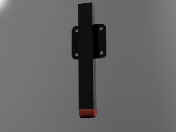

25 Sep 2020 07:17 - 25 Sep 2020 07:21 #183687
by pinder
Replied by pinder on topic IHS sensing with Capcitive sensor
Sensors can be mounted like this.
To make sensing fast offset should be minimum and in one direction only x or y.
protective cover open
cover closed
opening and closing of the lid can be made pretty fast.
sensor mounted at the bottom can be protecting from dross easliy.
I want to clarify, this is only for IHS. still Voltage THC will be needed.l

25 Sep 2020 08:03 - 25 Sep 2020 08:03 #183691
by pinder
Now I am going to use laser sensor for two reeasons,
1) those are accurate, IMHO atleast for IHS.
2) we dont have to move z axis for probe.
steps:
z moves rest height
offset applies and sensor comes at plasma position,
lid opens, sensor takes reading, close the lid
offset removes and plasma torch comes at its postion
reading is sent to plasmac
it calculates current work position, applies pierce height
torch starts cutting
I know, not for sure, this is less than 2 second process.
