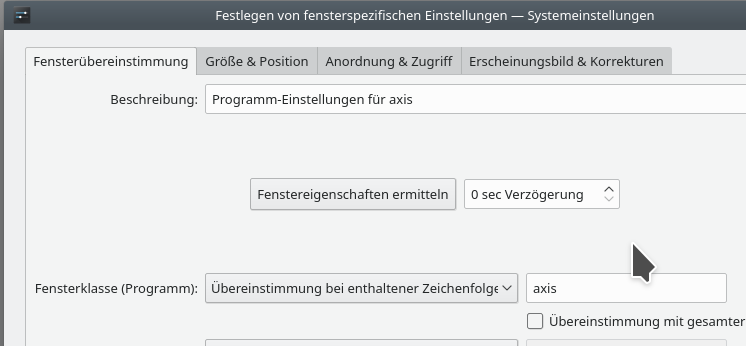

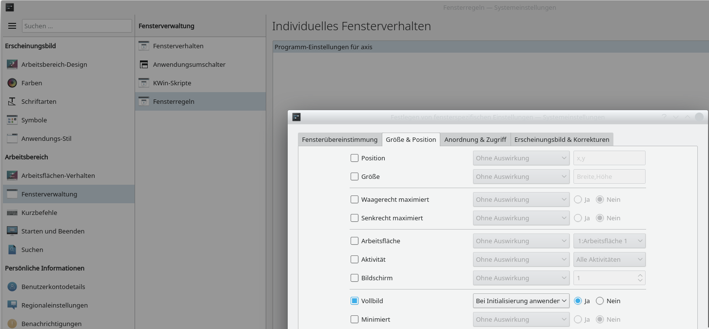

03 Nov 2022 10:14 - 03 Nov 2022 10:21 #255829
by seuchato
Replied by seuchato on topic Start in Fullscreen Mode
Hi all
For those of you, who use KDE/plasma:
- in system settings (Systemeinstellungen), window management (Fensterverwaltung), Window rules (Fensterregeln) add the following rule:
- Make it work for programs that have the matching string "axis" in their window title:
For convenience, I add the rule as .zip file. You can simply import this.
Caveat: this rule applies to all windows that contain the name axis!
hth
chris
Last edit: 03 Nov 2022 10:21 by seuchato. Reason: wrong pic referenced
