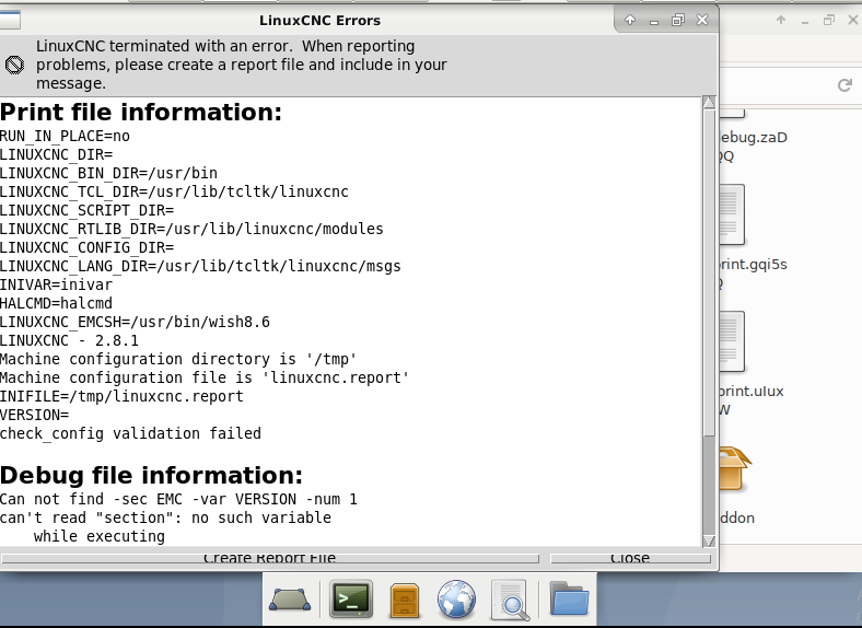

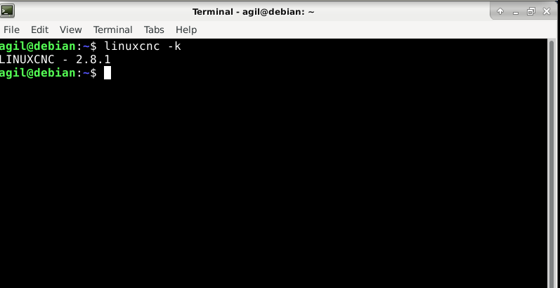

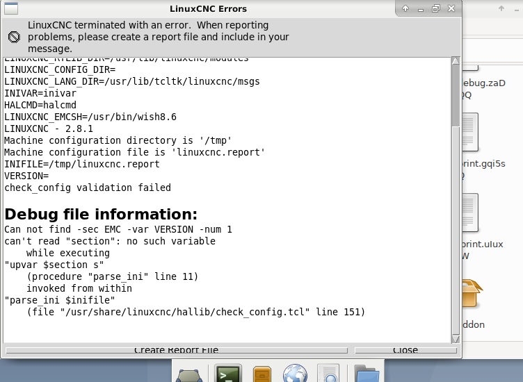

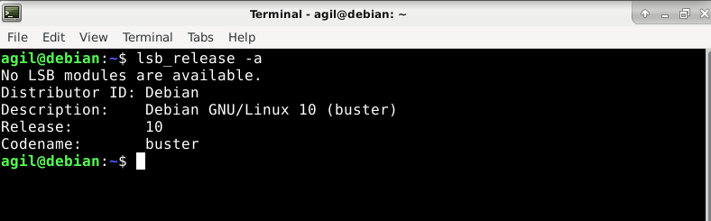

08 May 2021 02:29 #208281
by Aqeel
Replied by Aqeel on topic Help install "QtPlasmac" !!
these are some screenshots,
please you can help me with fee?
because its almost the best solution.
i will send you remote access data..ok?
thank you

- phillc54
- Posts: 5711
- Thank you received: 2100
08 May 2021 02:33 #208283
by phillc54
Replied by phillc54 on topic Help install "QtPlasmac" !!
I get the same as the first pic, I don't think that is an issue.
The second pic can be fixed by following this page:
buildbot.linuxcnc.org/
Use the stanzas at the top of the first table.

- Posts: 21801
- Thank you received: 7448
08 May 2021 08:33 #208287
Replied by tommylight on topic Help install "QtPlasmac" !!
Running a config from the /tmp/ folder, why ?
Copy the config to the configs folder then try again:
/home/USER_NAME/linuxcnc/configs/
