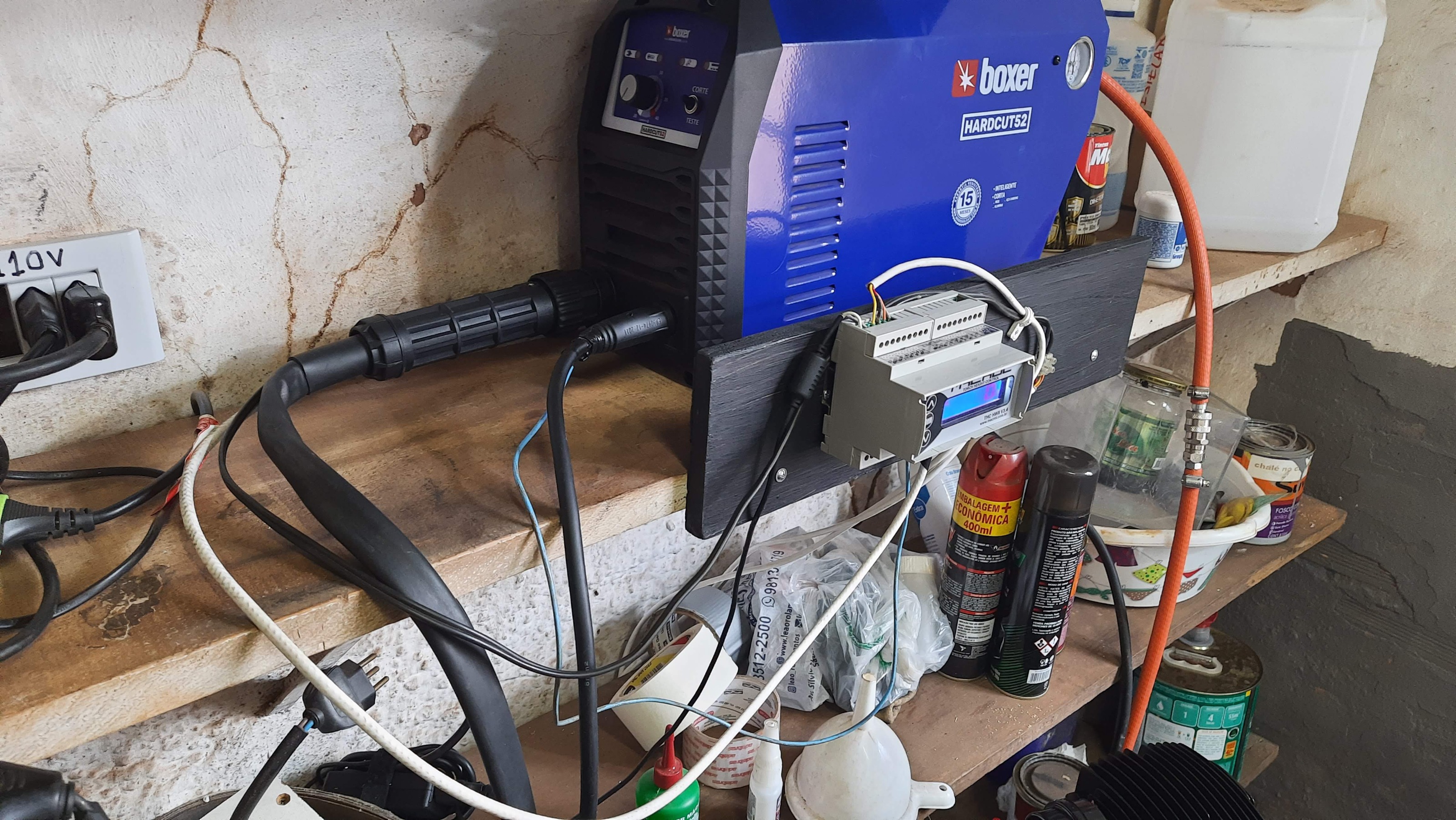

After initial setup, I have wired the external THC with my parallel port controller and my plasma source, it's is a blowback type torch. My THC has a internal divider so I plugged negative and positive straight from euro connector.
Problem is I'm getting "valid arc lost". I guess it happens after THC starts sending UP/DOWN to QTPlasmaC,  because if I set THC "Delay Arc" to 1.5 sec, arc lost happens at 1.5 sec.   In the video below  THC setting "Delay Arc" was 0.5s (I know, too low, but it happens no matter the value, it only postpones the error)
I'm also getting "Probe tripped during non-probe move" but I think that is because the THC is making the torch go DOWN.
If I disable THC, it cuts ok.
The test material is 0.8mm galvanized steel. Tried several combinations of pierce height and cut height. Using 20Amps and 5 cfm.
My Arc-OK UP and DOWN cable is shielded and grounded.
Could you point me the things I should try setting and testing ?  Thanks.

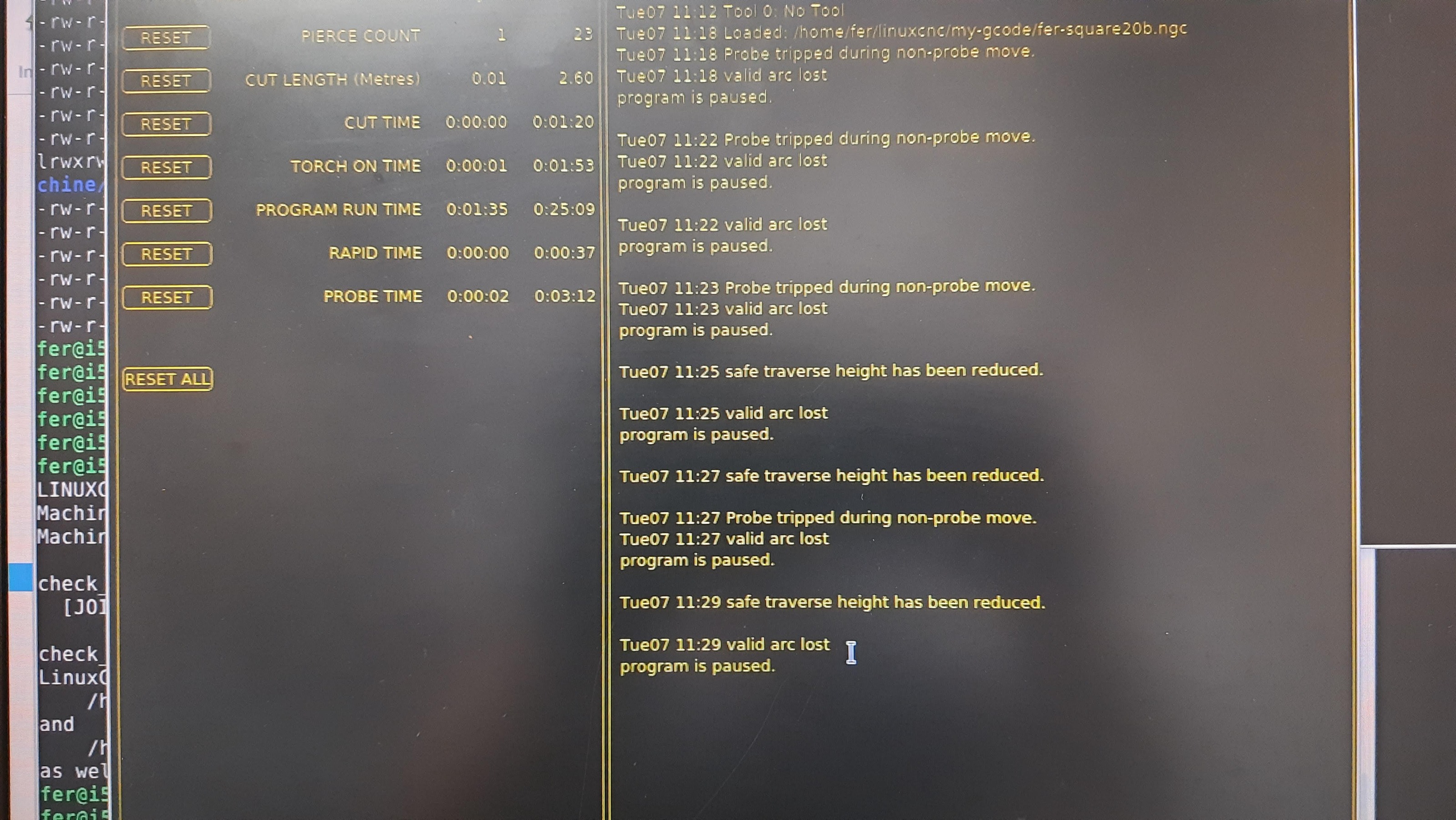

07 Sep 2021 15:03 #219878 by fernandosf
Replied by fernandosf on topic QTPlasmaC mode2 - valid arc lost
This is the TCH view of the failed cut:
This is the QTPC view:

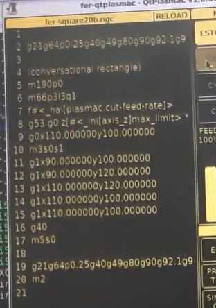

08 Sep 2021 06:42 - 08 Sep 2021 06:46 #219928 by fernandosf
Sorry, I can't because I'm off site now.
But it is a simple conversational 20x20mm square
If it helps, you can see the g-code in the youtube video above.
Last edit: 08 Sep 2021 06:46 by fernandosf. Reason: added screenshot
