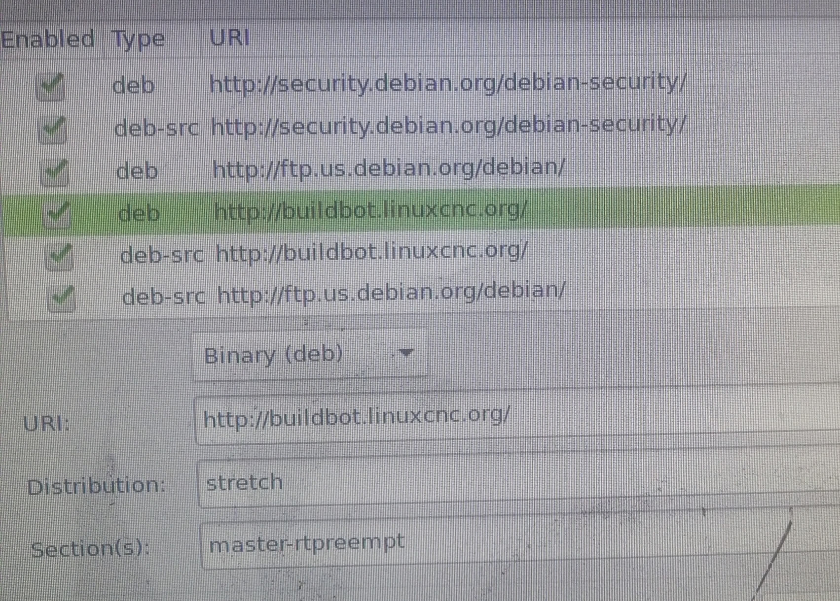

I did the update with apt update as indicated but I do not get the update, did a migration from Plasmac to qtplasmac do I have to use the qtplasmac-qtplasmac2qt option again for it to update or why is it not updated?

18 Oct 2021 10:45 #223468
by snowgoer540
I am guessing you are on Stretch, or have your repositories pointed toward the Stretch sources. If you give me more info about what distribution of Linux you are on, maybe I can help point you in the right direction...
Replied by snowgoer540 on topic Qtplasmac Framing velocity

18 Oct 2021 10:59 #223469
by paulsao
Replied by paulsao on topic Qtplasmac Framing velocity
Thanks, I am using debian 10 linux 2.9 and in the attached image my repository. It's weird because Plasmac updated the same way and it worked.

18 Oct 2021 11:10 - 18 Oct 2021 11:32 #223470
by snowgoer540
The distribution is pointed to Stretch. It needs to be set to "Buster" for both the deb and deb-src. Then it will update. You will have to uninstall Linuxcnc before doing that and reinstall it afterward. It should not affect your config.
The last supported version on Stretch was the version you are currently on.

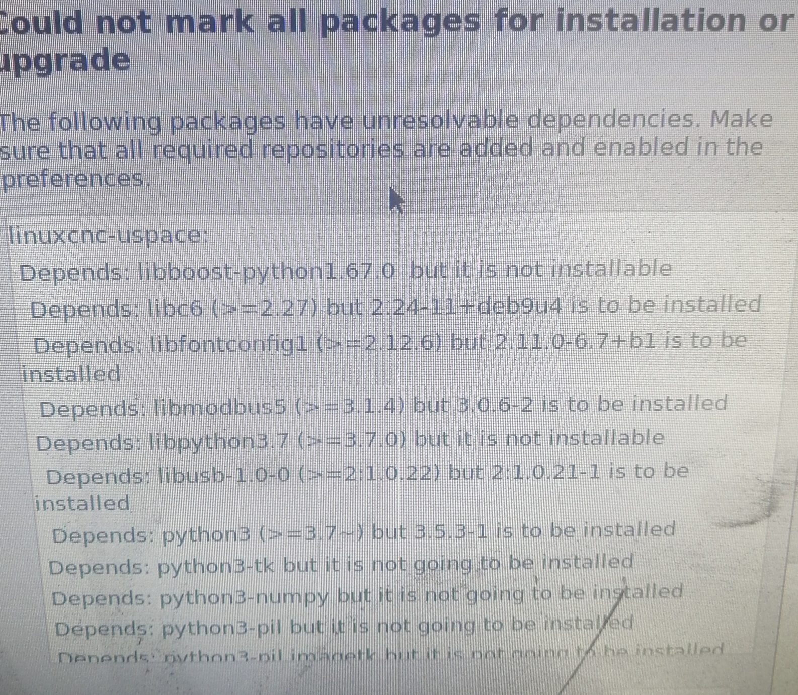

18 Oct 2021 12:12 #223478
by paulsao
I have some packages that are not installed, for installation over some missing dependencias.
