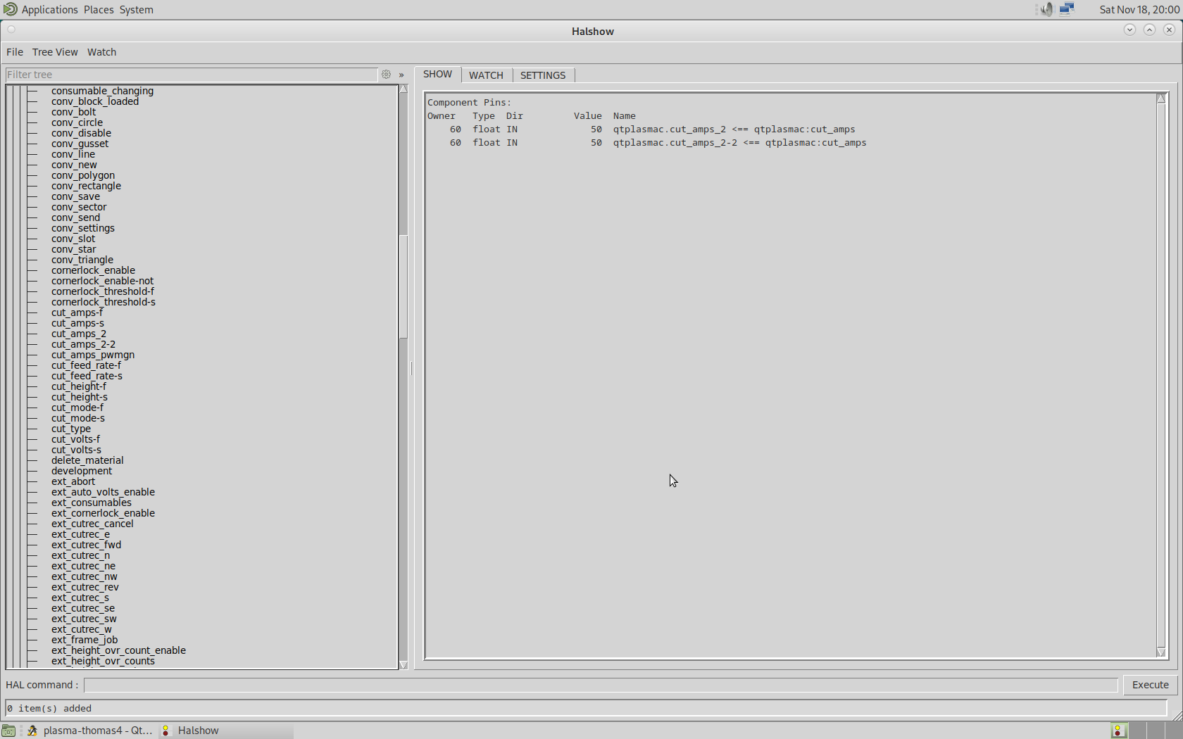

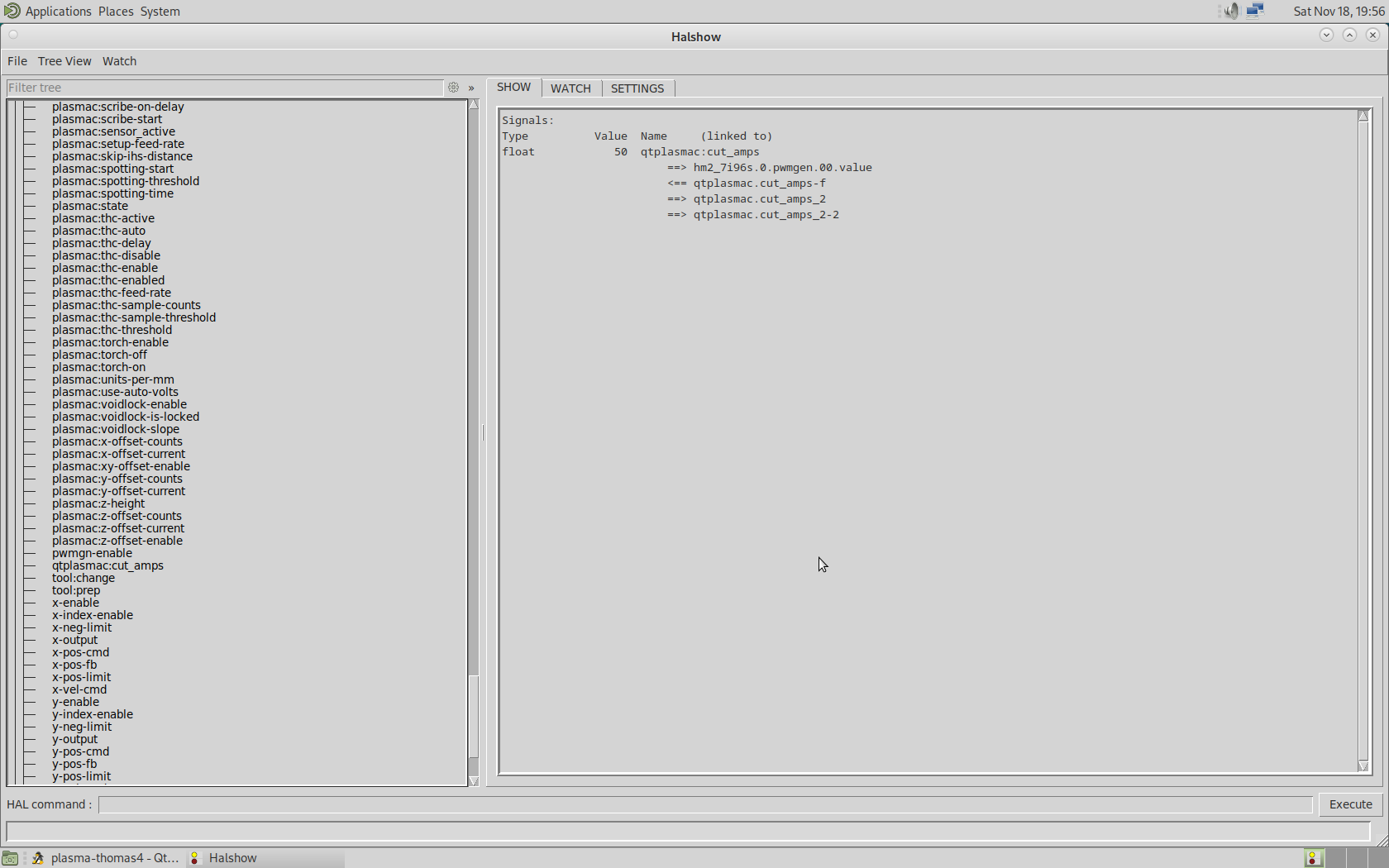

Hallo phlllc54
my very very big thanks
what you have achieved is highly appreciated
It did take a lot of work
The program fulfills my wishes and it works very wellThe thing with the pin is curious
I've attached the hall shows
king regarde and very very big thanks
Juergen
Juergen
