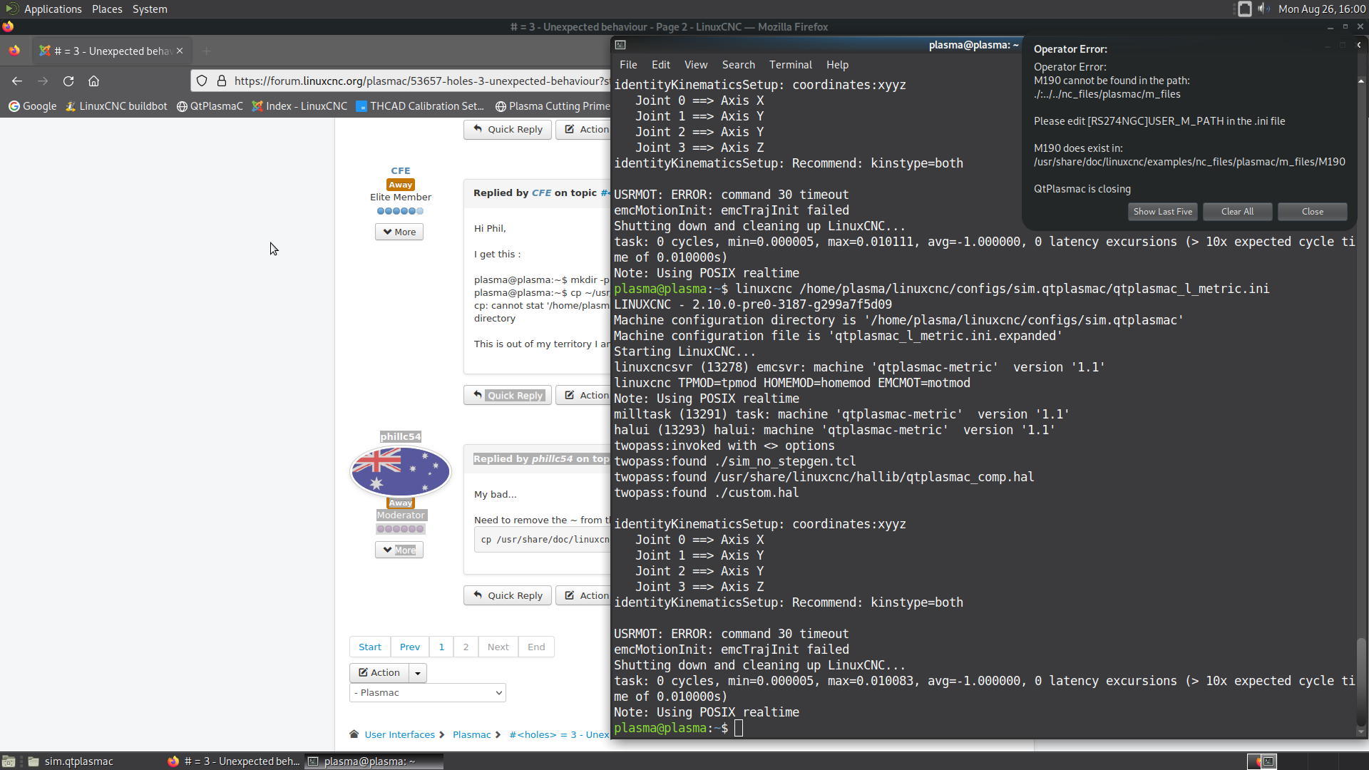

Replied by phillc54 on topic #<holes> = 3 - Unexpected behaviour
There must be an issue with pathing differences between package installs and run in place installs...
Try this as a workaround from a terminal:Then restart linuxcnc again.
mkdir -p ~/linuxcnc/nc_files/m_files
cp ~/usr/share/doc/linuxcnc/examples/nc_files/plasmac/m_files/* ~/linuxcnc/nc_files/m_files/Please Log in or Create an account to join the conversation.

Replied by CFE on topic #<holes> = 3 - Unexpected behaviour
Hi Phil,
I get this :
plasma@plasma:~$ mkdir -p ~/linuxcnc/nc_files/m_files
plasma@plasma:~$ cp ~/usr/share/doc/linuxcnc/examples/nc_files/plasmac/m_files/* ~/linuxcnc/nc_files/m_files/
cp: cannot stat '/home/plasma/usr/share/doc/linuxcnc/examples/nc_files/plasmac/m_files/*': No such file or directory
This is out of my territory I am afraid
I get this :
My bad...
Need to remove the ~ from the beginning of the second line:
cp /usr/share/doc/linuxcnc/examples/nc_files/plasmac/m_files/* ~/linuxcnc/nc_files/m_files/Please Log in or Create an account to join the conversation.
No success Phil, I still get the M190 related error, see screenshot attached. I must admit I have never used sim configurations, so this is out of my depth
