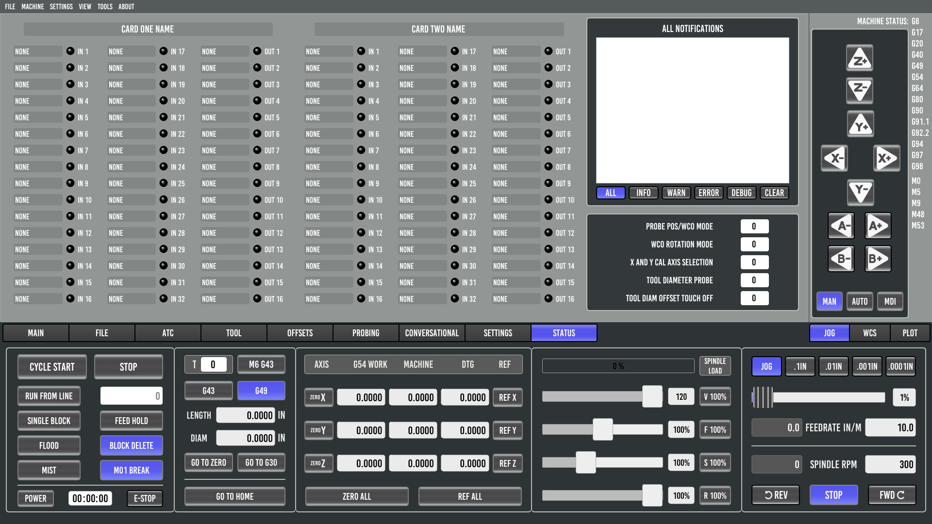

looks better, is probe basic opening now?
if so what is on the status page? trying to determine which version of probe basic you have installed and if it is the latest master or a previous tagged version, it will determine if the post gui hal file is correct.

Yes sir everything is working okay. Even before those hal and ini file fixes it was working. A screenshot of the status window is linked below. Ive even got it running the steppers using the conversational window. Having a latency error come up so thats next step getting it working reliably. Even after the issue the gcode continues to run just fine. Project for tomorrow me.

06 Mar 2022 06:08 - 06 Mar 2022 06:09 #236484
by Lcvette
Replied by Lcvette on topic Probe_Basic Install
Ok so you need to change the post gui hal file call in the ini to match what is in the configuration folder for probe basic, i think it's probe basic post gui hal, but check the sim folder and make sure it's in your current configuration. It's for the latest version which appears you have installed.
