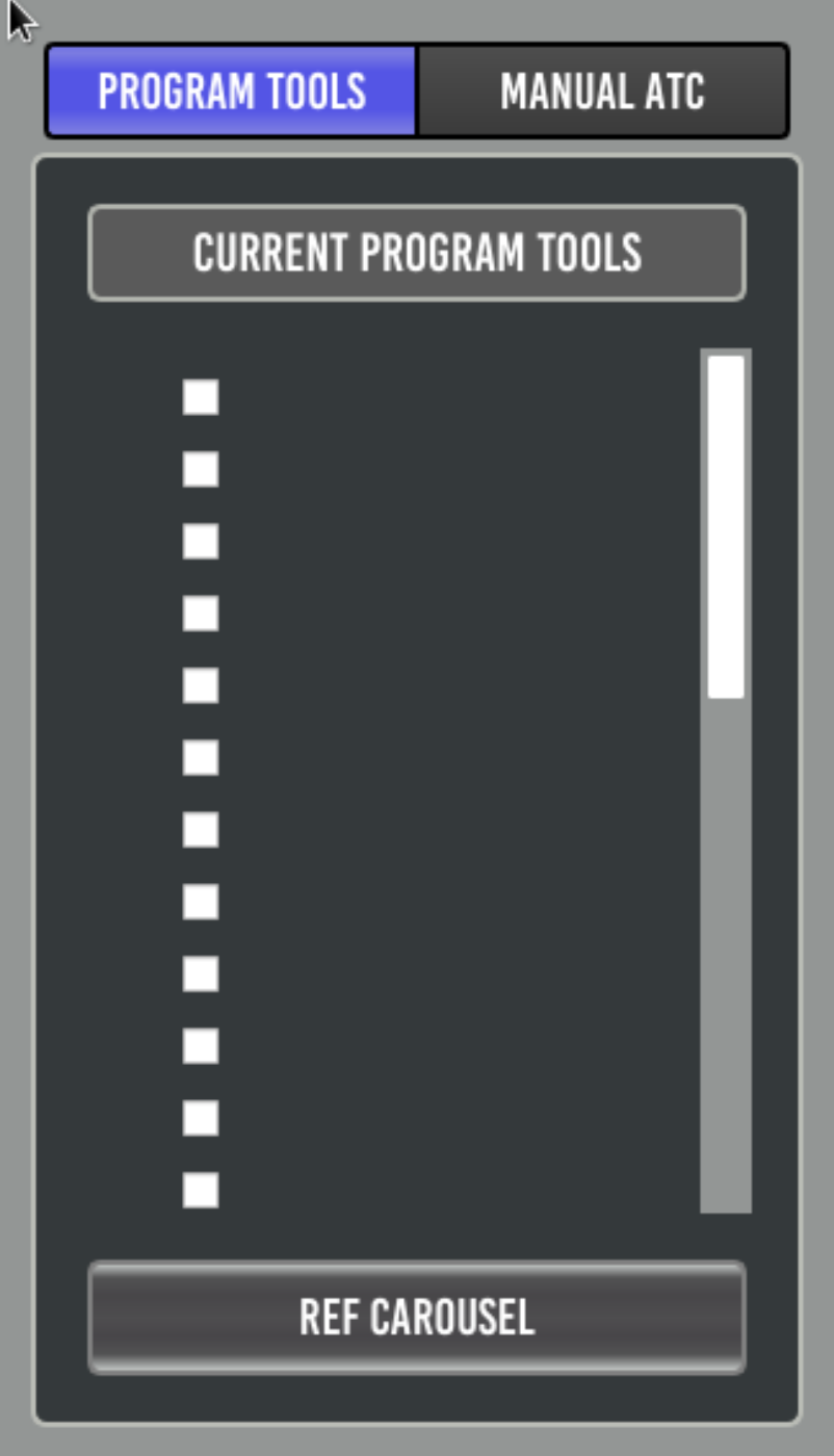

09 Dec 2023 14:18 #287660
by dpslwk
Replied by dpslwk on topic Probe_Basic ATC Tool List
Once you have update to the latest probe_basic apt install you should have the latest ui
the new "Program Tools" tab (under ATC) should look something like this when no program is loaded
when you load a program it should populate with a list of T numbers
if your not seeing the above, your update may not have work, or you have not told us that your running some thing more than just an apt install (dev? custom ui changes? etc)
more info you give in a in a post the more someone can help
