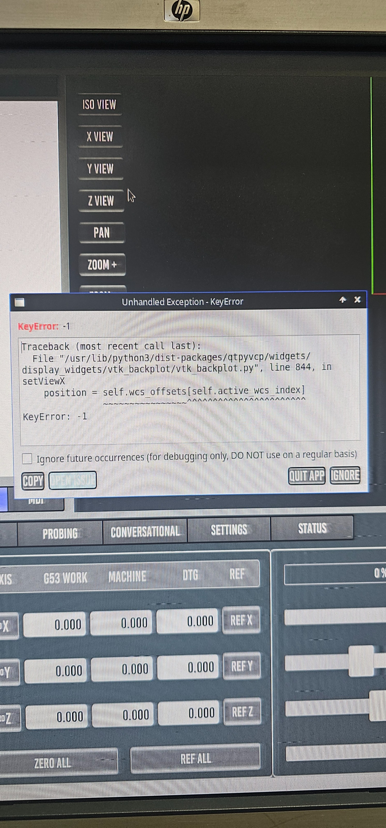

Replied by dpslwk on topic Probe Basic Transition from Axis
seem you have moved all the HAL around trying split into multiple files??
and in doing so you have commented out the command that are setting up the mesa card (realtimecomponents.hal)

This is now my config. I already can open it. But it looks like there are something missing.
Replied by OldSQL on topic Probe Basic Transition from Axis

If I configure it with only 1 hal file, will it be better?
Isn't this a Probe Basic bug?
- Posts: 12158
- Thank you received: 4150
23 Dec 2023 20:50 #288945
Replied by rodw on topic Probe Basic Transition from Axis
Just keep commenting out pins until it opens and review for the correct pin names.
Linuxcnc always tells you the file and line number the error is on.
Typographic errors like this are not linuxcnc or probe basic bugs. They are on you.

I ran into this very same error message, solved it by moving the initialization of my custom hal code after the postgui stuff for probe basic.
