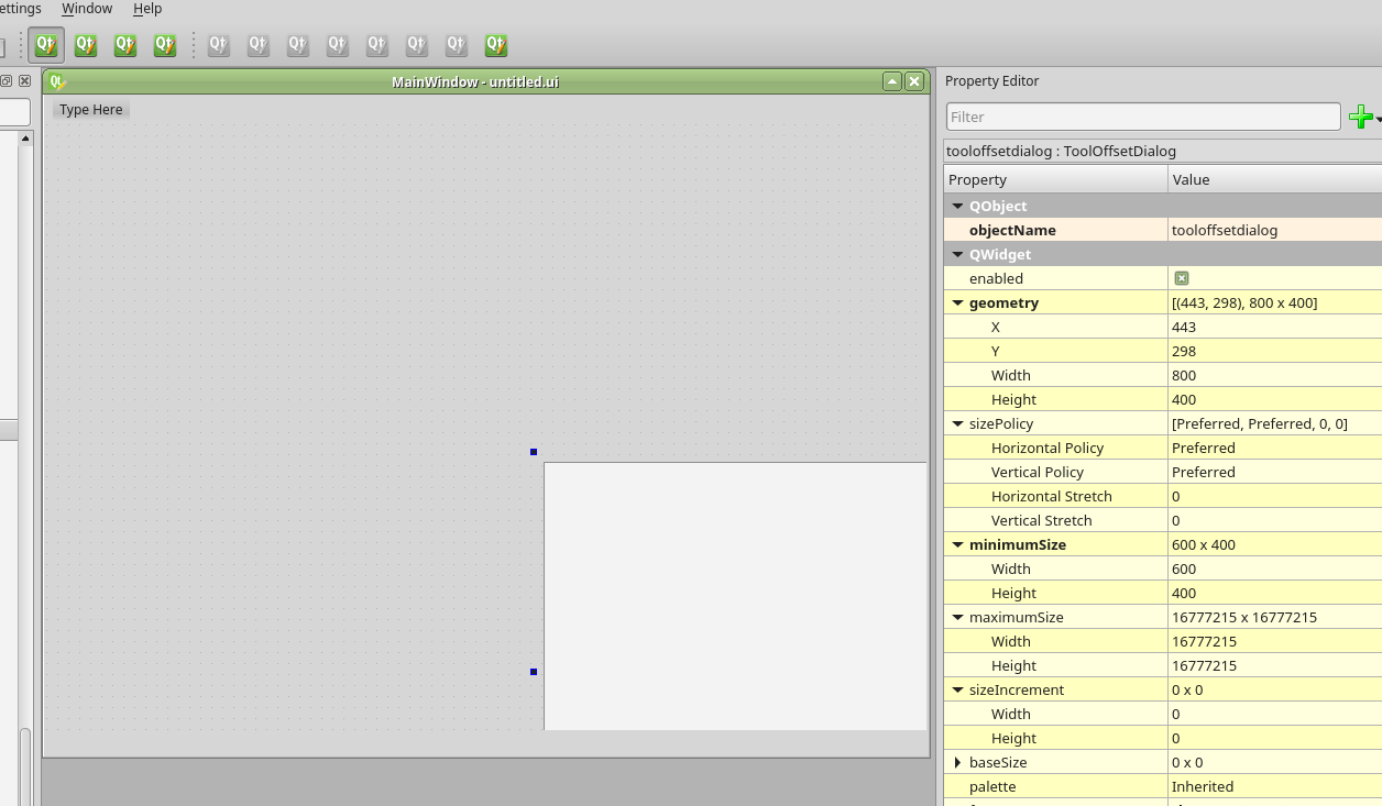

I have some issues with these dialogues: filedialog, camviewdialog, _macrotabdialog, originoffsetdialog and tooloffsetdialog. The problem that has appeared is that they will not keep their desired positions in a frame. I can set the geometry position to x0 and y0 and they move to those positions. Close the the .ui file and bring it back up and they are no longer where they should be, x0 and y0.
What I found is that they have pre-set positions and use those each time they are reloaded. Thus they end up hiding under other frames of my gui and can not be accessed. My tests have shown that they only like to be in below positions.
filedialog x577 y298
camviewdialog x677 y298
originoffsetdialog x687 y375
tooloffsetdialog x477 y375
_macrotabdialog x577 y298

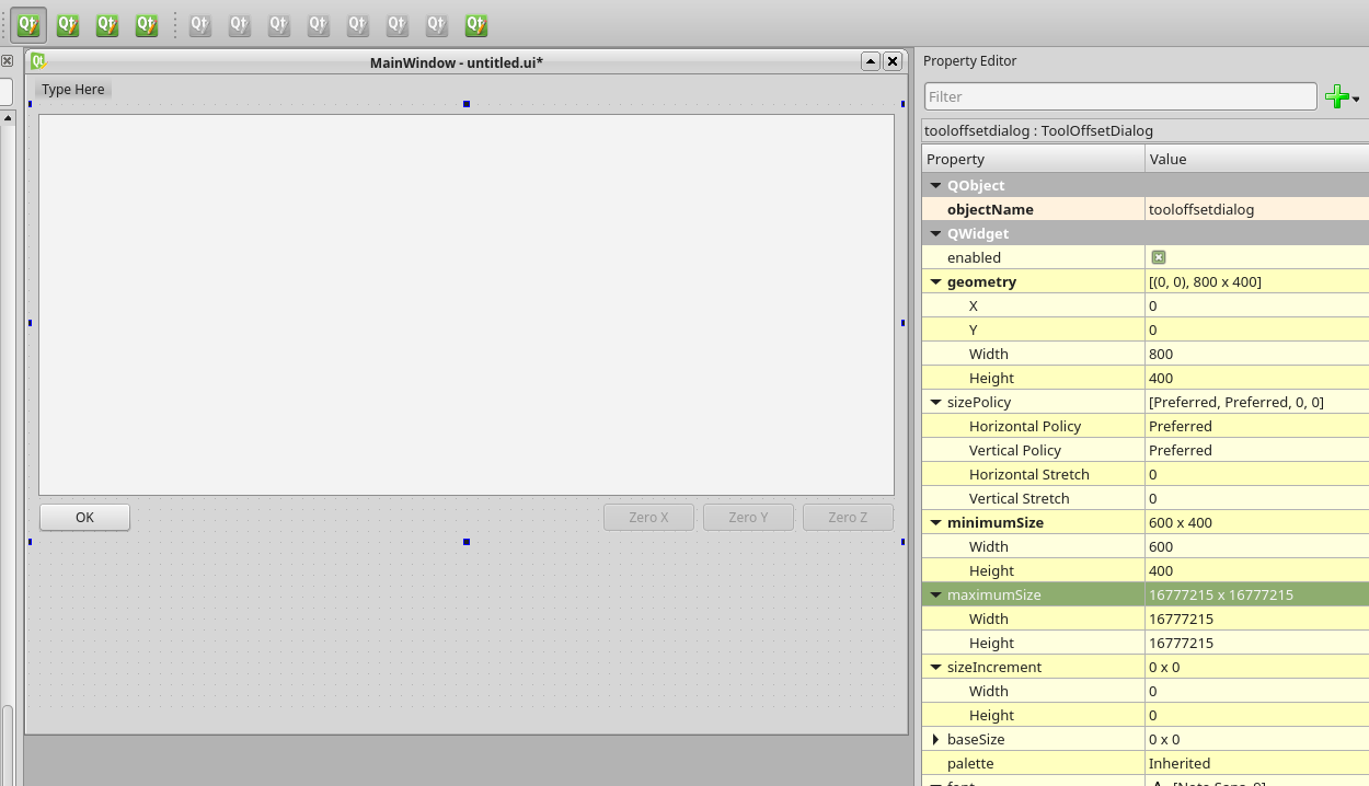

When I place them in a new MainWindow at x0 and y0, and then save the file, close it and re-open it that is were they end up. My attached files shows this. Test1.png shows the x0 y0 position and test2.png show the position after closing and opening the test .ui

I had a large response for all your questions but then managed to erase it so I'll be brief. ask for details of what suits you.
*graphics clearing action:
set the action button properties:
view_change_options; true
view_change string: clear
*virtual keyboard
The soft keyboard of the MDI line can be turned off - there is a property for that.
Is it just the layout that you don't like? - that could be changed.
You can use Onboard or matchbox in a couple different ways.
There is a library for it is qvcp/lib/virtual_keyboard
This would be set up in your hander file but it would be a floating above keyboard.
Or you can use the XEmbed widget to embed a keyboard.
The command to load onboard is: onboard --xid
the command for matchbox is: matchbox-keyboard --xid
You must make sure the XEmbed widget is at least large enough for the minimum size of the keyboard.
I haven't done either of these is a while so there may be little things...
The sample config qtdefault_ngc uses XEmbed so I know it works in principle.
*Dialogs
I think you are placing the dialogs on your main widget hoping that is where they will show.
Not unreasonable but that is not how they were intended.
In fact I make them as small as possible and add them anywhere -
there is a property 'state' that is used to hide them in designer to get them out of they way.
They are programmatically made to find the size of the main screen and place them either in the middle of the bottom left IIRC.
I always intended to give them size/location memory - probably using the preference file.
I would read the size/location when they close and record it - does that sound right?
You could override the load_dialog function of each dialog and do what you like (it's a bit hacky)

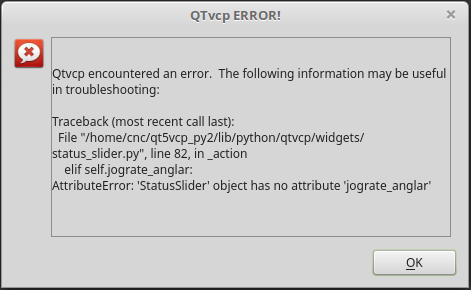

My guess is I changed the property name and you need to update - you would see it as your old properties being call dynamic properties...
Chris M

I will check for a property change.

yes -i'll push the fix soon
