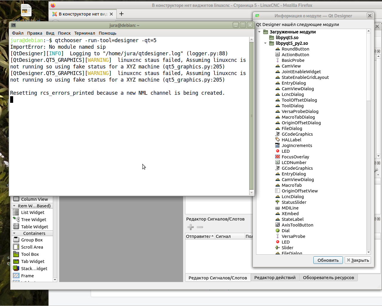

Yes 1280 x1024 woodpecker finish. QtDragon + functionality. There are two more sizes, 1024x768 and 1920x1080. It remains to rename from qtdragon in woodpecker. QGroupBox created in Desinger 5.7 Debian9 does not display correctly on Debian 10.

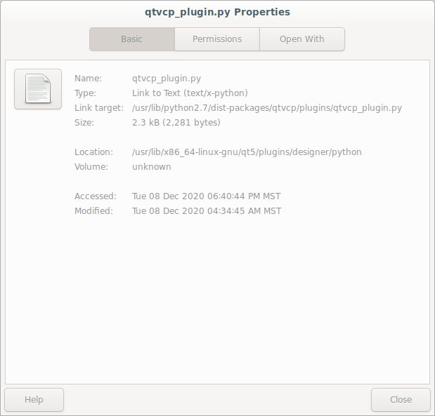

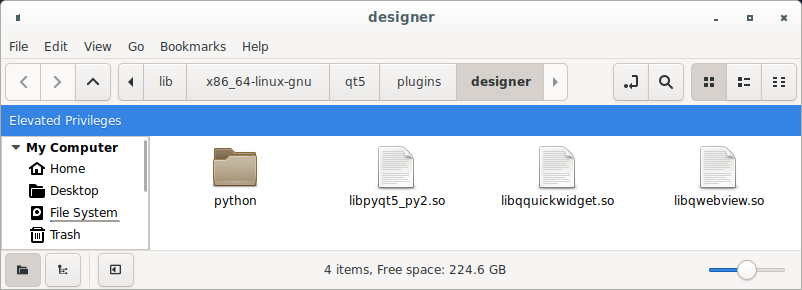

I hate to bring this up again, but my laptop blew up and I had to reinstall everything from scratch. The only problem now is qtvcp widgets not showing up in designer. Here's the contents of the plugin folder:
Following the link in the python folder takes me to the correct location in the qtvcp libraries.

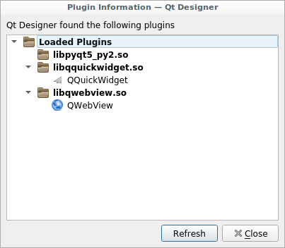

Replied by cmorley on topic No linuxcnc widgets in designer
can you open designer and click help and then 'about plugins'
Do you see libpyqt5_py2.so ?

the plugin/python folder that the link to qtvcp_plugin is in
