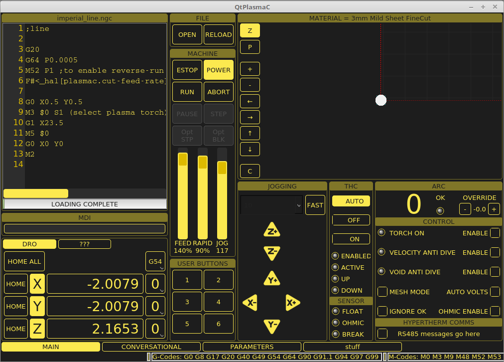

09 Oct 2020 02:09 - 09 Oct 2020 02:16 #185435
by phillc54
Replied by phillc54 on topic QRadioButtons in preferences file
Here you go...
It is a zip file of the complete working config. A bit lazy I know but it is the easiest way for me to keep everything in one place. The Qtvcp file are all in the qtplasmac subdirectory if you want to break them out.
I think I squeezed all I can into 1024x768 but it is resizable.
I actually started this as an experiment with a copy of QtDragon so you will see there is a lot of extraneous stuff in the handler that we don't need for plasma that I will remove. I thought about starting a fresh handler file but I have too much time invested in this now to not warrant that.
Last edit: 09 Oct 2020 02:16 by phillc54.
- Posts: 7368
- Thank you received: 2181
09 Oct 2020 03:10 #185439
Replied by cmorley on topic QRadioButtons in preferences file
It amazes me how quickly you can get up to speed with others code and create some great stuff!
I added a pic so others can get a glimpse - hope you don't mind.
