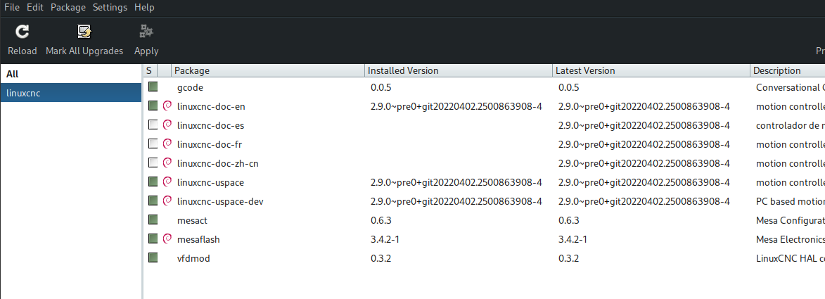

Chris.
well. let's see.
I downloaded the current source from github.
did diff on both files as compared to mine.
1st command: diff mods__simple_widgets.py src__simple_widgets.py > diff__simple_widgets.py.txt
2nd command: diff mods__hole_circle.py src__hole_circle.py > diff__hole_circle.py.txt
the diff files are attached.
I also check on an update via synaptic. see the image attached. no updates available. ??
well. let's see.

03 Sep 2022 14:54 #251130
Replied by cmorley on topic QtDragon, Linuxcnc 2.9pre, and Debian 12 (bookworm)
The file you have installed are not current it seems. I don't recognize the version number.
I think I have figured out hole_circle from your changes.

- Posts: 7368
- Thank you received: 2181
03 Sep 2022 15:15 #251133
It is possible to copy over the files but they are so different that there are probably other files that need to change too. You are playing with fire there.
When you look at the diff file for simple_widgets, did you notice it had way more changes then you did? If you only did a few things, that is what I need to see.
It has been reported that the buildbot as very slow now - like 12 hours a build a package.
If that is true, then it's not surprising if things are behind.
We are in a great state of flux behind the scenes with doc/buildbot infrastructure updates.
Chris

- Posts: 7368
03 Sep 2022 15:21 #251134
looks like your code is from before aug 26th
