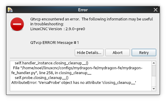

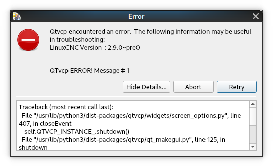

14 Sep 2022 13:24 #251918
by Roguish
Replied by Roguish on topic QtDragon, Linuxcnc 2.9pre, and Debian 12 (bookworm)
Chris,
well, error on exit of qtdragon.
see the image attached.
more of nuisance than a problem, I think.

14 Sep 2022 19:57 #251960
Replied by cmorley on topic QtDragon, Linuxcnc 2.9pre, and Debian 12 (bookworm)
Looks like your screen code and qtdragon's has diverged... the line that errored is not in the latest code.

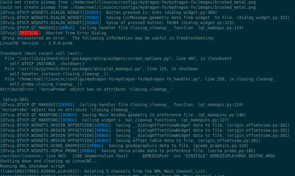

- Posts: 7368
- Thank you received: 2181
14 Sep 2022 20:47 - 14 Sep 2022 20:48 #251965
in the handler file: line 258 'self.probe.closing_cleanup__()
There is no such function in versa probe

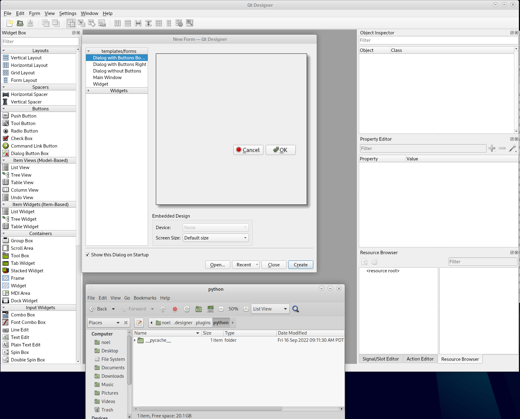

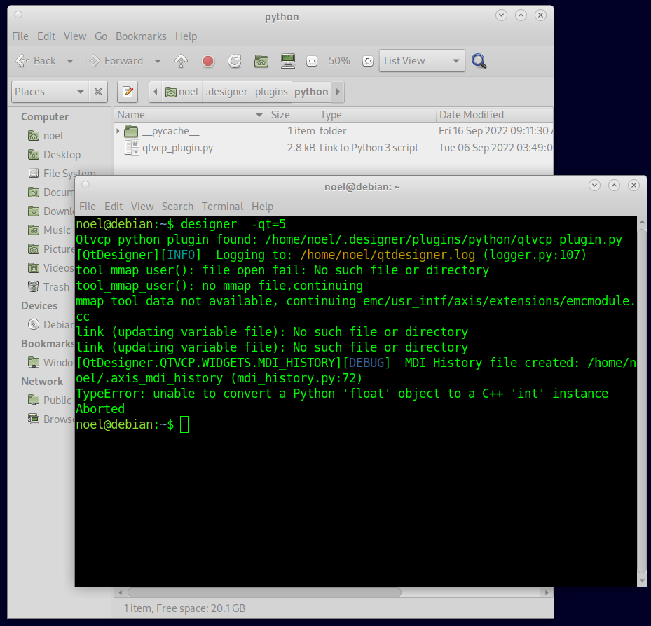

16 Sep 2022 11:20 #252084
by Roguish
Chris,
qtvcp_plugins.py definitely has problems....
my new debian 12 VM with 2.9pre proves it. see the images.
one image shows starting qtdesigner without the link to qtvcp_plugins.py. designer works....
the other image show starting qtdesigner with the link to qtvcp_plugins.py. designer fails, with that error of float to int
please fix this....
I can definitely help with testing.. let me know.
It needs to get resolved, sooner or later. sooner far better than later.
please fix this....

16 Sep 2022 12:19 #252091
Yes. Open qtvcp_plugins and comment out each line until you isolate the particular file. I would guess the files we already played with will be the problem.

17 Sep 2022 02:26 #252143
by phillc54
Replied by phillc54 on topic QtDragon, Linuxcnc 2.9pre, and Debian 12 (bookworm)
It does load after changing line 12 in /lib/python/qtvcp/widgets/round_gauge.py from:
self._threshold = 0.0
to:
self._threshold = 0
I don't know what the repercussions are though...
