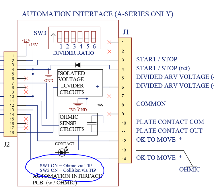

This is not true, you can do tip sensing as well. Take a look at example thermal dynamics A-series manual, they provide tip sensing :Finally, ohmic sensing will only work if the torch tip is shielded. You can't do it if the tip is exposed.

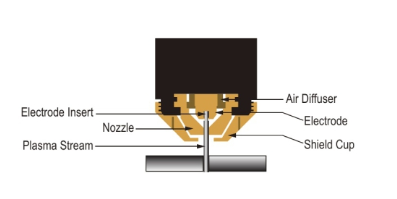

So about the tip, hypertherm has a nice video about HF ignition HF Ignition , blow back would be the same just without the HF, its the moving start mechanism that creates the spark. So Rod made a small mistake in the start sequence, there is a separate current path from the tip back to the plasma (see the hypertherm video). You do not want to have the tip at work potential (see below).
Having the tip connected to work would sound really strange, you would want to avoid that at all cost. If the tip is in the same potential as work, its almost guaranteed to double arc, meaning you cut the tip instead of the material. Current will try to find the shortest path to travel, now look at the orifice of the tip and imagine the plasma arc going through it, then compare that to your cut height. If the tip would be at work potential its very likely that the arc would start to cut to the tip instead of the plate.
I assume what you refer as tip is not a tip/nozzle?
I found a random picture from some herocut manual that shows the tip/nozzle inside so its not exposed, the exposed part being shield cup. Is this your setup? Can you send a photo or something?

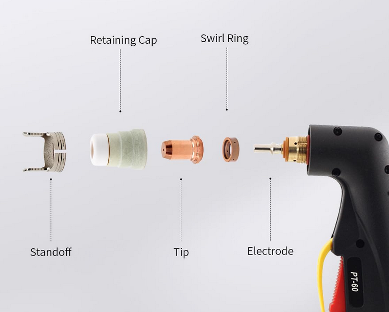

I have a plasma cutter, I attach the ground/work lead to the steel sheet and cut. Simple as that, and everything follows from that. That PE isn't connected to the ground clamp is what I measure.
The Herocut uses a IPT60 or IPTM60 which is the straight one I have on the plasma table. Blowback start.
The electrode and the tip are normally shortened, separated when cutting. Copper tip is electrically connected to the work piece.

It is possible to do ohmic sensing from the tip. At least it is on a Hypertherm 30XP using relay ohmic, I imagine it would work the same with a THCAD. I have been doing this for a few years now without any issues. The only mod to my torch from memory was to insert a diode, the inspiration was from
here
and
here
