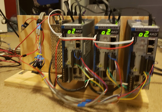

I acquired a Delta Robot with high resolution servo motors and 25:1 gearboxes:
And i have servo drives i have configured for step/direction inputs:
And I plan to mount a laser to the delta and use it for a laser etching machine.

Yes I am, I know this is not ideal, I am sacrificing a lot of the high performance drive loops as well as the 24bit feedbacks on the motors. But since this is my first attempt at anything cnc or linux, I thought this would be a good baby step.
I had pre-emptively bought a 7i92M board as i had planned to run this on a laptop without a parallel port - but i couldn't get the RT latency test to get under 300us (despite it being a pretty high performance laptop it had intermittent spikes i couldn't nail down).
I did stumble on some posts about someone having a branch of LinuxCNC supporting EtherCat - which would be the logical next step since I can configure these servo drives for nearly any industry fieldbus (ECat, CAN, Profinet, EthernetIP, and SynqNet).

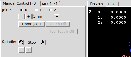

After re-starting LinuxCNC, I noticed that the manual control changed from Axis to Joint:
Next Question:
I notice that when i try to test/jog the axes, I am only jogging the individual joint.
Is there a way to test in machine space instead?
I was hoping to be able to jog in X/Y/Z machine space and make sure the individual servo drives were receiving the correct inverse kinematics values before i connect up the real motors.
I figure once i verify the IK is working correctly, then i can start working out what my home positions need to be. I dont have any home switches or anything. I was thinking i'd just run a homing routine on the servo drives manually, then tell LinuxCNC that it's been homed, but i'm not quite sure how homing will work with the inverse kinematics.
Thanks again guys
-Paul

- Posts: 19902
07 May 2019 05:23 #133046
Replied by andypugh on topic Kinematics and Delta Robot
It ought to switch automatically to cartesian mode after homing.
If not, then the $ keyboard shortcut should do it.

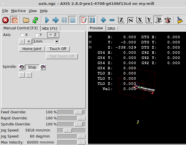

Ok, I homed the axes and ran into an issue where the axes would start outside the bounds I defined for software limits, presumably due to the IK math, but I'm not certain.
I modified the bounds so that Home (0,0,0) is in the center of the workspace instead of the lower corner of the workspace and that problem went away.
Next, I'm noticing my scaling is off, so ignore that in the attached files. I suspect i need to reconfigure the resolution counts to incorporate the gearboxes. It appears the IK math assumes a degree of motion at the "joint" and not the motor shaft. So I think my resolution/motion distance errors makes sense until I rework the scaling.
The only thing I can't seem to track down at the moment is that after homing, the Z Machine Axis starts at -338 mm instead of 0 like X and Y.
Further, it is the only axis I cannot Jog - both X and Y can be jogged, see below:
Did i mess something up in my config?
specifically with jogging, but I'm also puzzled on why it's setting the origin to that -338.029, i guess it could be a result of some IK calculation, but not sure.
HAL/INI attached
I haven't used rotarydeltakins, but -338 sounds pretty much right for the end-effector position when homed, as it is close to the "shin length" of your config.
I suspect that you need to set the Z axis limits to be -338 to -473 (shin + thigh). Don't worry about the absolute positions, your working coordinate system can be centred anywhere you want with G54(etc) offsets.
