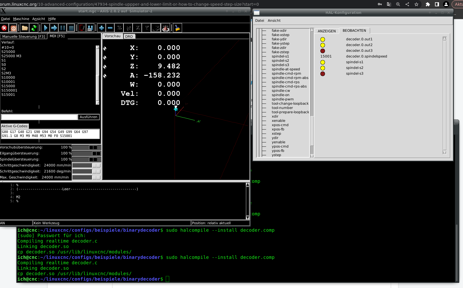

Hi, i would do it with a short custom comp or pure hardware digital rotary switch.
I made short working example. Ready to use...
Last edit: 21 Jan 2023 16:50 by chris@cnc.
The following user(s) said Thank You: Askjerry

21 Jan 2023 18:27 #262596
by Askjerry
Replied by Askjerry on topic Spindle Uppper and Lower Limit (Or, how to change speed step size)
This is exactly it... now I just need to learn how to implement it...
This part I understand... perfect... I can install it in the LAGUNA.HAL or in the CUSTOM.HAL comfortable with that...
What I do not understand is what to do with this code...
Where does it go and/or how do I use it? It looks like C, I get that... but what IDE are you using? What do I need to load?
I'm excited, because if I can learn this... I can probably figure out how to change a bunch of things. I do not need an external encoder... One of my thoughts was to make a pyVCP panel with buttons like...
[ 10K ]
[ 15K ]
[ 20K ]
[ 25K ]
That I know how to do...
looking at your code: // seems to be a REM statement as does the /* something /* part. The rest makes sense too.
So how do I compile it and get it into AXIS? I see the loadrt command... so I guess I need...
1) How do I compile the code?
2) Where does the compiled code need to go? (My LAGUNA folder? A system folder?)
Thanks in advance!
Jerry

- JPL
- Posts: 337
- Thank you received: 118
21 Jan 2023 19:38 #262602
by JPL
Replied by JPL on topic Spindle Uppper and Lower Limit (Or, how to change speed step size)
Those 2 lines after "Compile:" are the instruction how to compile and install the component:
//Compile :
//halcompile --compile decoder.comp
//sudo halcompile --install decoder.comp
So... to compile and install the component just type:
More info here: linuxcnc.org/docs/html/man/man1/halcompile.1.html
//Compile :

Yes, it is a "C" program and need to compile. After compile and install, you have a working hal component.
I should copy in linuxcnc hal modul folder. Just load now in your custom.hal
Everything after "//" is comment. I think It's helpful to note how to compile and function of this.
You need the linuxcnc-uspace-dev package for halcompile
If halcompile not working, post your error. Maybe there is something lost by copy and paste.
