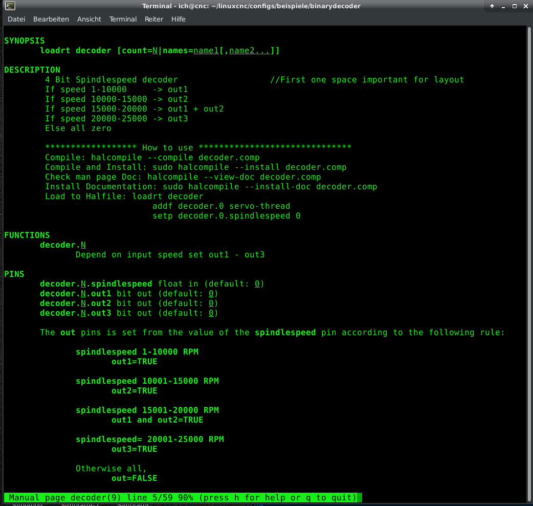

22 Jan 2023 12:09 - 22 Jan 2023 12:18 #262652
by chris@cnc
Replied by chris@cnc on topic Spindle Uppper and Lower Limit (Or, how to change speed step size)
I clean up the mess of comment lines here a clean example
Warning: Spoiler!
component decoder "4 Bit Spindlespeed decoder";
description
4 Bit Spindlespeed decoder //First one space important for layout
If speed 1-10000 -> out1
If speed 10000-15000 -> out2
If speed 15000-20000 -> out1 + out2
If speed 20000-25000 -> out3
Else all zero
****************** How to install ******************************
Compile: halcompile --compile decoder.comp
Compile and Install: sudo halcompile --install decoder.comp
Check man page: halcompile --view-doc decoder.comp
Install man page: sudo halcompile --install-doc decoder.comp
Load to Halfile: loadrt decoder
addf decoder.0 servo-thread
setp decoder.0.spindlespeed 0
// Input pins
pin in float spindlespeed=0; //speed float in
// Output pins
pin out bit out1=0;
pin out bit out2=0;
pin out bit out3=0 """
.P
The \\fBout\\fR pins is set from the value of the \\fBspindlespeed\\fR pin according to the following rule:
.RS
.TP // Add empty line
\\fBspindlespeed 1-10000 RPM\\fB
\\fBout1=TRUE\\fR
.TP
\\fBspindlespeed 10001-15000 RPM\\fB
\\fBout2=TRUE\\fR
.TP
\\fBspindlespeed 15001-20000 RPM\\fB
\\fBout1 and \\fBout2=TRUE\\fR
.TP
\\fBspindlespeed= 20001-25000 RPM\\fB
\\fBout3=TRUE\\fR
.TP
Otherwise all,
\\fBout=FALSE\\fR
.RE"""
// Global variables
//variable float timer=0;
//function _;
function _ nofp "Depend on input speed set out1 - out3 ";
[/spoiler]
Man Page looks good
Last edit: 22 Jan 2023 12:18 by chris@cnc.
- Askjerry
- Posts: 239
- Thank you received: 31
22 Jan 2023 14:40 #262661
by Askjerry
Replied by Askjerry on topic Spindle Uppper and Lower Limit (Or, how to change speed step size)
The problem is upon powering the PC on, that pin also comes up high and then goes low... so the spindle suddenly starts up and as the other pins are low it gets the bit pattern 0,0,0 which is 40,000 RPM and it really screams.
This way, there will NEVER be a situation where they are in the needed relay1=on and relay2=off. It powers up as off/off and when AXIS starts they jump to on/on. It's crazy, but it is now VERY stable... and I have no need to use paraport-14 on the first board anyway.
So the document page makes a local document that can be viewed if the user needs to remember how to use the function? I will give it a try on what I have and see what it looks like... then evaluate what you did (The .P .RS .TP and .RS to see what they do so I understand them better.)
Where is the manual for this version of C? I need to study and experiment with it for future projects and enhancements. And I noticed after upgrading the garage computer... it produces a somefile.ko while inside the house, that computer produces a somefile.so which are both placed into different folders too. Odd... must have something to do with the Linux version used. In either case... they work properly, and I now have this as a reference to compile future works.
But I do need a link to the manual so I can see what else is possible.
Thanks,
Jerry
Thanks,
Jerry
