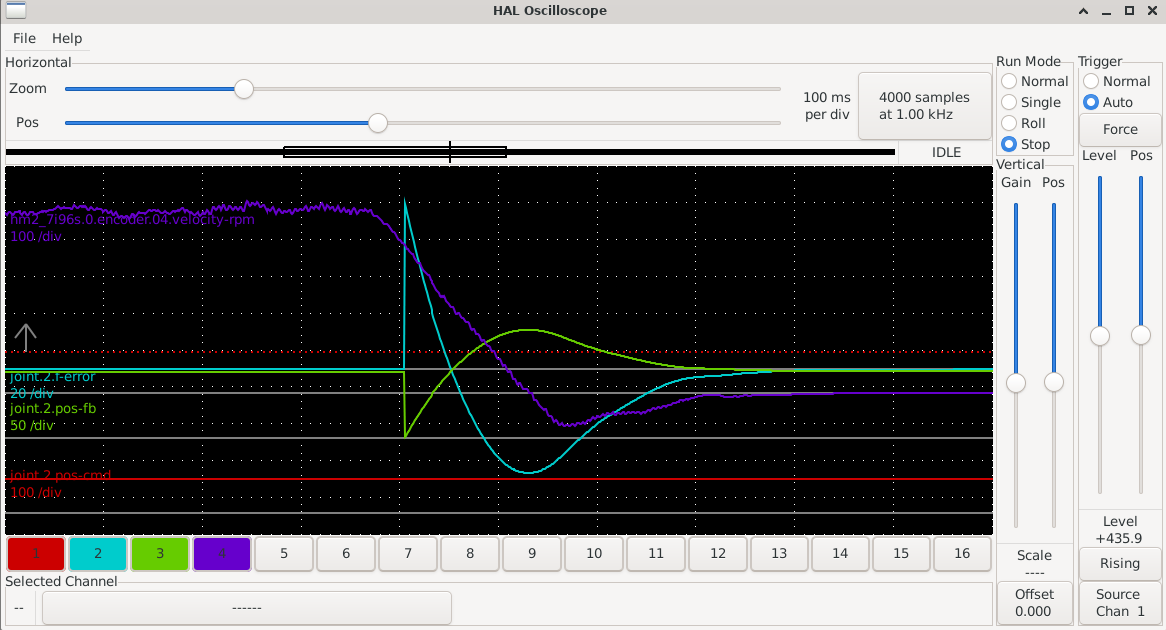

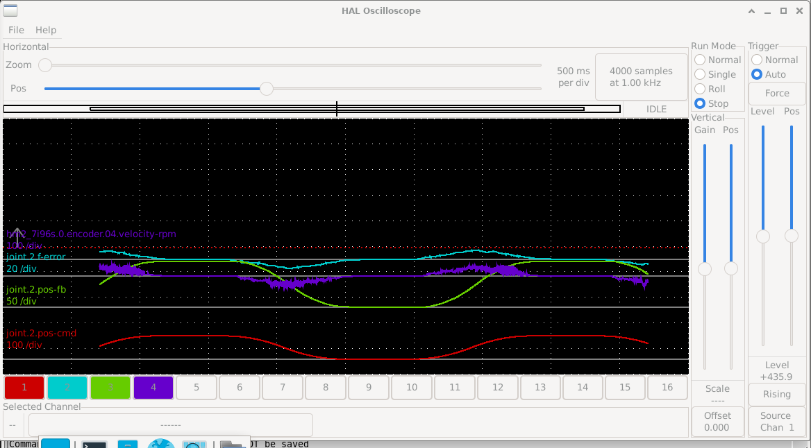

07 Jan 2024 23:07 #290179 by spumco
Replied by spumco on topic caxis.comp - problems
I don't know if this will be useful, but I've got two halscope captures
First is running the spindle at 500rpm and stopping it.  Capture is of the auto-repositioning move to C0 at M5.
Second is a back and forth G0 C0 to C90.  No settings changed.
halscope is zoomed out on the second one, but that's the only difference.
No idea why the moves are so diferent.
08 Jan 2024 04:45 #290199 by Aciera
Replied by Aciera on topic caxis.comp - problems
Notice how pos-cmd in the first capture remains constant while it changes in the second.
I have no idea really but it looks like two different modes of the custom component, maybe?
