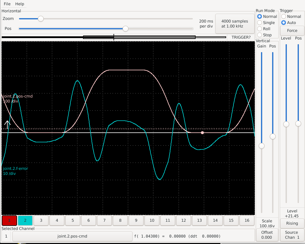

Finally getting somewhere.
I think there is an error in the LCNC manual.
Under INI [AXIS] and [JOINT], the following:[/code][/code]
So naturally I set my MAX_VELOCITY appropriately: 720 degrees per second (for 2 revs/sec). Same for the [TRAJ] and [DISPLAY] sections.
After pulling my hair out for a couple days trying to figure out why the C-axis was moving so slowly... I took a gamble tonight and bumped all the values way up.
It appears that LCNC is calculating angular axes based on machine units per MINUTE, not second. MAX_VELOCITY = 7200 started working as expected.
Same issue with homing speed - LCNC is calculating on units per minute, not second for angular axes.
Adjusted MAX_ACCEL appropriately, and now it's whipping around like a champ and I can get to PID tuning.
Moving forward...it's got quite a bit of overshoot and undershoot, and I'm not sure where to go from here. Not seriously unstable... just springy.
Based on these settings:
P = 0.04
I = 0
D = 0
FF0 = 0
FF1 = 0.015
FF2 = 0.015
FF3 = 0.005
maxoutput = 0
deadband = 0.2
Raising P causes it to go unstable.
I've got a scope that looks like below. Any suggestions on how to tighten it up?
[/code]
[code][code]MAX_VELOCITY = 1.2 - Maximum velocity for this joint in machine units per second.So naturally I set my MAX_VELOCITY appropriately: 720 degrees per second (for 2 revs/sec). Same for the [TRAJ] and [DISPLAY] sections.
P = 0.04
I = 0
D = 0
FF0 = 0
FF1 = 0.015
FF2 = 0.015
FF3 = 0.005
maxoutput = 0
deadband = 0.2

Now I'm less certain there's an error in the LCNC manual, and am suspecting there's an error between the manual and my keyboard.
For those of you silently following along it just occurred to me that I may have made a really dumb mistake.
The spindle/c-axis stepgen position-scale is 12110, and that's set in the INI [SPINDLE] section. Feedback is 2400 pulses per rev (soon to be 40k after the new encoder is wired up).
But that's 12110 pulses per revolution. And the C-axis units are in degrees.
So I'm flipping back and forth between two PID loops...Both use the same input (2400), but the outputs need to be calculated for two different units.
But LCNC isn't doing that, because I haven't told it to scale the C-axis output for degrees. No wonder it's reacting wonky.
I feel like the IT Helpdesk person has just asked me to check if the computer is plugged in... And I stifle my sense of outrage and look down to see it's unplugged.
To be continued...

15 Jan 2024 19:13 #290782
by spumco
Replied by spumco on topic caxis.comp - problems
If it helps, the move above is a G0C360 -> G4P0.25 -> G0C0 repeat loop.

16 Jan 2024 17:14 #290882
by spumco
On a happy note... there was a breakthrough late last night and everything seems to be working rather nicely. I'll post some details later.
Kind of you, but the reality is that I have no linux skills. I substitute bloody-minded persistence for actual knowledge.hello, I check regularly to see your progress, I'd like to help you, but unfortunately I don't have your linux skills, I admire your work.
