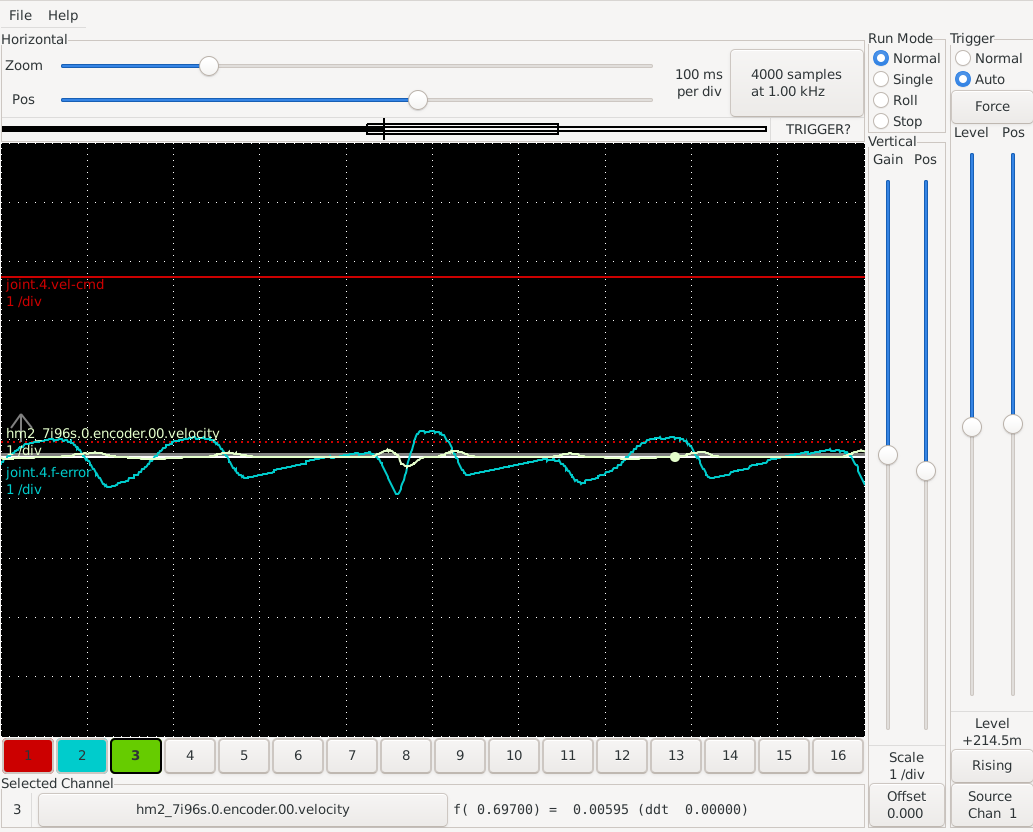

Subspindle is set up and working badly. The second caxis.comp is doing it's thing, but as usual my PID-fu is weak.
Spindle mode it works fine. RPM is as-commanded running open loop.
Problem is in axis mode. I'm pretty sure I've got some scaling issue, or I've connected the wrong feedback pin somewhere (RPM vs RPS).
To recap the setup:
P - 1
I - 0
D - 0.01
FF0 - 0
FF1 - 0.025(?)
FF2 - 0
FF3 - 0
max_output - 0
deadband - 0.1
Any higher P and it wags back and forth until ferror. No D and it runs away until ferror. The strange FF1 tells me I have something wrong somewhere.
If I can get it to home and settle down, any commanded moves (G0 W180) take forever. The motor jumps a few degrees at normal speed, then creeps along with a pid.w.output at about 0.1rpm... oscillating the whole time. Takes 10-15 seconds to get close to finishing the move, then another 15 seconds to settle down. It does eventually stop without hunting.
The following error isn't super-high, compared to the wild behavior before I found the above settings, but somthing is causing the output speed to be silly.
I don't think any of the other INI values/settings are clamping the speed - everything is set pretty high.
So... what have I got wrong that would cause FF1 to need to be set like it is? Halscope attached, even though its silly.
To recap the setup:
- Step-dir command, stepgen is in velocity mode
- Feedback is from the drive; 2500 lines, 10k post-quad to 7i85s.
- Steps per rev is 5000
P - 1
I - 0
D - 0.01
FF0 - 0
FF1 - 0.025(?)
FF2 - 0
FF3 - 0
max_output - 0
deadband - 0.1

As i said, the problem is trying to be 2 different things. I'm looking at it
