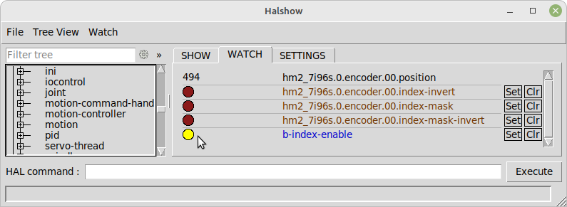

OK so it looks like the hardware works.
When testing you should have a halshow WATCH tab setup like this:
When you set b-index-enable true (yellow) with the "Set" button, it
should go false (red) when you move the encoder past the index position.

My button never change when color , is always RED . same when i click on "set"

Can you post you current hal file?
This really makes no sense.
It sounds like either some basic error in the hal file or a
continuously changing index signal
Also: Is the encoder position cleared to 0 when you set b-index-enable?

setp [HMOT](CARD0).encoder.00.index-enable true
This is wrong and should be removed
(set in the halshow:watch tab)

so I tested it and switched the red button to yellow. and it turned red at the same position when I turned my encoder.

OK that means that index is working as expected, so if homing
to index fails, its likely a homing setup issue.
