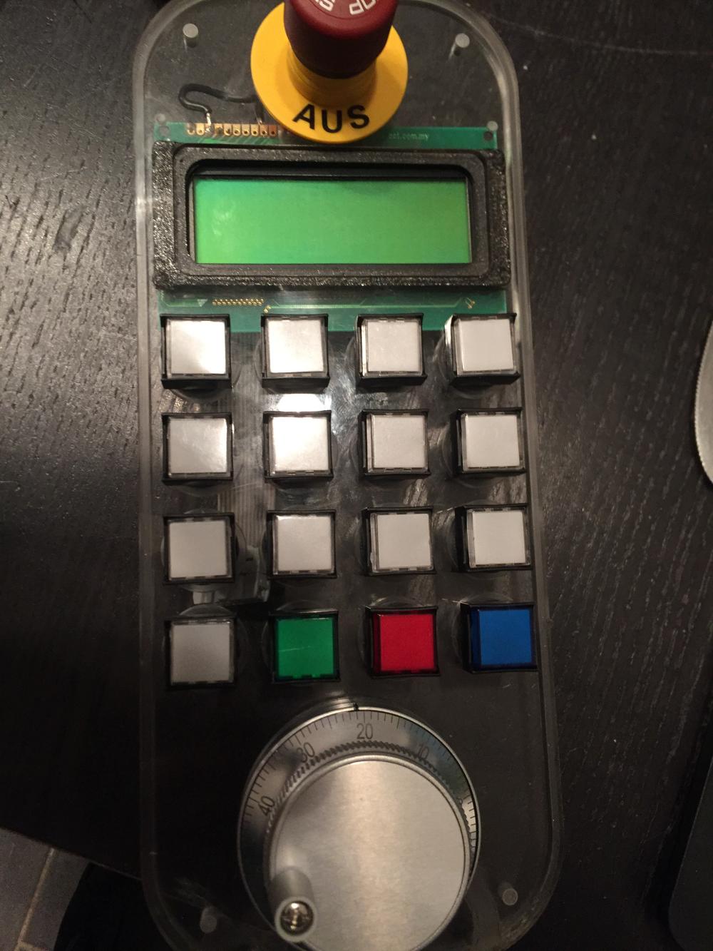

Slow down guys. Everyone got so excited about Hanno's new turntable, that we missed the 800lb gorilla dancing in the background!. Hanno doesn't get to to post a photo of a home made pendant without explanation or comment :)
Is this made using Peter (Talla83 ) circuit board?
By the way, Peter also designed a cute little 2 port expander for the MESA system. Sort of a 7i74 lite.
He generously posted the Gerber files to Github:
github.com/talla83/RS422-SmartSerial-Adapter
What is it like to watch the videos with Youtubes translated subtitles?
I followed his recommendation to use JLCPCB to have the boards made. $2 for five boards, including postage! The components are another €20 or so. I have a 7i96 inbound for a lathe project, and will use one of Peters boards to interface a 7i73.

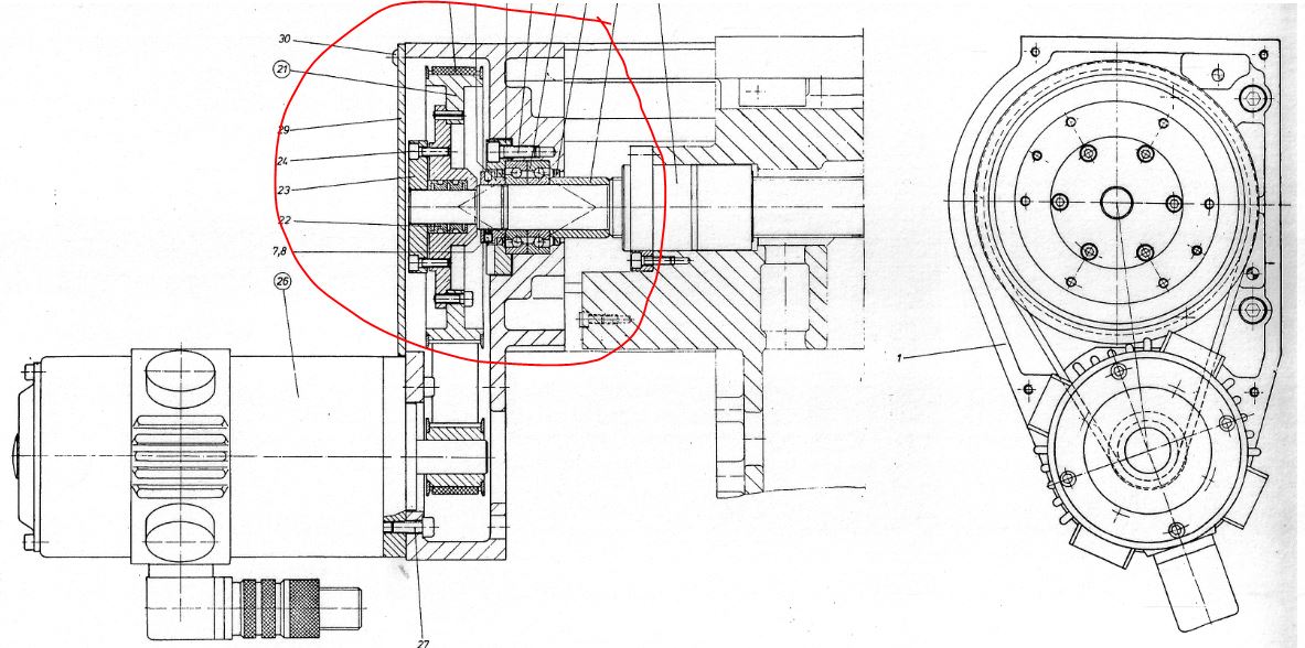

I agree with that. I still haven't seen any details on the internet on how to remove a Maho ball screw pulley. I know there is some sort of expanding collet which holds them, and there is a trick to removing them, but am not sure what the trick is.
Is it a taperlock by any chance?
www.bearingboys.co.uk/5M-Taperlock-Timin...iming-Pulley-21464-p
If so, then there are two screws and half-threaded holes in the pulley. Tightening the screws pushes the bush in to the taper and locks the shaft.
To remove it you take out the screws and put one of them in the other slot, which is half-threaded in the bush. Then tightening the screw pulls the bush out.
Or perhaps it is:
www.fennerdrives.com/trantorque/
Or maybe something altogether more Germanic?

I think it is something they came up with themselves.
Might be as easy as loosening the 6 cap screws on the4 hub cover plate, but I read somewhere there is more too it than that.
Mark
15 Jan 2020 12:07 #154910 by andypugh
Replied by andypugh on topic Retrofitting a 1986 Maho MH400E
There doesn't look to be anything else that you _can_ do other than unbolt the hub plate.
But I can imagine those grip rings might not want to release. There looks to be no chance of pushing the pulley in further to loosen them, either.

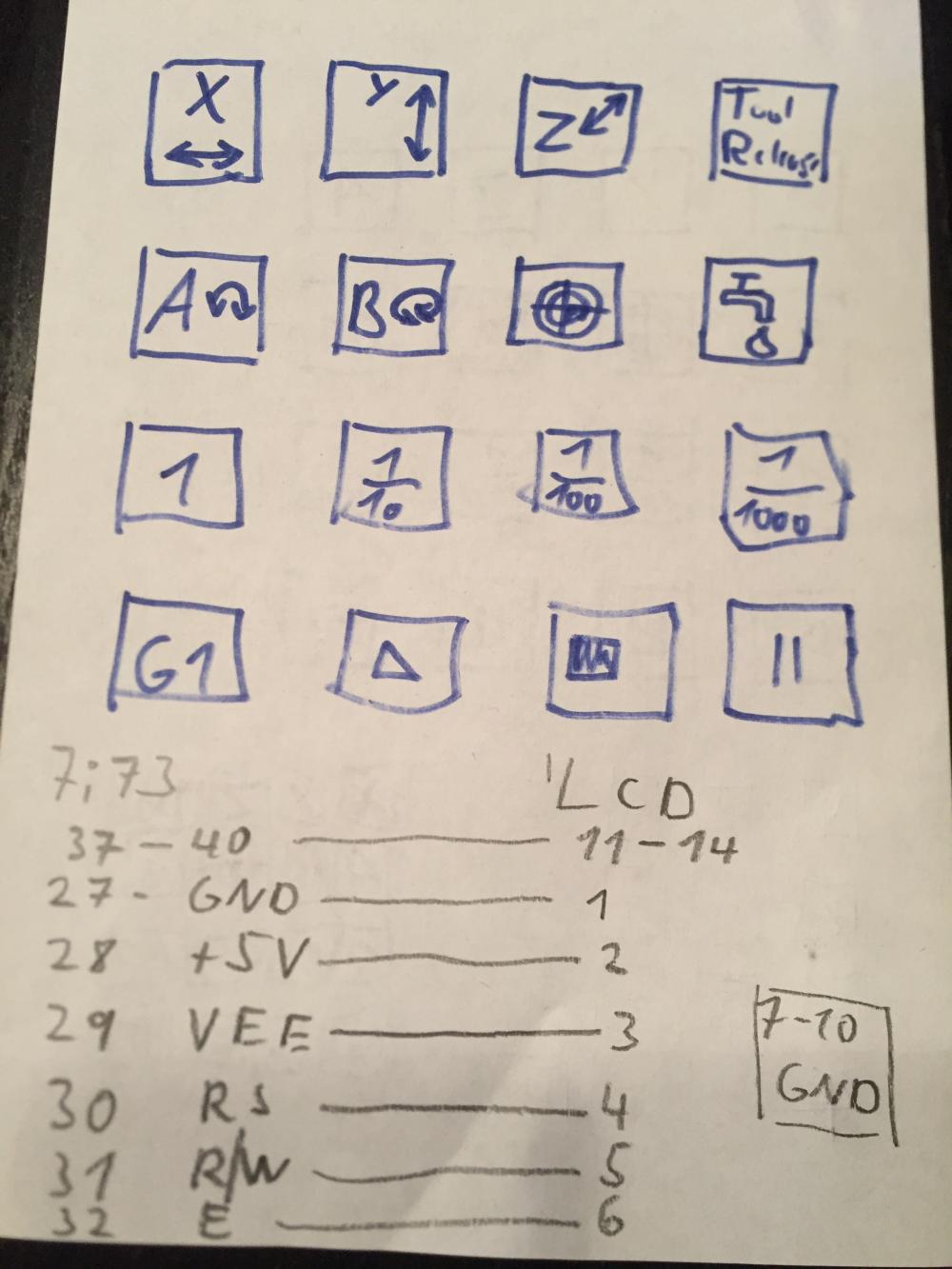

My pendant will use the Mesa 7i73. Yes, It looks similar to Toms SImple Handwheel but doesn't use Peter's PCB.
I wanted buttons for my 4th and a later 5th Axis, tool-release and coolant and therefore would be too "small".
See my scribble:

My 600E uses SPETH clamping sleeves type DS but noted that "Spieth" has a Type AK / IK an AL / IL clamping sleeve that may be what was used in your 400. Have read that the DS type can only be used one time which seemed strange to me. I removed a Speith DS clamped pulley from a servo motor, an just loosening the allen bolts didn't cause the clamp to relax enough . Had to lightly tap on the pulley before it released. Next time I will try to spray cool the clamp -warm the pulley .
