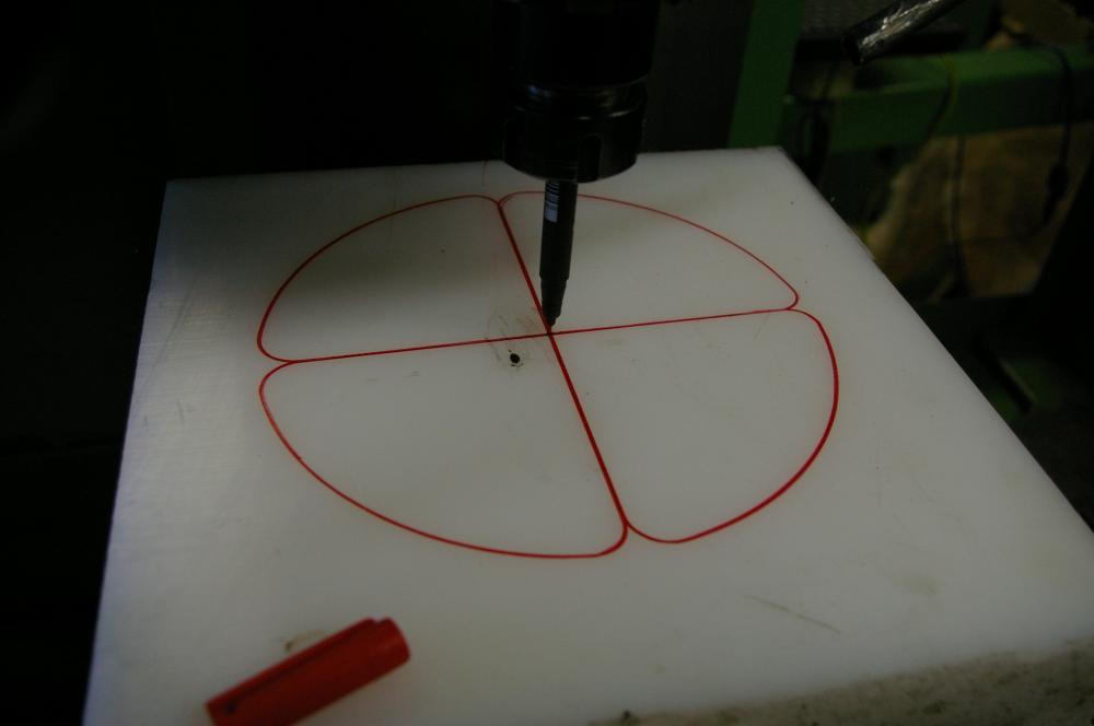

I ran Mark's clover-leaf code and I'm glad to see no drift after 1 hour (4 passes):
@Mark: How is the change to the new 602-EXE going ?

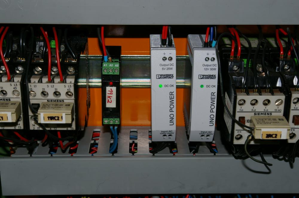

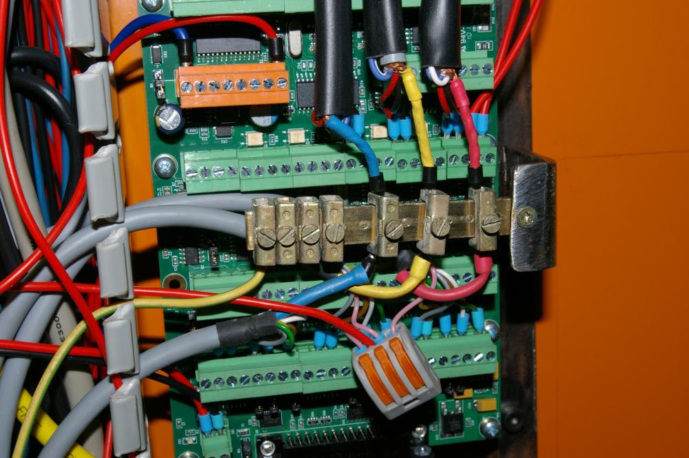

You want to see pictures of the progress ?
Here they are.
The wiring is almost complete.
Made a ground rail where I will mount an additional piece of sheet-metal against EMI over both MESA-cards when the 4th axis is wired up.
Almost everything nice and clean.
I "organized" two DIN PSUs with 1% voltage tolerance.
The difference to the ATX-PSU is only..... it looks better:
Here they are.
The following user(s) said Thank You: Glemigobles

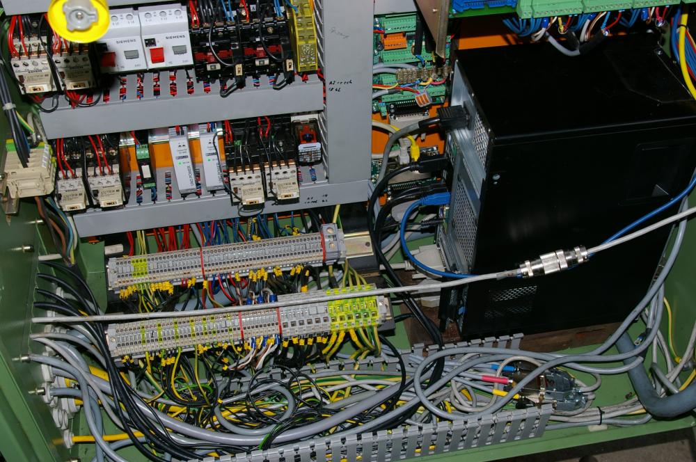

Hi Hanmon,
Great to see your progress on the machine! I love how you managed to fit that sawn-off chassis in place of the original computer. I also want to repurpose my old desktop PC for the retrofit, even if it seems a bit wasteful (an i7 processor seems like overkill for the low speeds of the Maho); it seems like a move that ensures high quality components with long operating life where it really matters. It's already a PITA to troubleshoot a PC when something goes wrong, it would be even worse when the computer is a part of a complex assembly.
Mark, reading about your EXE problem it's even more impressive that you managed to do that retrofit! Thinking about it, your machine didn't work to begin with but you replaced the computer, interfaced everything and now you're successfully troubleshooting problems with faulty hardware. Your background as an aircraft service engineer must really be helpful to keep a cool head and proceed to methodically test everything. This shows especially in how you measured the axis drift. I guess that particular problem also helps to explain some of the problems you've had with machining in this thread. It would easily ruin my work to have that happen.

03 Feb 2019 15:44 #125583
by hanmon
Replied by hanmon on topic Retrofitting a 1986 Maho MH400E
concerning the position of the PC I would do it differently.
In my kiosk-control-panel there is a lot of unused space and there actually was a pc in the back. I now had to draw 5 cables through the conduit. 2xUSB, DisplayPort, Serial4pendant and 3,5mm Audio. If you use/place the PC inside the control housing you'd only have to draw the 2 D-SUB cables when using the 7i74, in Mark's case only one D-SUB.
Beside the logical separation, I think this would be much better due to EMI.

- J Green
- Posts: 164
- Thank you received: 24
03 Feb 2019 16:38 #125584
by J Green
Replied by J Green on topic Retrofitting a 1986 Maho MH400E
Hanmon
That wiring looks as if you prefer to do it correctly the first time, verses poking around later trying to find what wire isn't making contact. Good job, and thanks for the photos.
Question
Just below the ground rail is a red wire and three small pink wires going into some type of block having three orange stripes on the outside. What is that --- a wire junction block?
