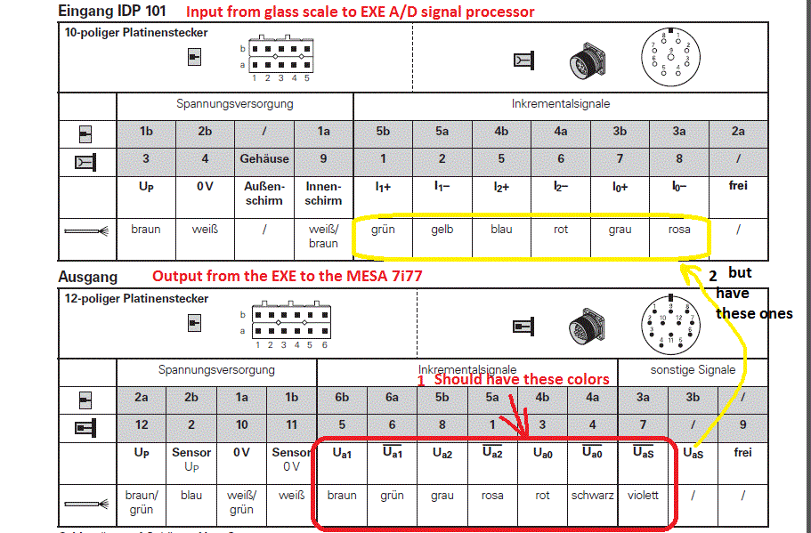

Next setback ist that the glas scales are not working. I guess the color code I found for the Heidenhain's where not correct, So I need to do some checking there.

I tried to tackle the encoders today and found something odd, even with the corrected color code i can't get a signal.
then I tires to mesure with a multimeter. and all the signal were high even with no wiring present. is this normal?
thanks Patrick
thanks Patrick
